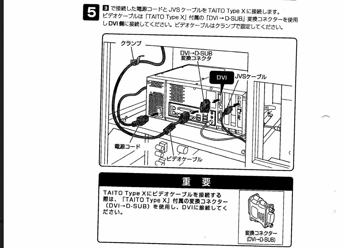

They should be available via analog/VGA connection, but NOT digital.
Remember, Taito expects you to connect X systems via VGA NOT HDMI/DVI.
From the official manual...
DVI-to-VGA adapter, please... Clearly they have no idea what they are f'n doing. ;)

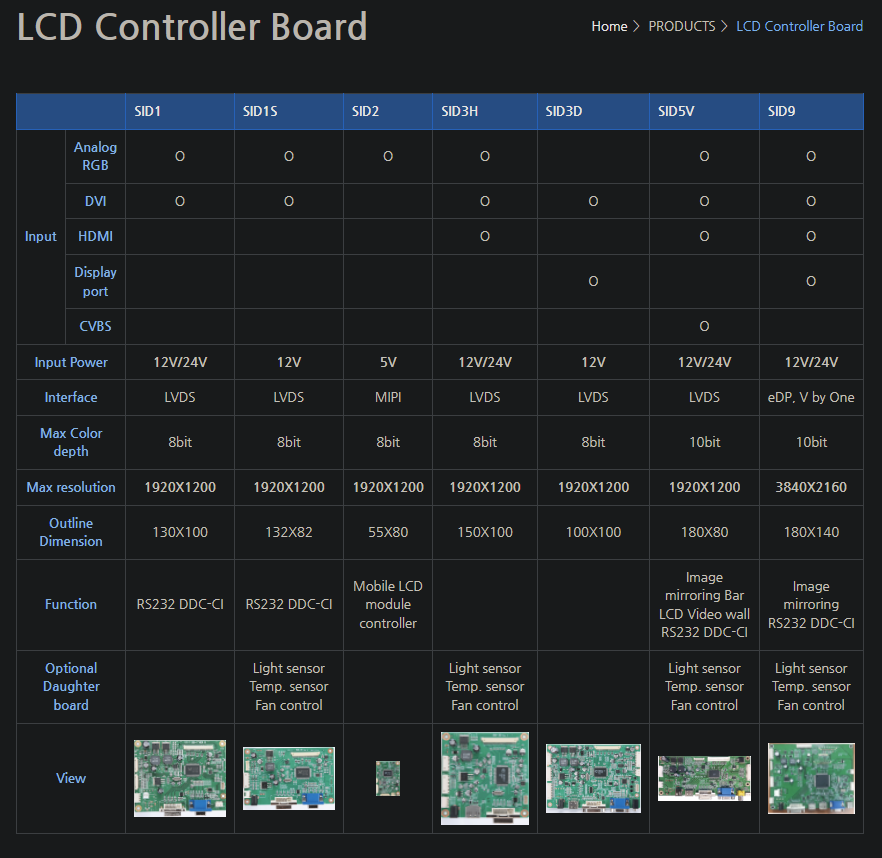

Yes, we know this. That is why I asked anyone with the newer monitors to check what boards theirs has if they care to open it. I want to see if Taito is still using these old boards in their monitors. The one in the DiSign one dates back to an official design date of 2014 or something like that. Not that it would be worth it, but I wish there was an open-source controller for these monitors available. But ultimately I might be going the route of an aftermarket monitor and bracket. Don't get me wrong taitos monitors are of course 100% on point for the systems they are meant to run on.
I use it with exA-Arcadia (HDMI - 1080p) and it looks fantastic. I saw @DragonMinded running a NAOMI inside and the picture was not stretched. I think that Taito started to offer these monitors in 2020, they are clearly one step above the previous ones. It's probably not the same board, as this one has an HDMI port in addition to the DVI and VGA ports. The brand is different too. But who knows...
Yup, thats why I want to see if its the from the same controller manufacturer and its just the other model they have that has DVI, HDMI and VGA.
Here the contoller boards they make, the DiSign monitors have the SID1 so I wonder if these newer monitors have the SID3H
