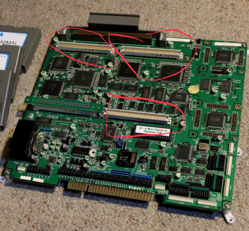

Noob question. What are the 4 big pin headers for? One is covered is most pictures I see. I got a board in the mail. Seller doesn’t know how to package shit so of course it was damaged. Some of the pins are bent on one of those connectors. I’m assuming I don’t need them for anything so might be ok, if the board works.
The pin headers are what you use to select the game you want to play.
The stock setup uses jumpers on those pins to select a title, but @stt1 sells a separate LCD selector that connects to that pin header.
FS: Sega ST-V multicart game selector with LCD screen
Also, @twistedsymphony sells a nice 3D printed case for the LCD selector.
Yeah on the PCb there are 4 big headers. One usually had a little pcb covering it.
They're just expansion headers for optional add-on boards. For instance the print-club games have a video capture board that plugs into all 4 of them. You can see pictures of that here: Metal Cage for STV boards
ST-V was originally designed to support multiple games (like MVS multi-slots) and I believe the game switcher hardware was to use those ports as well. This is just speculation on my part, I've never seen any photos of what the switcher hardware looked like, but you can see the evidence of this in test mode.
On that note everyone please check your ST-V pcbs and let me know if you have the SCSI controller version of the daughterboard. ;)
If you have a big daughterboard that is plugged into all four of the connectors then post some pics and we'll sort it out.
Thanks, but nope, don't have that...

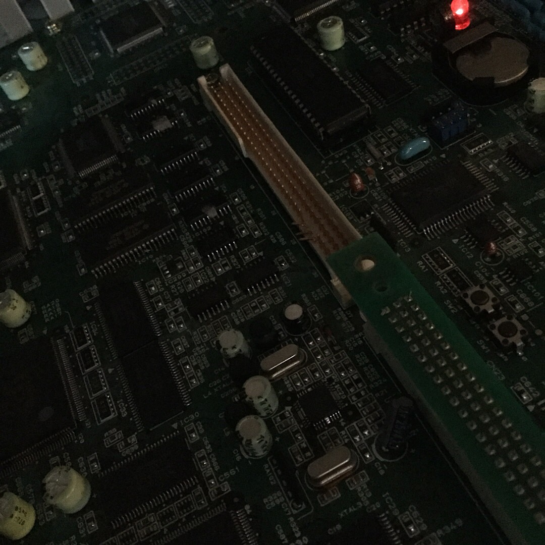

Looks like my board survived. Here is the damaged connector and pins, but this soccer game works.
