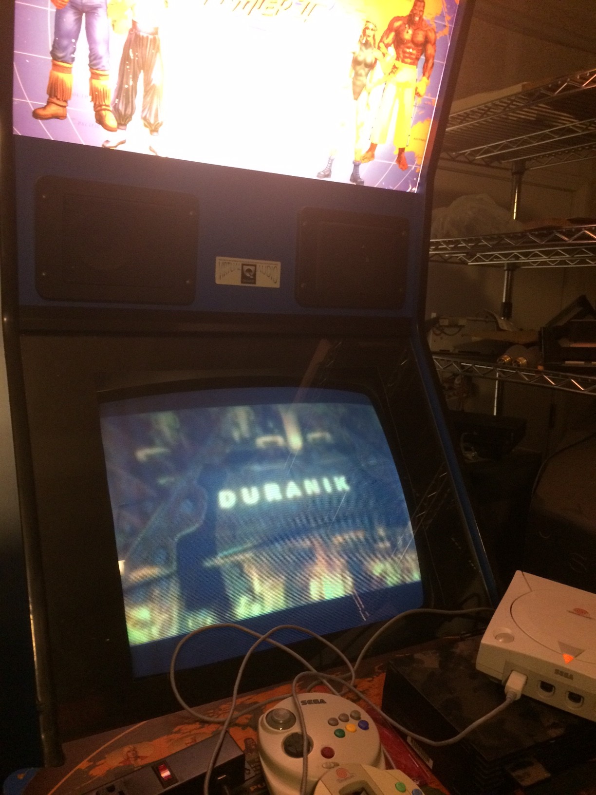

I am in the minority, but I <3 NAOMI + Netbooting! Been messing around with Dreamcast + GDEmu-to-JAMMA as of late too (and yes, a Dreamcast is a viable NAOMI multi alternative). Can't do this on a NAOMI:
I'm with you - the Cyberlead runs the NAOMI perfectly with a netboot setup, I made a power cable to connect the Pi to the NAOMI filter board and it works perfectly for me.
I have a Dreamcast to JAMMA adapter I've forgotten the name of, I will set that up one day. I really want to make up a twin stick control panel using the DC sticks and play VOOT on the cab. From memory the DC sticks won't work on the MAPLE bus
