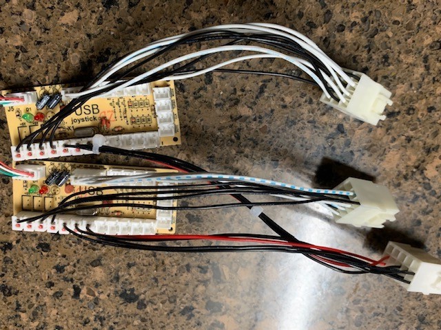

Also, unless you really prefer J-Pac's keyboard emulation, you can probably go with Zero Delay encoders (or some other controller PCB). Rather than buying the JNX CPS2 adapter, terminate the controller PCB's into receptables that the joystick plugs can plug right into under the CP. You can also build a wye so that the controller PCB's can be left in at all times. Here is what I am doing for my buddy's emulation setup for a New Net City. He wants emulation all the time, so no need for a wye:
This is an expensive hobby, so I am always looking for different ways to do things to save some dough. If what is suggested above works, the cost of a J-Pac and the JNX CPS2 adapter is saved. The cost is traded for 2 zero delay encoders at $8 each, plus the plugs and pins needed to wire into the controls of a Blast City (~$5 in total). Also, the overall components and physical footprint is reduced. Let me know what you think.
