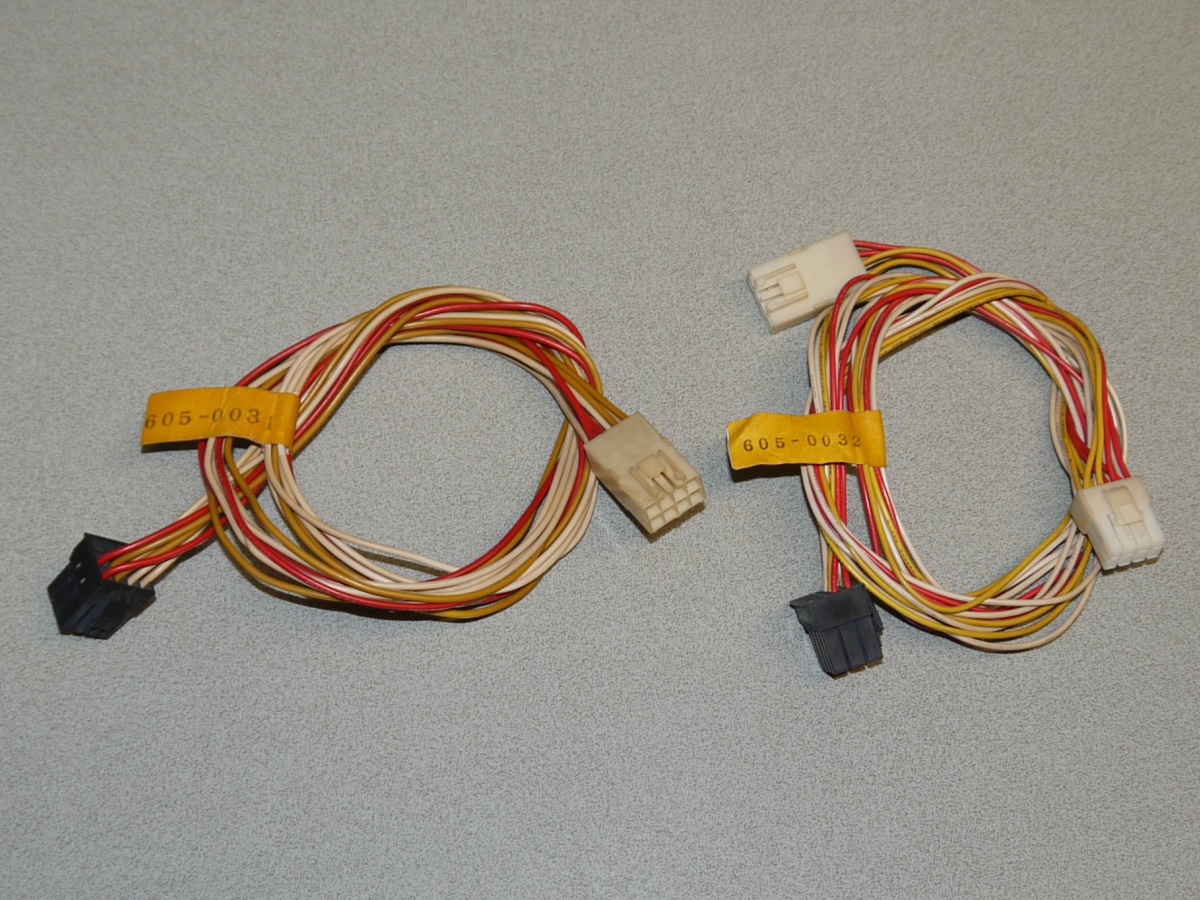

Might as well post this here, so all the cables are catalogued:
These are for powering both link boards and the JVS IO in the slave cabinet. Super easy to make your own if you source the necessary AMP UP connectors and pins.

Mind sharing the pinout? The pictures on the fist post of this thread are no longer available.
Thanks!!
They might not be gone, just hotlink guarded or something. It's late here but if nobody beats me to it I'll grab them assuming I can (looks promising)
Hard to tell from the photos, but I am guessing the 1P split harness for powering the I/O and the link PCB is two wired per pin on the female 8 position AMP UP connector?
I've built all the cables and verified that the second cab i/o is being powered but I am unable to get the monitor to show an image on the slave cabinet. The main AC switch at the back is turned on.
I checked that all connections match up with the manual (black and white 12 pin AMP UP is going to CN7 on both machines. I have the split 8 pin cable (runs to i/o and link board) in the master cabinet and the non-split 8 pin cable (link board to i/o) in the slave cabinet. All VGA/sound connections are going to the correct spots.
