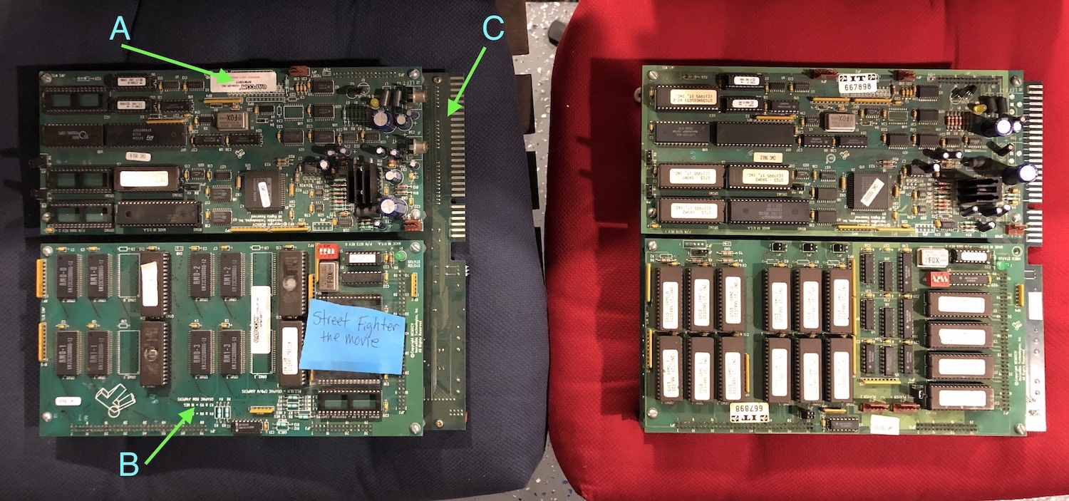

I have a broken SFTM, won't boot, black screen. And a GT3D that works just fine. Comparing my SFTM board to pics of working boards it looks like mine is missing both audio and video roms from each pcb. However when I turn on the SFTM board, the status light on the graphics pcb doesn't illuminate. Does this mean there's a larger problem with the graphics board (or some other component) other than the missing roms?
@West
Well, easiest thing to do is grab 4x 27c020's and burn the program roms for SFTM, toss both of your SFTM boards onto the working GT motherboard and see what happens!
More than likely the prog roms on GT3D are also 27c020's and you can just steal those and rewrite them.
one thing to keep in mind is that there are multiple revisions of the GT3D mobo and sound board. given that they have different GT3D ROMs in MAME for the different board revisions I would suspect that you need to keep to the same revision that SFTM uses.
P/N 1064 REV 1 Mainboard
P/N 1066 REV 2 Sound board
Also according to MAME there seems to be at least 2 versions of the SFTM security PIC (despite them all having the same label), so I would recommend sticking to SFTM program ROMs that match the original revision that your security PIC came with
SFTM 1.10 and 1.11 use one version of the PIC while SFTM 1.12 and 1.14 use a different version
When I did my board swap, I made sure to have the same revision donor boards.
