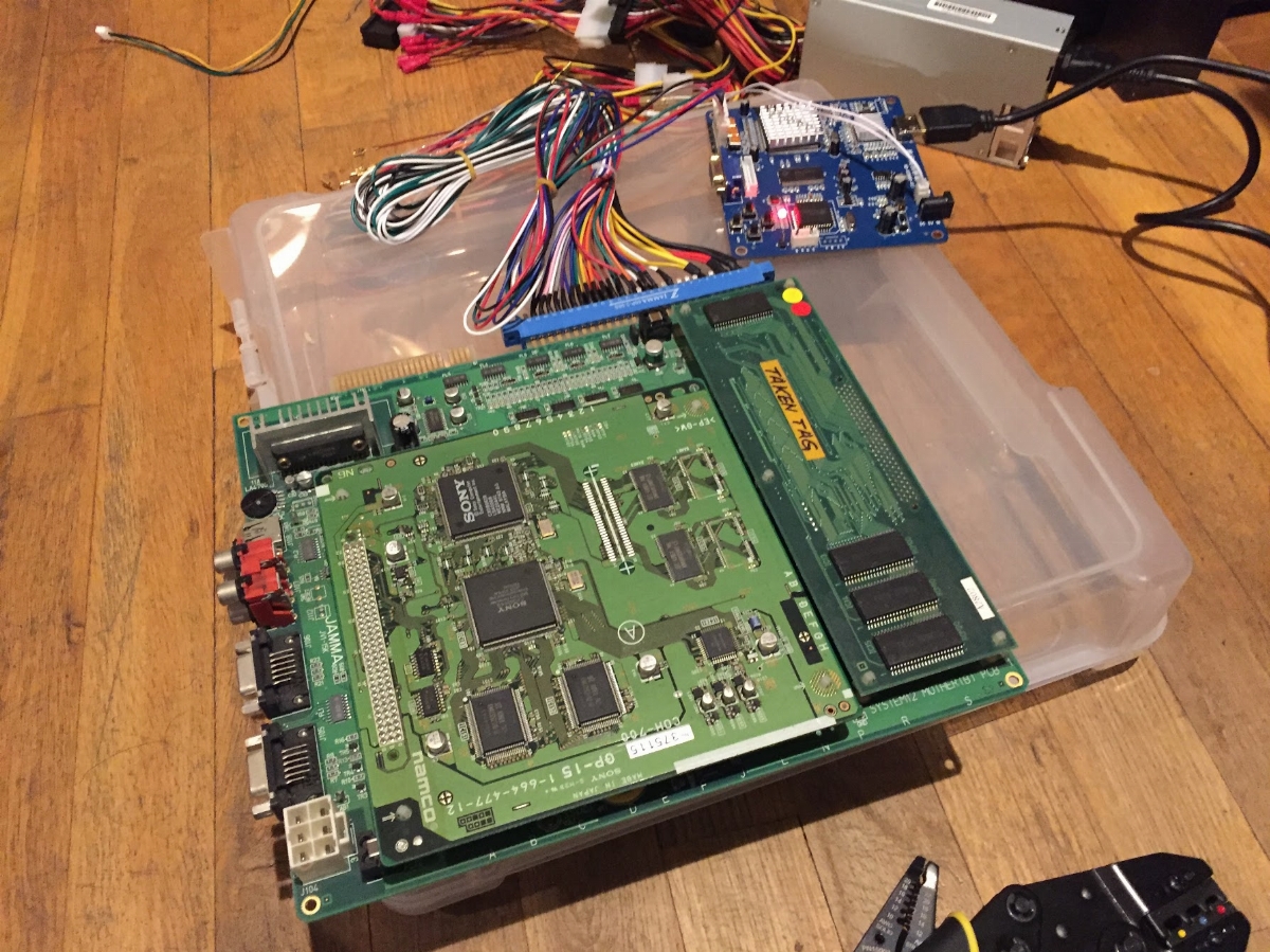

This was shortly after the board came in the mail. Managed to get the game to boot successfully by hacking away at an ATX 24-pin connector. This jamma harness in this pic was off Amazon because I was afraid of doing it myself; I quickly learned it was absolute trash and should've done it myself.

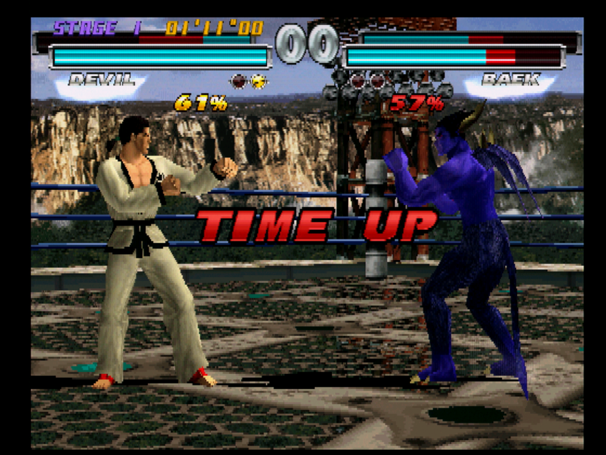

And here's a couple of direct captures. This is coming off the GBS-8200 upscaled to 1280x960:
Coming this close to emulation quality was a shock at first sight. The cost of this hardware helped to REALLY make this project complete. I don't have to rely on a separate upscaler and can actually set it up anywhere.

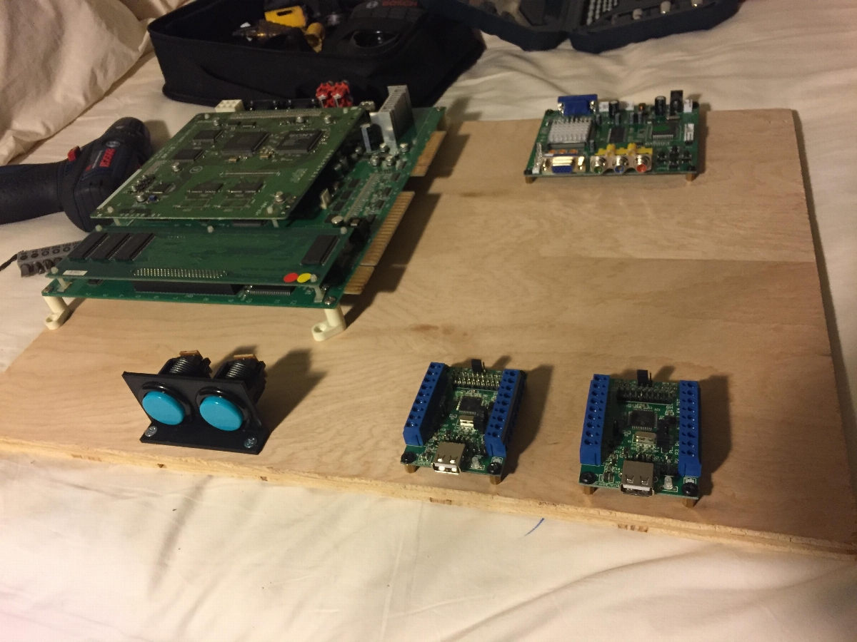

This picture was after a whole bunch of trial and error and had FINALLY gotten this to work. PCBs and wires were littered everywhere:

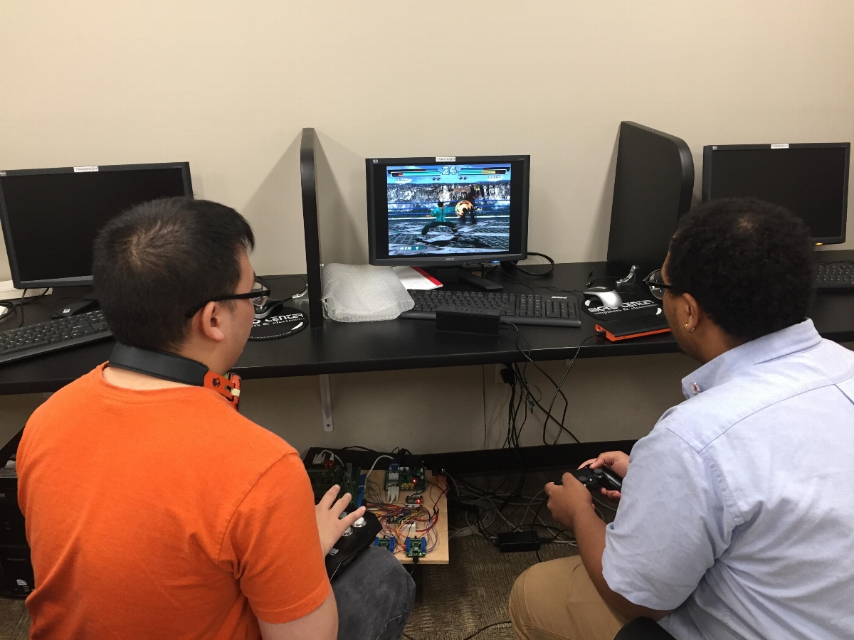

But alas, it worked! I took it to work the next day to completely confuse the crap out of my coworkers. Best part is it became a decent conversation starter. One coworker was an arcade technician in his previous life and was able to understand what I pulled off. But everyone was impressed when they realized it's fully playable. A few guys recognized the game and were eager to try it out.
Here's some pics of them trying it at work after hours:

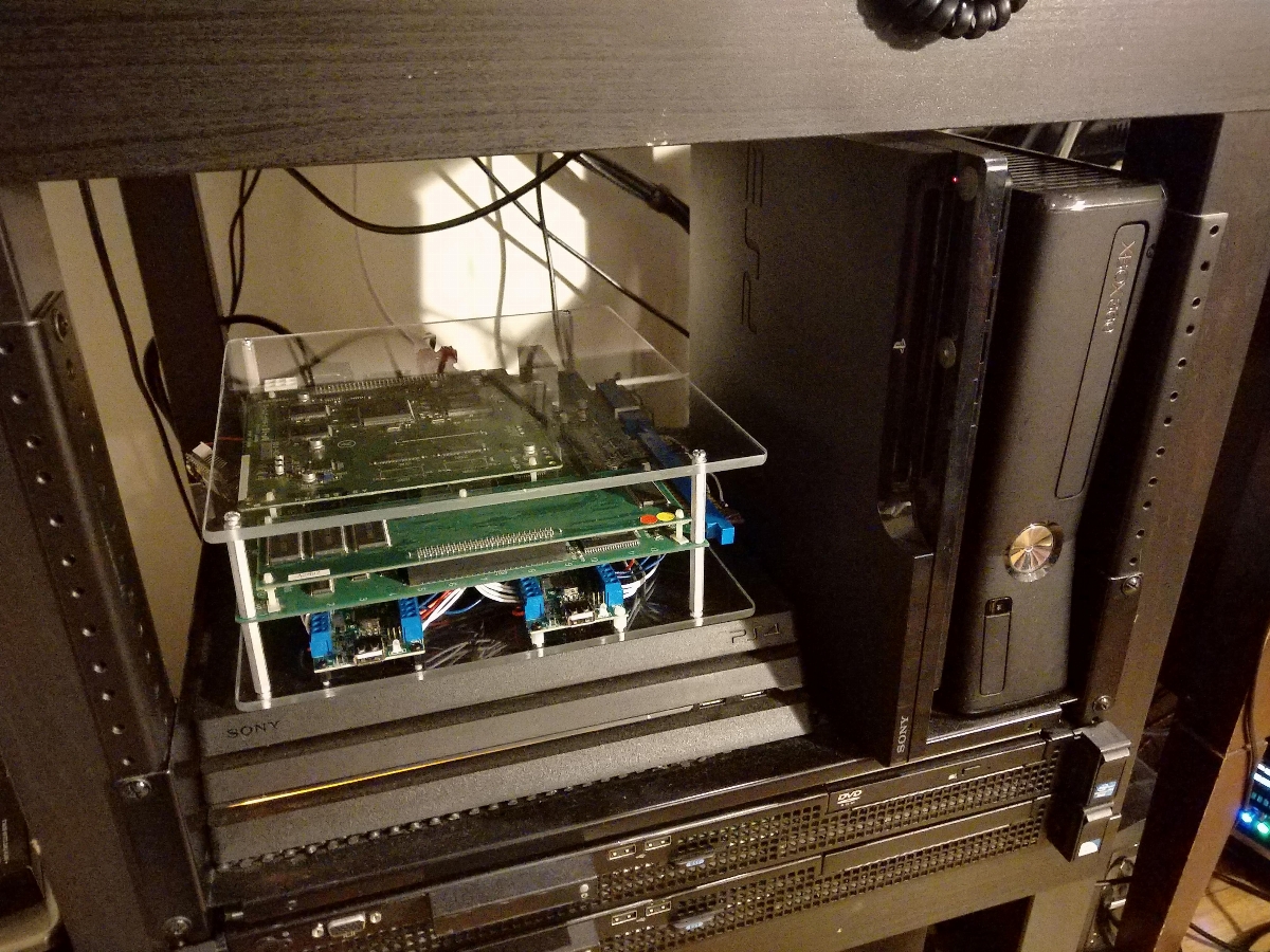

Moving things over to plexi, I shamelessly took inspiration from psykom1's consolized CPS3 post. A sheet of plexi from home depot, long standoffs off ebay, and screws to hold everything together. I really messed up the screw holes (you can see the standoffs bending a bit) but at least it does hold and doesn't put flex on Tekken PCB. When I'd finally peeled off the plastic I was REALLY proud of what I pulled off.
Here's a pic of how well it sits with the rest of my stuff:
