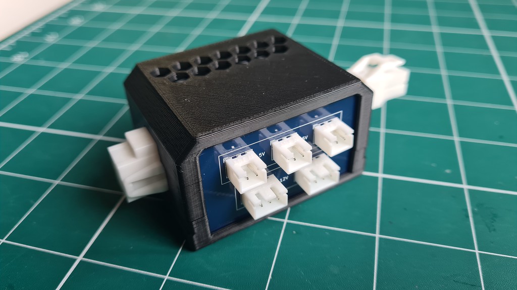

I need 12v and 5v output in my Vewlix's for a few upgrades and control panels. There is a 12v feed from connector P4 but there is no 5v source in my Dia Blues at all as there is only a 12v PSU.

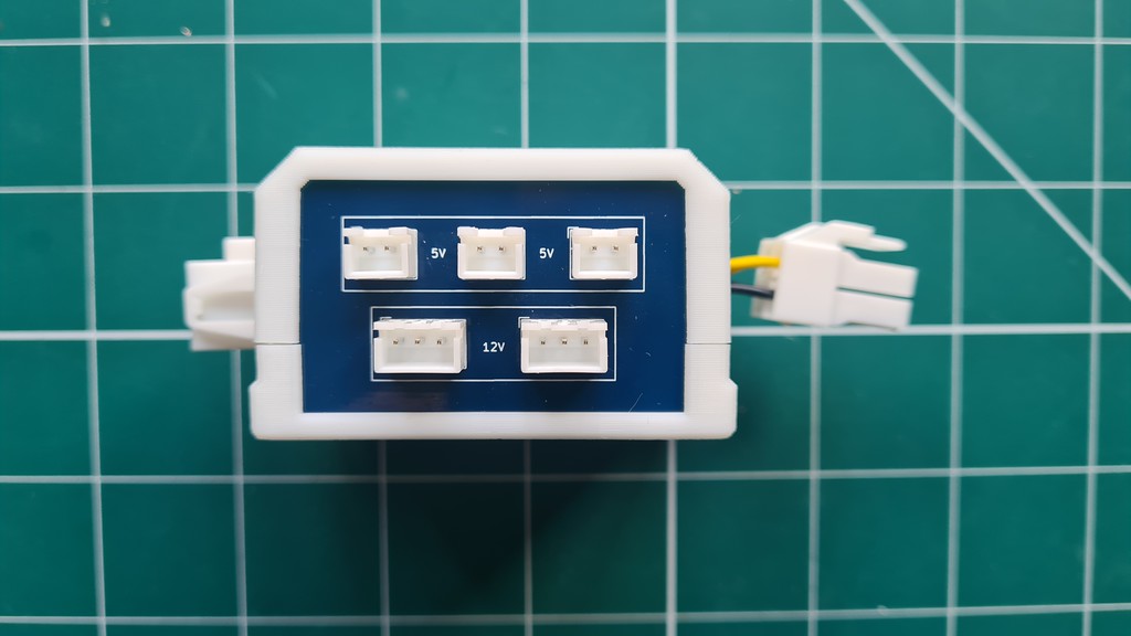

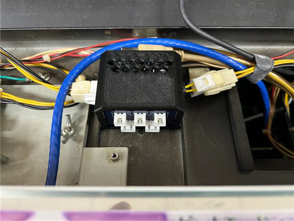

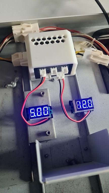

I've made an enclosure to tap 12v to two 3 pin JST XH connectors and I'm also outputting 5v to three 2 pin XH connectors via a DC-DC convertor. The enclosure sits in the U channel at the back of the CP. The P4 connector is unplugged and then connects to the JST YL connectors on each side.

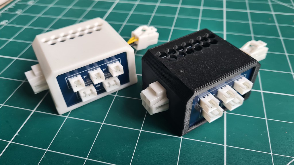

I've made a few up for me and a friend and I have parts left to make a few more if anyone needs one. They're quite labour intensive but I would like to keep them reasonable, say £30.
I can also make up any cables for connecting the output to things such as the [Crown autofire button PCBs] or anything else, just let me know.
