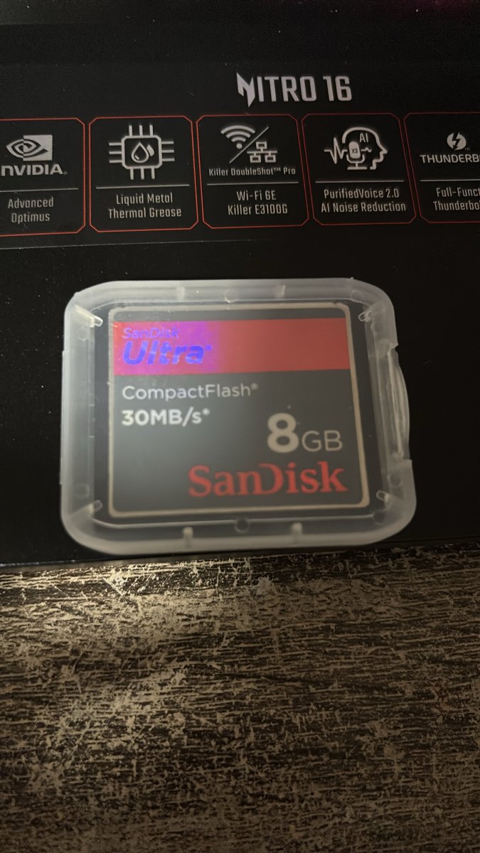

The secret is in the CF card, @VS_Lilith can you show us a detailed picture of your CF card please ?
Thanks, can you take out the card and take a picture of the back of it and the numbers on the side of the card please ?
