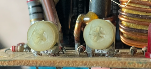

hidaniel Enthusiast Joined Mar 10, 2020 Messages 86 Reaction score 123 Location Winnipeg, Canada Jul 19, 2022 #1 I have a JVS power supply on which the 3.3v trimpot is borked. What resistance value would I use for this? Would 1K have enough range, or would 10K be better?
stj Grand Master Joined May 4, 2017 Messages 1,721 Reaction score 882 Location England Jul 19, 2022 #2 what does the original say on it?
hidaniel Enthusiast Joined Mar 10, 2020 Messages 86 Reaction score 123 Location Winnipeg, Canada Jul 19, 2022 #3 stj said: what does the original say on it? Click to expand... The only value I'm seeing, without removing the pot, is '52'.
stj Grand Master Joined May 4, 2017 Messages 1,721 Reaction score 882 Location England Jul 19, 2022 #4 500ohms 5 and 2 zero's you can check between the outer pins with a meter anyway
