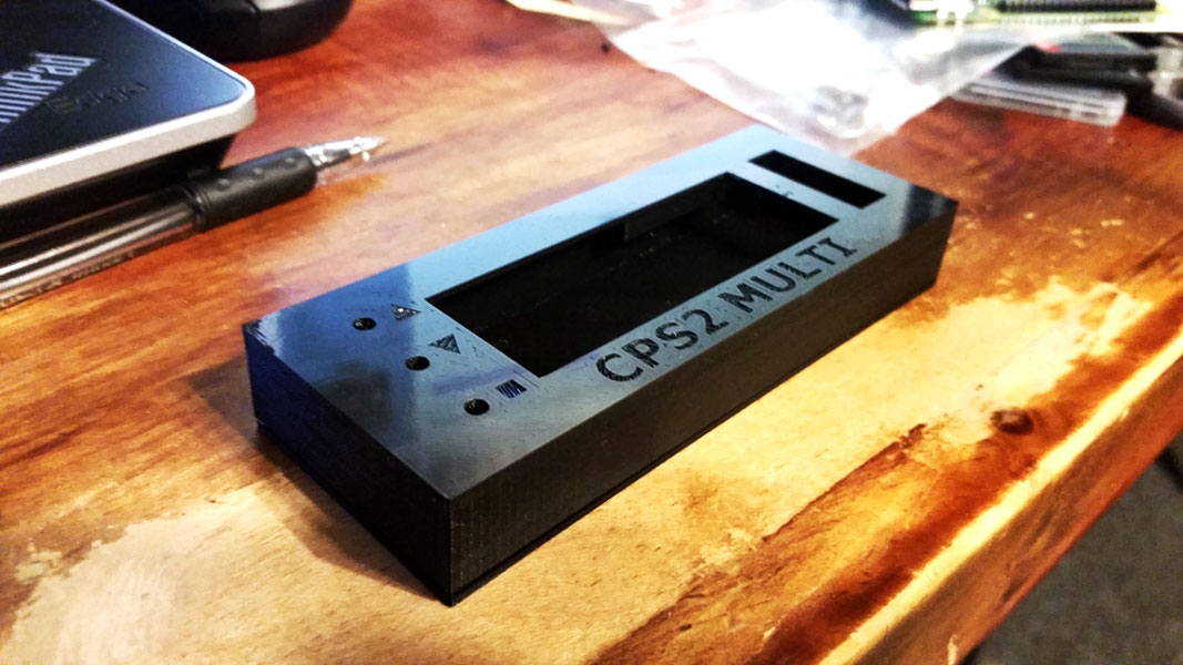

I did do a test print of the CPS2 LCD holder this morning... it's a very small part so fairly quick and cheap to print but I'm still concerned about the edge breaks. all the corners are sharp and have a slight lip on them so it may cause problems for the buttons and screws.
It's PLA material, and yeah you can sand down the material but really you shouldn't have to.
I feel if I'm going to sell something it should be something that you can just use without having to "finish" it.
Thanks for the link, that looks like a pretty tricky part to print, especially since the flex part should be printed along the x/y axis to prevent cracking from layer separation. That seems like one part that might be better suited to a redesign as opposed to a direct replica.
On your CPS2 multi cases you say the screw holes don't need widening but do the screws sit flush in the bottom or do they stick out... they SHOULD sit flush based on the design, but I don't think they have the right clearances.
