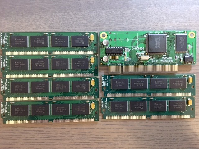

Full Darksoft Superbios Setup :thumbup:
The 2 bottom right simms are the new 64MB

Yeah. I test the 128s by installing four new simms and doing a game write. So It takes about 45 minutes to test four. I tested 100 of them. 15 were tested bad. Half of those were not recognized by the pcb, the other gave errors during writing. In the last batch I had about the same % bad with the same symptoms. All but one was fixed by resoldering by hand. That one most likely had a bad flash. Not bad to consider one bad flash out of 800 when using NOS chips.
The batch of 64s were tested by using the SuperBIOS cart and manually writing the game files to each SIMM. I only had 30 to test in this batch. Zero bad 64s during testing. I think they are more wanted than we thought so hopefully we will get another batch of 64s in the near future. I don't think any of these 64s are going to make it to Europe.
