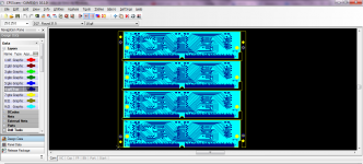

See below Gerber Files for SIMM ready to go into production.

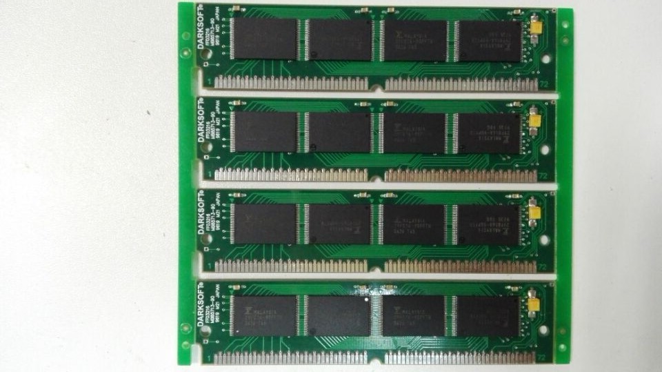

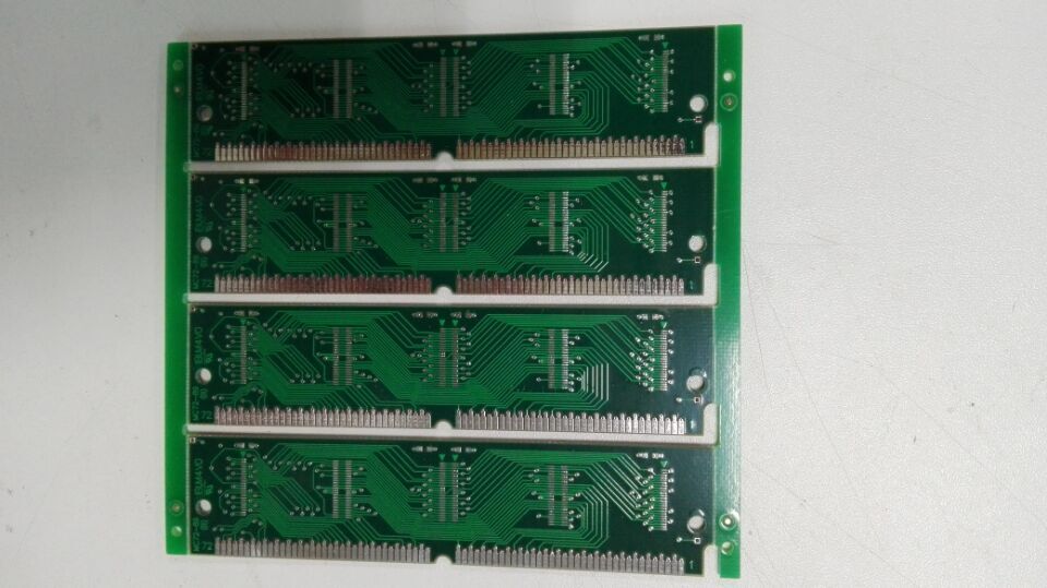

See pics below. Notice the small DARKSOFT text on the right.

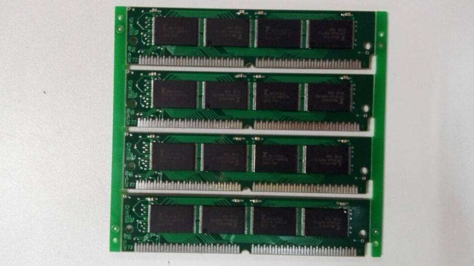

Samples arrived. If they work well, I'll have the rest soldered....and shipped to you guys.

Right now he only has the first samples. There is a correction that needs to be made. Darksoft will keep you all posted I'm sure.
