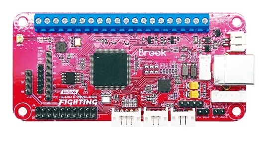

I search a way to power on the x360 but also a PS4. Brook UFB is really great but it can't power on the consoles and i'm really desappointed.
So, i have an idea to solve this. I leave the brook aside for now (for the player 2, i don't own the 2P panel yet) and try to mod/wire some other pcb that allows the power on.
I excluded the remote controller option because i don't really want power on consoles with an extra 'power' button.
Goal : power on consoles with the HOME (x360) or PS (ps4) button.

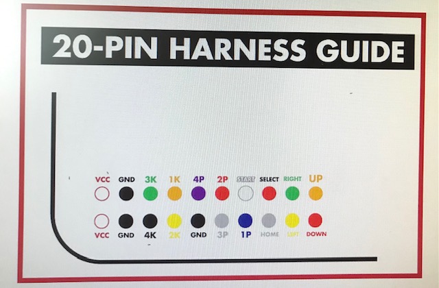

Some information if someone needs it :
Brook UFB mapping
Brook UFB connector :

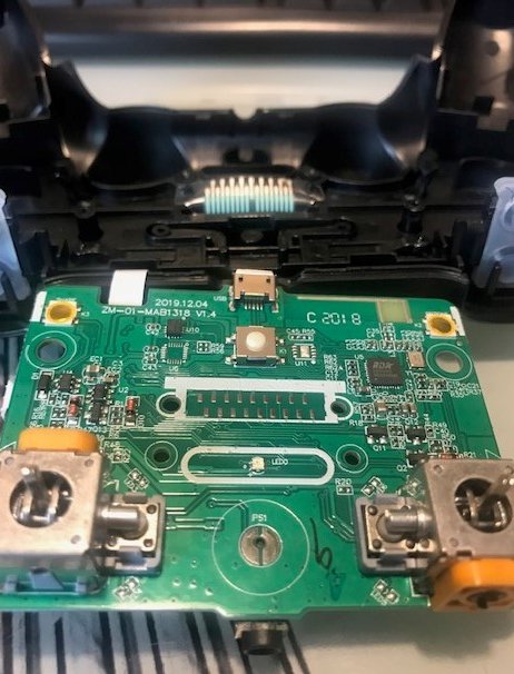

I ordered a non officiel ps4 controller to make a padhack. Unfortunatelly, i'm not used to do these things and not well equipped too. I failed... :(
I have to find another way to achieve my goal (power on the ps4 from outside the cab).
During my searchs, i learned that no wired devices can power on the PS4.
So, i bought a brook wireless fighting board.
https://www.brookaccessory.com/detail/41130595/

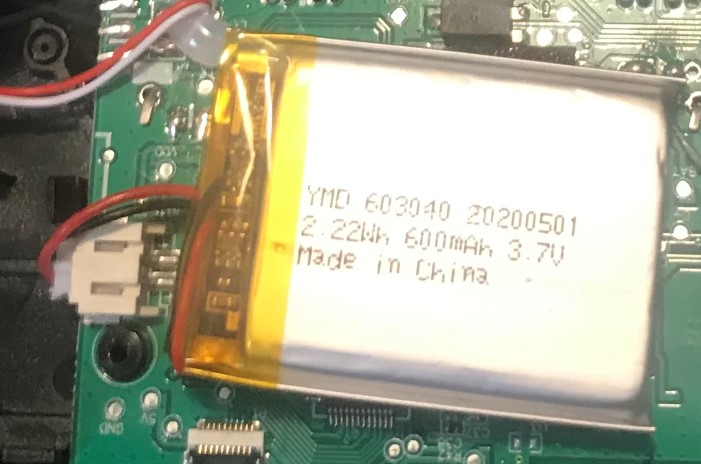

This fighting board needs an optional battery to use wireless function.

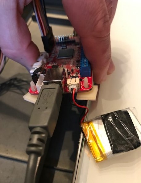

Thanks to my previous failed hadpack, i re-use the battery on the brook pcb.
And... YES !! It can power on the PS4 !!! I always smile when i push the PS button from the external vewlix plate :)
I let the usb cable plugged to have the battery charged.
I'm also able to shutdown the ps4 but it takes a few seconds to have the ps4 fully off before shutdown the cab.
