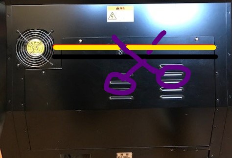

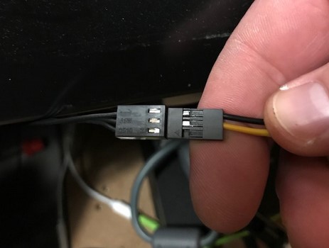

I had to rewire the 12v vewlix input with a dupont connector to fit the new fan.

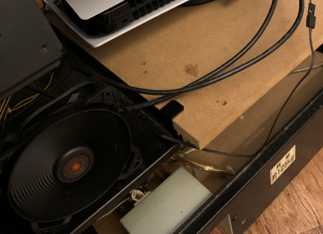

Hey 9uile, thanks for documenting your upgrades. I am looking to replace the back fan on my Vewlix F, and after unscrewing it, I noticed the wiring is connected all the way to the left side, pairs with more wires from above, and then eventually that larger clump makes its way to a white double F1 clip which then connects to the board nearby.
Apologies if this is a dumb question, but how did you rewire your fan? Did you simply buy a new dupont housing and crimp tool, cut the two existing wires connected to the factory fan, and get them into the new housing which your new fan then connects to? I am just looking to make sure I am doing things correctly here, especially before cutting the factory fan wires.

Hi. It was really easy. I cut those two wires that went from the right side.
Change the old fan by the new one and rewire like this with dupont connectors (because i had some but you can rewire with something else).

Thank you for the explanation. I am going to scoop up a dupont connector kit so I can get my new fan hooked up. I really appreciate the help!
Thanks again for the advice 9uile. After a few failures, we got the new fan hooked up and running! Mounting it and cleaning up the wires next.
