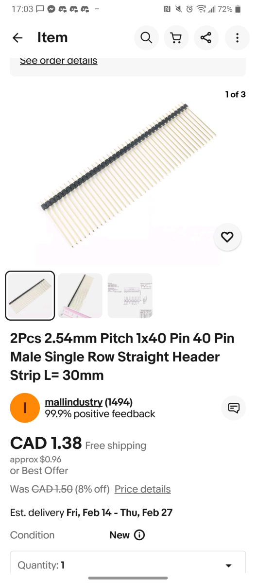

I've done this. I think they are 30 mm pins. They could be 28 mm.
I got mine from ali express.
You can trim the solder side of the pin if its too long.
Obviously the top needs the rounding.

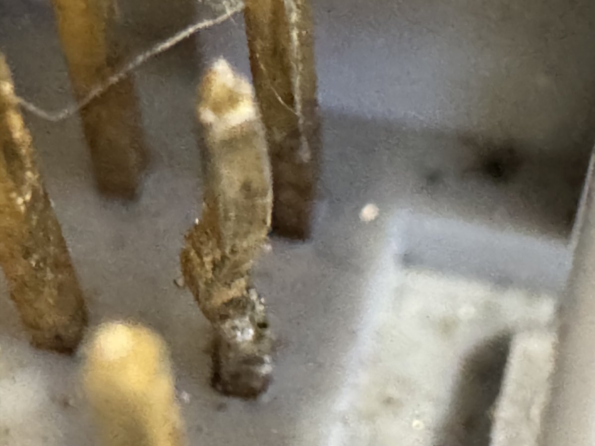

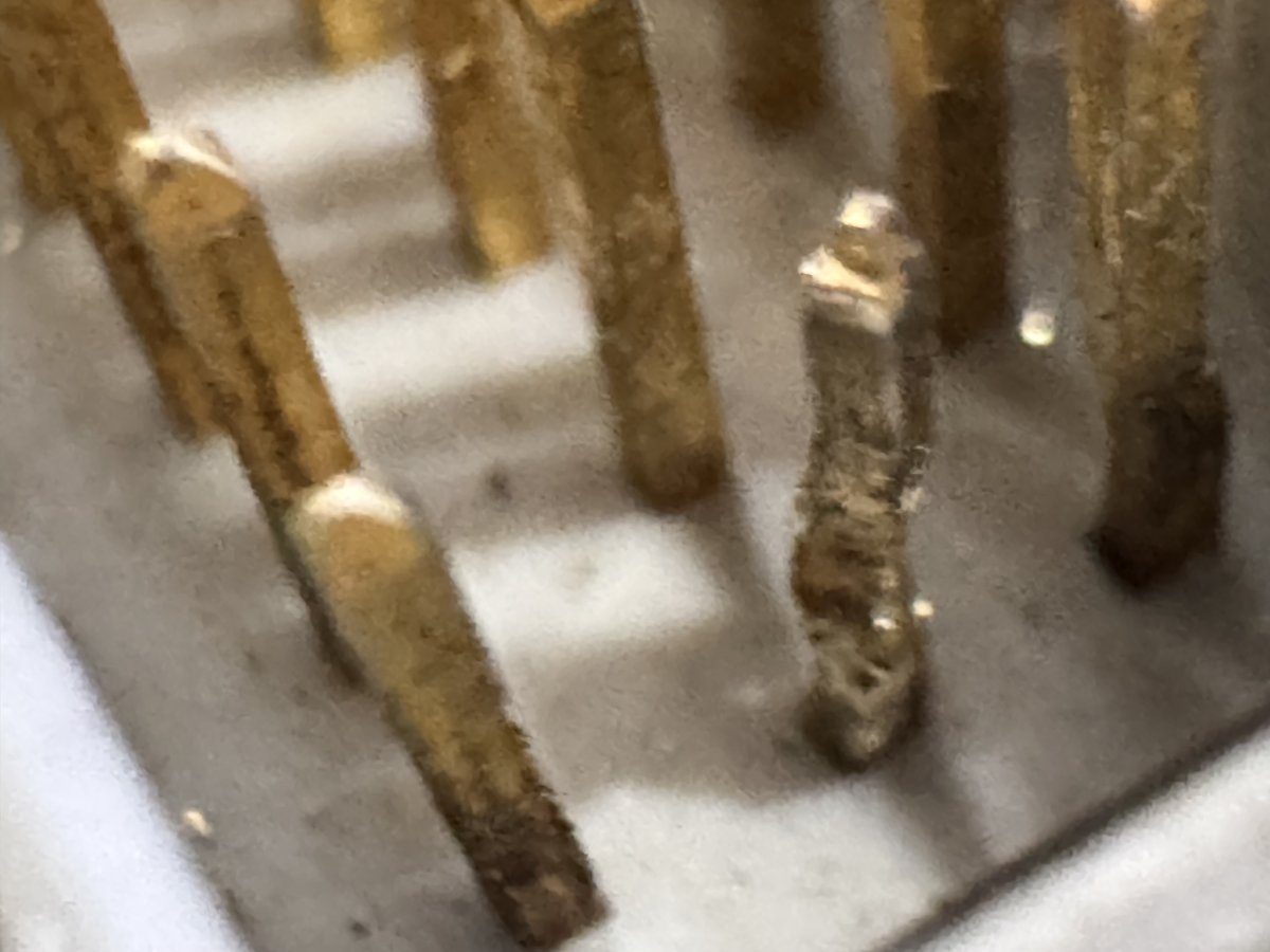

OK, so the game works in my other motherboard and all games display the same issue in this one. I guess it is likely the pin, but of course, the pin could be fine and it could be something else wrong too, but at least the problem is narrowed down to this particular A board. I will attempt a pin swap or replacement, one day....
Here's the best I got it after fiddling with it another 15 minutes.
After the hour the other night:
After saying fuck it, let's pull on that little bugger like a teen boy who just discovered Pornhub, 15min later:

I bought them off ebay apparently.
Here you go. I do remember trimming them on the solder side so keep that in mind.
