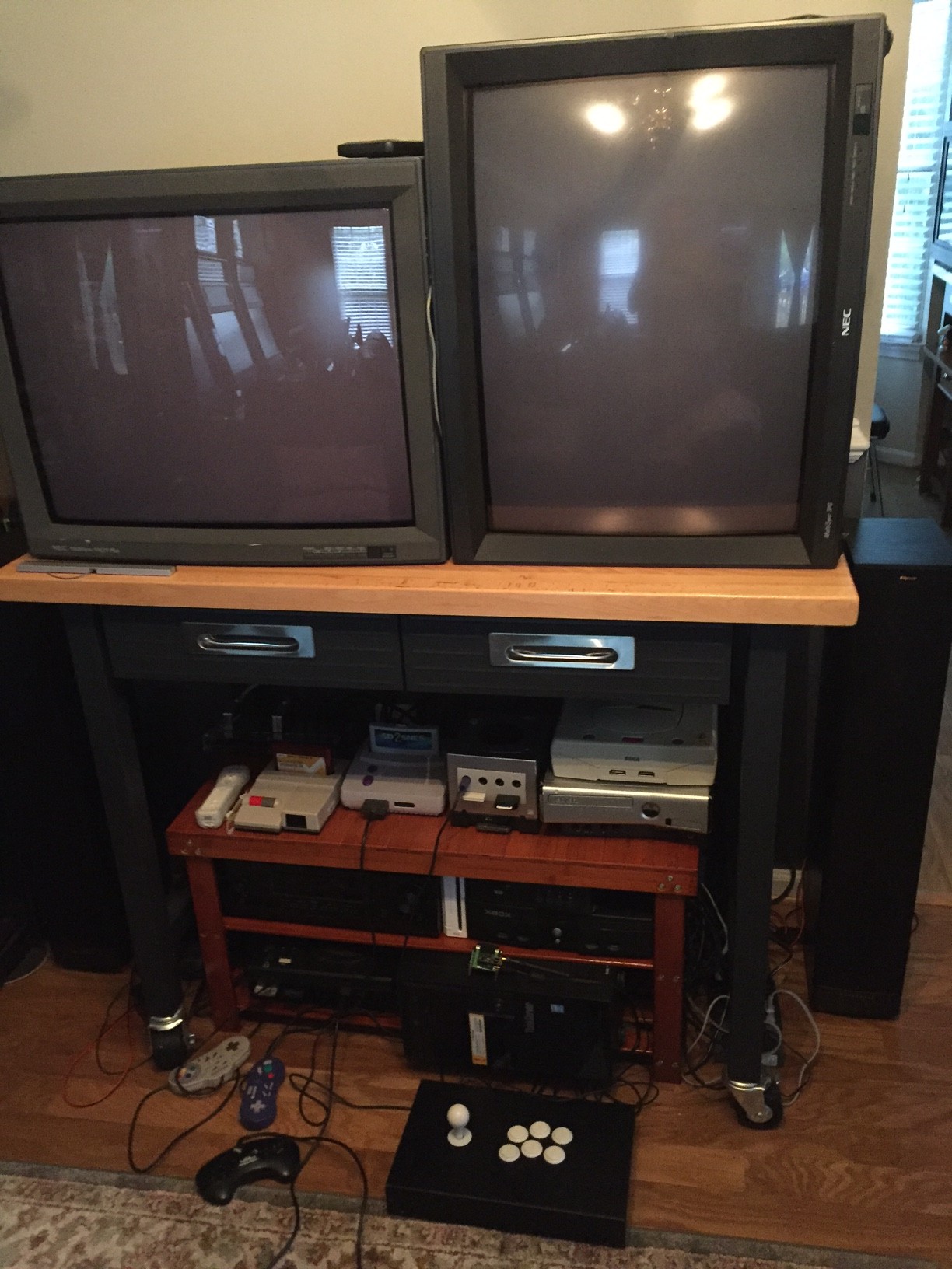

I have most of the CAVE games on the Xbox 360. I find that I have a better experience with GroovyMame 15khz an extron 203 connected directly to the NBC RGB input on the RGB capable monitors.. I would recommend that route over the Xbox 360..alternative PC CRT with GroovyMame at 31khz.. I also have UVC but have not tried it on the Xbox because it seems to much of a hassle. Having the Xbox cave actual games that are not in mame is more of a nice have.
Edit - this his how the setup looks like with wireless Panzer and PC GroovyMame..Also, going over the RGB NBC gives my monitor a clear picture than going over the RGB 9pin that looks like PC input.

GroovyMAME would produce more accurate timings, so I can see that set up as being a little better honestly.
I don't think you could be more wrong about hassle tho... GroovyMAME is a total pain in the balls to set up!
All you need to do on 360 is plug in the VGA cable, set the console to 480p, connect the UVC to the cab.
I've still got the cable I made you to easily connect the UVC to a 15khz JAMMA cab, I know the first one had problems but the 2nd one was/is perfect.
