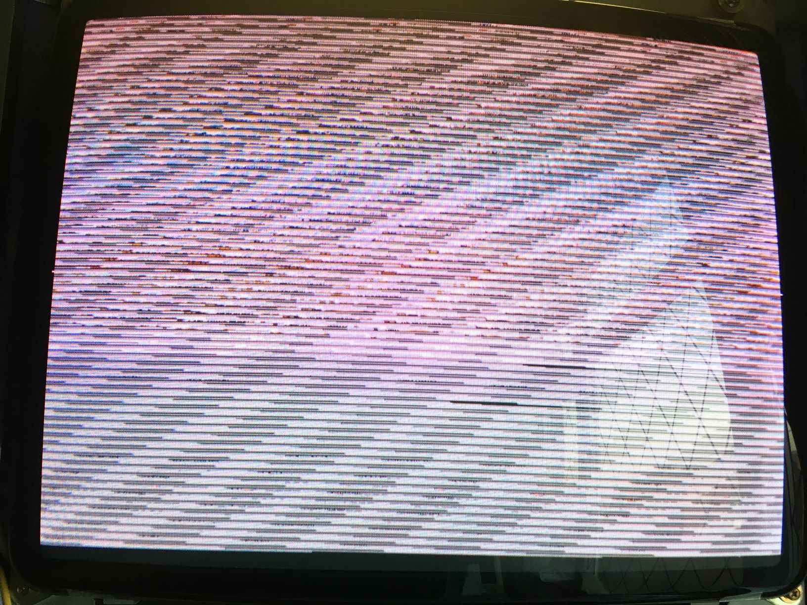

Hello Everyone, I'm new to the forum but feel like I've been here ages as its taken me a couple of weeks to read through the 118 pages, Its amazing that the same members are still here and active after 4 years, I've just a few questions if you don't mind, I bought a naomi universal cabinet in November of last year and started to restore it, it came with a net dimm and a taito tx2 multi disk, but its only this last couple of weeks I've been able to try it out, the naomi games are good but I was blown away by the tx2 games, the setup I've got all seem to play perfectly fine but I just wanted to check with you guys if I'm missing anything special with the update, I've attached photos of the one I've got which is the 1.4 final, only thing I've tried since reading through is that if I change jumper 2 to on it should go into a higher res, as some of the games seem to play in letterbox I thought id give it a try, however the menu system then goes weird so I switched it off again, am I better off leaving it as is and just enjoy the games or try to upgrade to the latest, also I noticed everyone states using ssd, but when I had a look mines just using a standard sata drive with no noticeable issues.

if you have a Naomi the hires 720p is not for you that’s for an LCD cab like the Vewlix, also there is a new version of the multi which I think is called V2, it’s great that’s the one you want.
Having the same setup, I agree, the cabinet can only do 480p, so don’t try it with the 720p dip. It’s actually pretty satisfying to use the Universal with both NAOMI and TTx2 setups.
The SSD isn’t necessary, but I figure why not to help with loading. The thing is quick! Make sure yours has the RAM and CPU upgrades, though.

thanks for the replies, at least I know there's nothing wrong with the setup then and ill just leave the dip switch to off, just didn't know if that was why some games were in letterbox and some full screen, at least my favourite so far (kof maximum impact) is in full screen and I love it, the games boot up pretty quick as they are but I might buy a ssd and try the latest version, would you say the game list looks complete?
