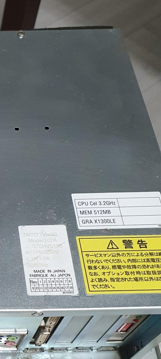

Hello, I've maybe found a TTX2, it's seems to be an early modek:
Taito Type X2 MODEL
102A CPU CELERON 3.2GHz GPU X1300LE RAM 512Mb
All TTX2 models are upgradable ?
For the CPU I've a Q6600 with 4Gb DDR2 RAM. I have just to remove the Celeron et put the Q6600 ? bios update ? Is the P4 3,4GHz best solution?
