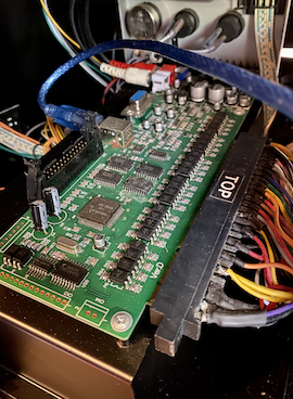

2) When I hit the 'Service' button in my cabinet, nothing much happens. I suspect that this is due to some weirdness with wiring which I intend to look into. Just curious if there's a way to set things like free play in any other way if needed? I'm using it on an Arcooda Gamewizard Xtreme (vewlix clone), IO board pic below.

1) Same thing happens to me; it only reports the system as having 3GB, probably due to a limitation in the XP install being 32-bit, as Pascal pointed out. Technically, it's a 4GB limit, but around 1GB or so can be reserved by the hardware, leaving only about 3GB usable for the OS.
2) Service button works fine for me, likely a wiring problem with your cabinet. If you're using a JAMMA converter like the Capcom I/O, there are service and test buttons just before the JAMMA edge.
Fixed it! Turned out the JAMMA connector had a bit of left/right give, and mustn't have been perfectly aligned. Service button is now working as expected.
