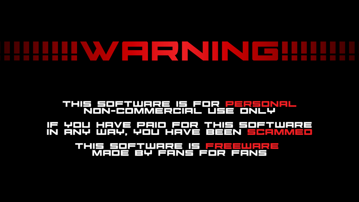

Atrfate's Attract Mode added a loading Nag Screen. Even I HIGHLY appreciate his work I am not a fan of the Nagscreen and I will not sell the image since it's only for private use.
I guess it's written in the game.exe of the frontend?
Has anyone been able to remove the nagscreen? I guess it calls the bg.png?

Which nagscreen are you referring to? Can you share a picture?
Sadly Artfate hasn't been logging in for a long time and he didn't share his work. I have some issue also, but there is no way to ask him for help.

This one:

Yes, I totally forgot about it, since I abandoned the Artfate frontend due to control problem on MAME.
Do you have any luck on let the commands work correctly on MAME, when launching from artfate's frontend?

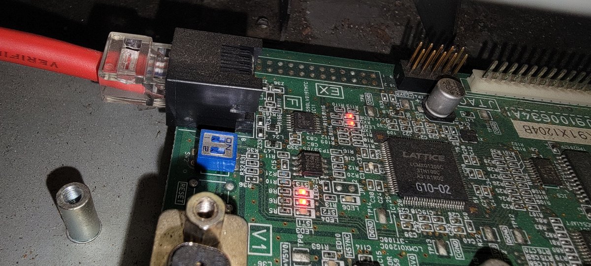

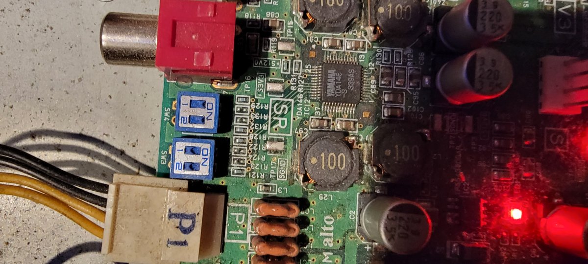

I tried the return to menu and it didn't work. These are the dips for my fast io. If you are still running a fast io in your setup @Niko could you see if these match? I dunno why but I have a feeling it's the dips.
Niko
Sep 22, 2015
1,085
1,716
Louisville, Kentucky
The DIPs on the FastI/O shouldnt have anything to do with it.

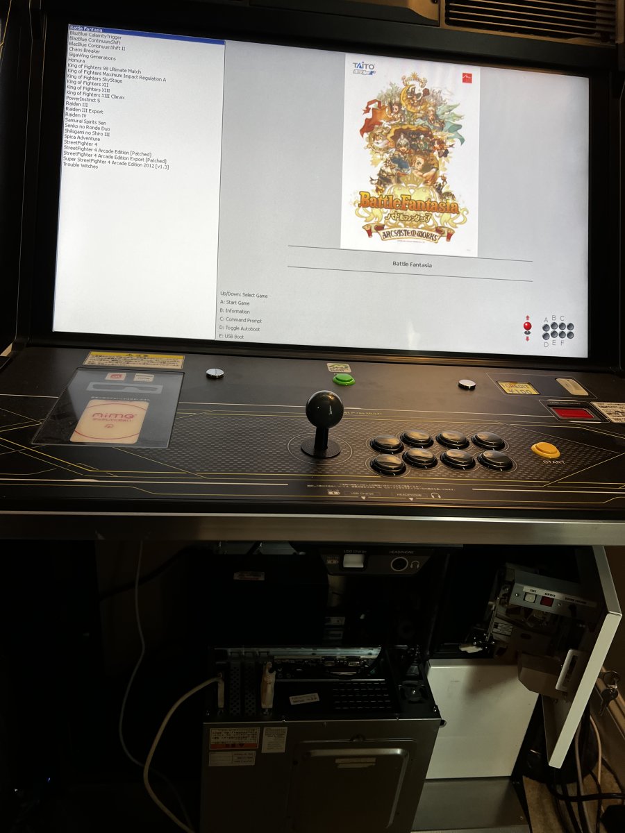

Totally new to post-JAMMA arcade systems and their multis, apologies if this is a stupid question. I have a TTX2 with this multi coming to me and it looks like this:
I've seen around people with a Nesica style frontend for selecting games, is that something that's compatible with this multi or is that some entirely different "product"? Note, not asking about where to get Nesica games, just the frontend that makes it look like a Nesica terminal.

Just gotta go back like 50 pages:
https://www.arcade-projects.com/for...reeware-taito-typex2-multigame.820/post-65416
