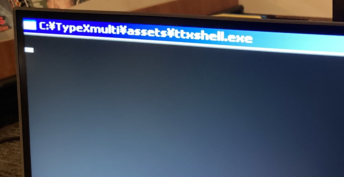

HELP - Dug out my X2 from storage. Turn PC on, see white Taito screen, see ttxshell.exe window, then black screen. Reseated everything. Burned new image on different drive and same deal.
UPDATE - Use a Western Digital drive from around 2010.

I think in this step it tries to inititlize the JVS IO. Maybe you have an issue with the JVS controller card, the JVS harness or the IO itself. Do you get an error message with the USB-A-like JVS plug disconnected?
Never had your issue though. My next steps would be trial&error like:
  • Checking the correct DIP switch positions
  • Removing one of the RAM modules one each
  • Replacing the Graphics Card (in case you can just use a similar GF7900GS 256MB and change the PnP ID)
Best of luck!
Edit: I saw you just updated your post and it seesms to be starting now - obviously you had / have a SATA cable issue. The character-thing is normal, caused by the System Fonts of the Japanese Windows XP Distro.
I used another drive, and it started working. I think the X2 just hates Kingston drives.
After chasing gremlins for the last few weeks with a new multi install, I'll back up this theory about the X2 not liking certain hard disks. I have another X2 multi with a WD disk from 2010 that works, so I ordered an identical one from ebay. Worked first time. So from my experience it didn't like Kingston, Hitachi, and a WD from 2018.
