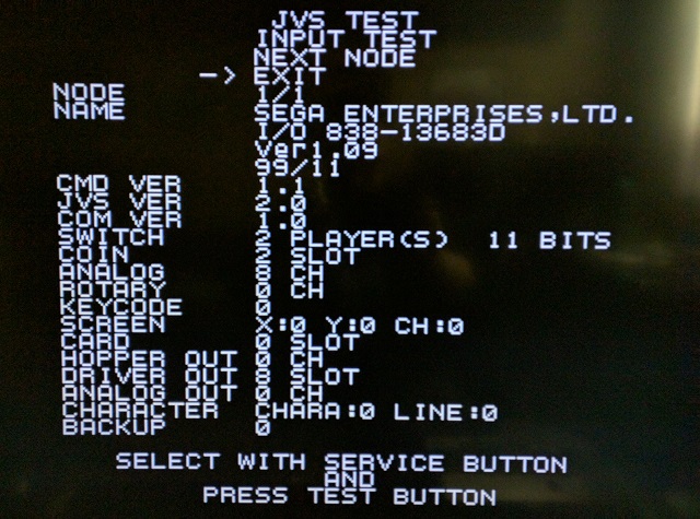

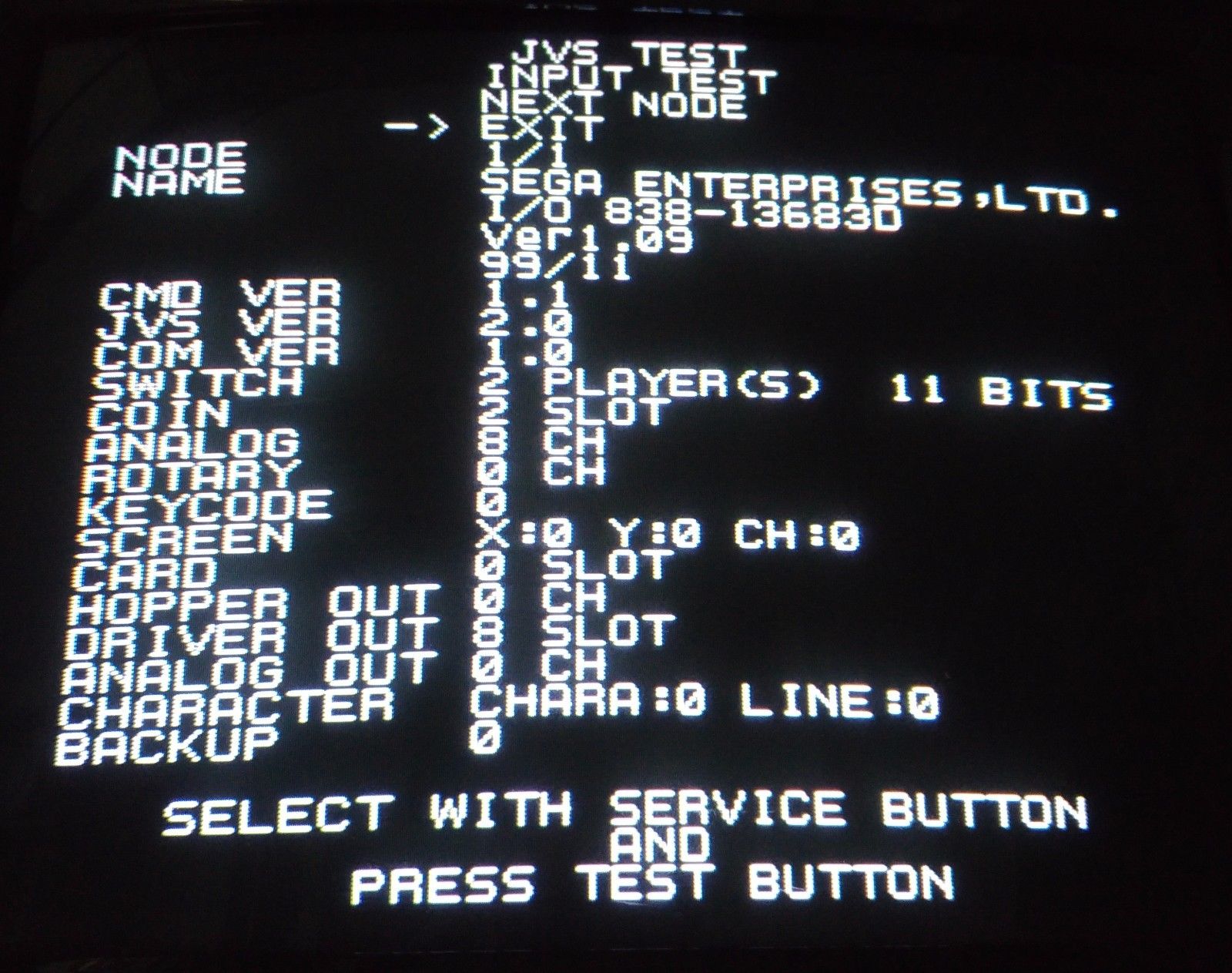

Can you show us the version info nismopunch ? I.e. connect it to a NAOMI and do the JVS test from setup ?

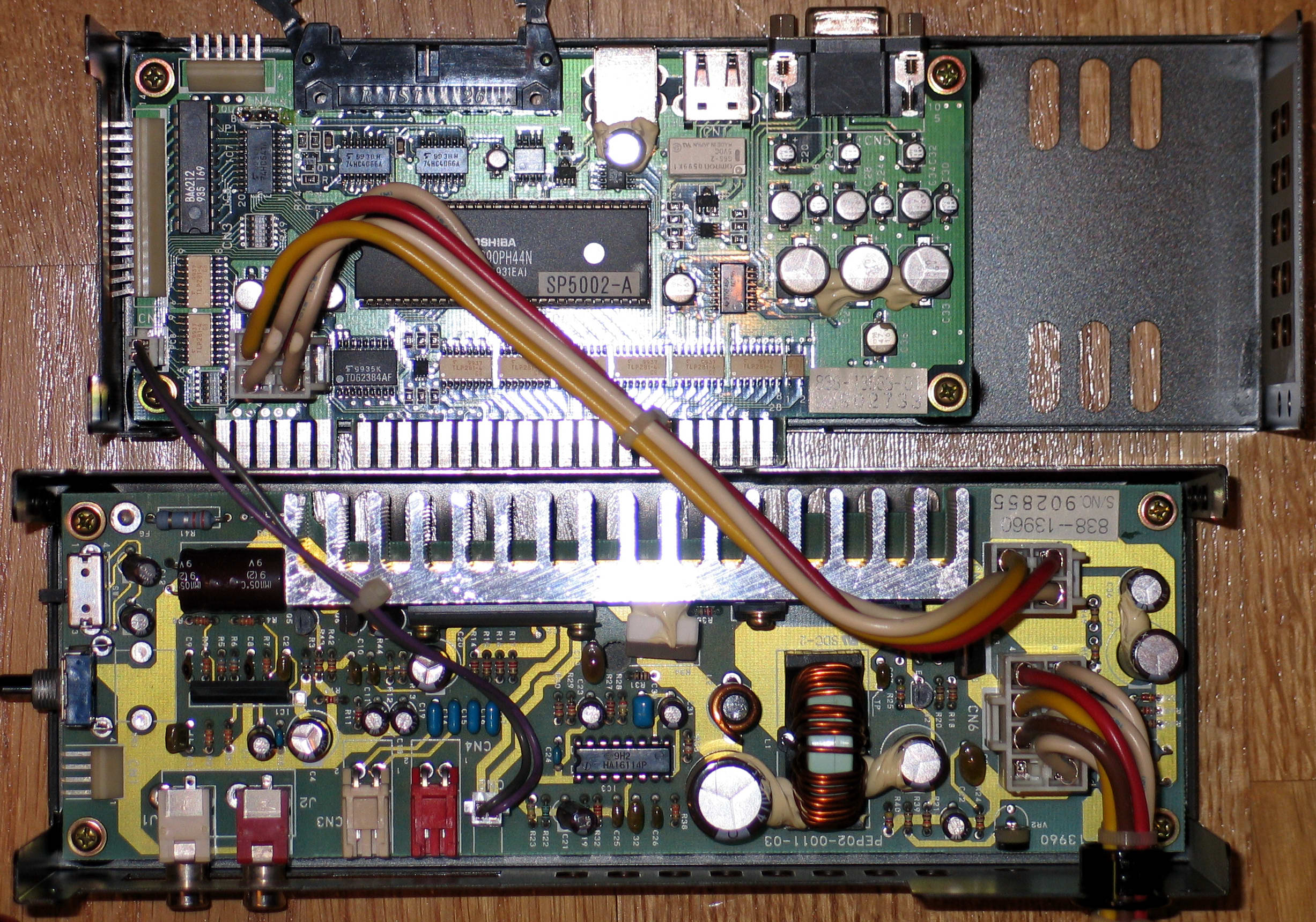

This is what is looks like on the inside, standard PCB with an extra 3V3 PSU and sound amplifier.

Thanks Rtw, I can do that later tonight and post a pic of the version. It was a pain to use the resistors, but I have a lot of JAMMA only stuff and this way I could keep my JAMMA boards happy and still use JVS stuff as well with the same setup.
