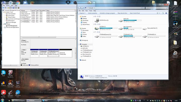

I got my SSD now, and I loaded the 1.3 IMG of the Mutilboot.
I got my Drive divided in to those sections on the picture I uploaded.
Can I just go to Disk Management to increase their size by "Extend Volume"?
When it comes to Games I feel that 47GB might come short.
Is the Games folder, only meant to house, X2 Games or also other Plattforms (examu, X1 etc.)?

Hey Guys,I got my SSD now, and I loaded the 1.3 IMG of the Mutilboot.I got my Drive divided in to those sections on the picture I uploaded.Can I just go to Disk Management to increase their size by "Extend Volume"?
Yes, I did exactly that :)
Hey Guys,
Yep, the volume is safe to extend. Its initially created at 60GB so users can use any size disk they want.
