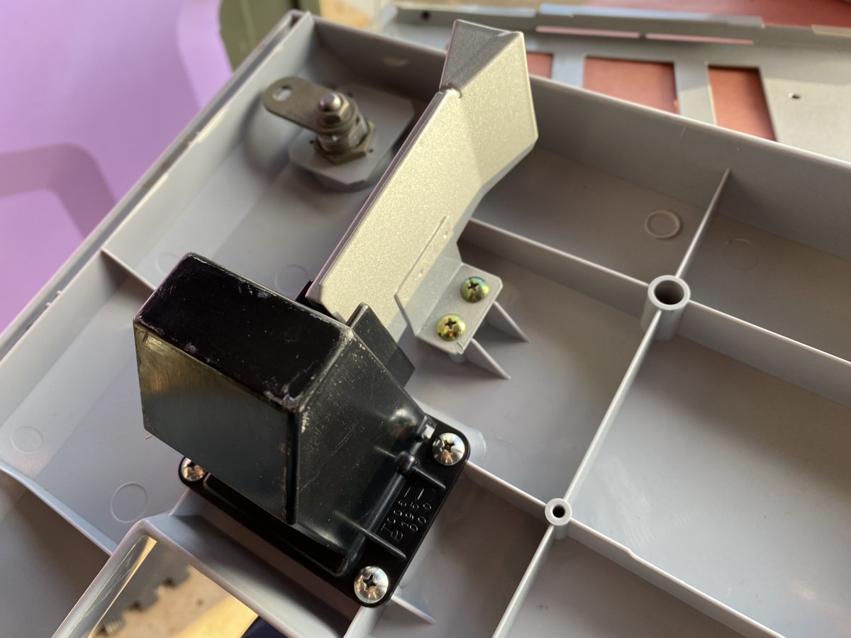

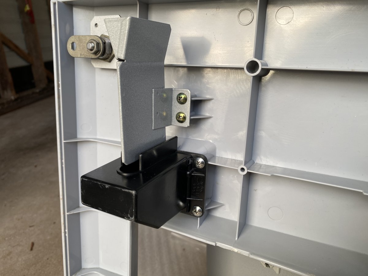

Piecing together the front panel. I tumble “polished” the lock components in my home made glass jar tumbler with 3mm stainless steel balls from TEMU. They didn’t come up shiny but they were smooth without corrosion. I gave them a spray with lithium grease for protection. The coin chute is powdercoated and the screws have been polished.

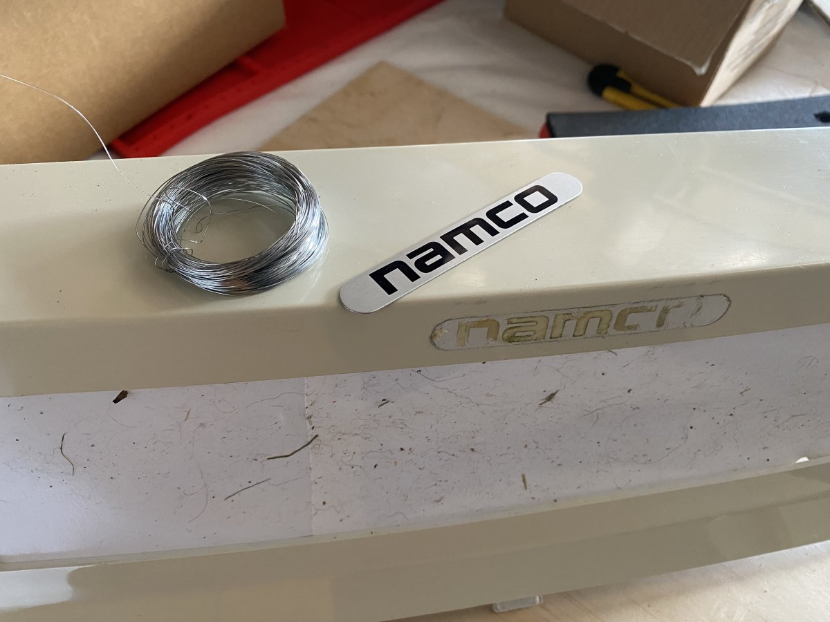

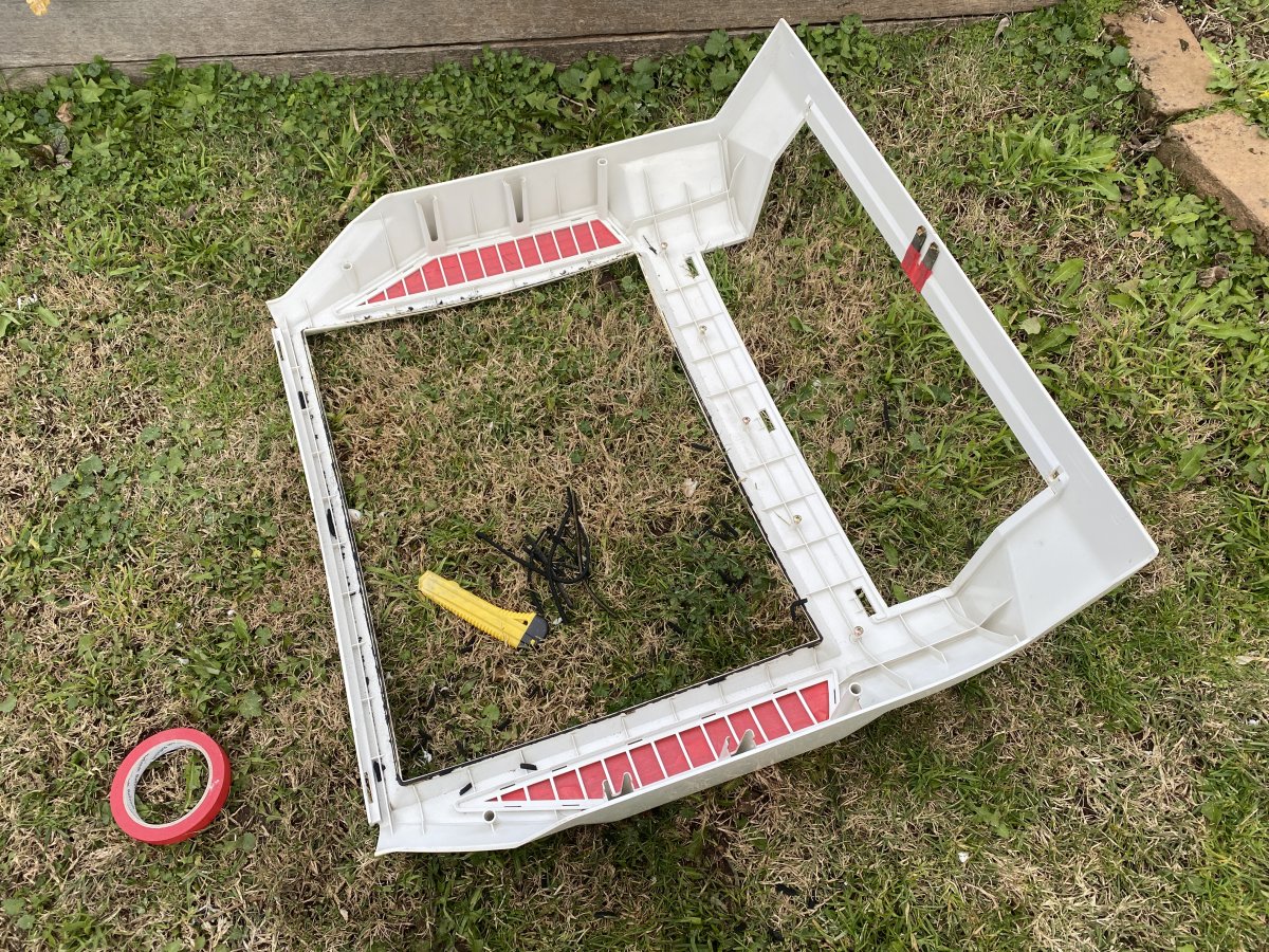

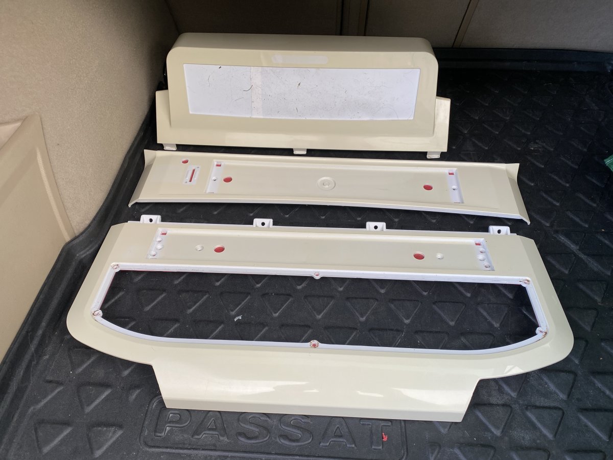

I got a few more jobs done today. I’m prepping and cleaning the white plastic parts for painting. I wasn’t going to bother but @Offsider inspired me to do it after I saw how good his looked. I’m only going to get the outside face painted, and don’t think it’s necessary to mask off the entire back part - just a few areas . A bit of overspray won’t hurt. I noticed the foam seal around the bezel is perishing so that’s become a bit of a battle to remove completely. Cheers @Offsider for the tip to remove the Namco badge. I didn’t have fishing line but thin wire worked.

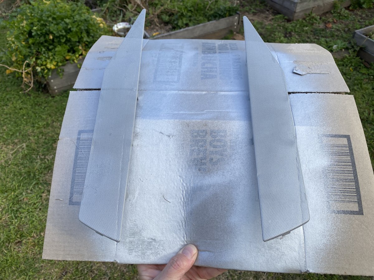

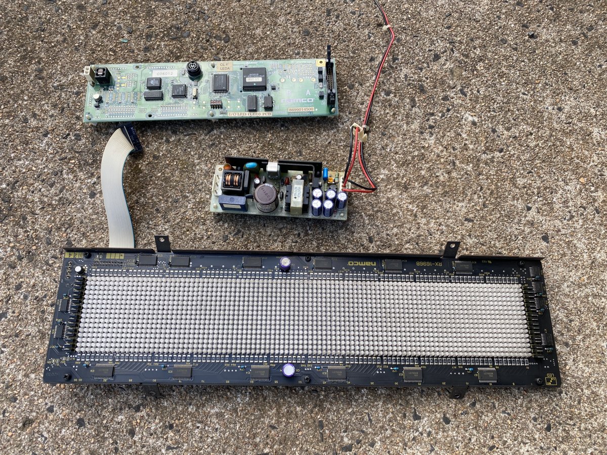

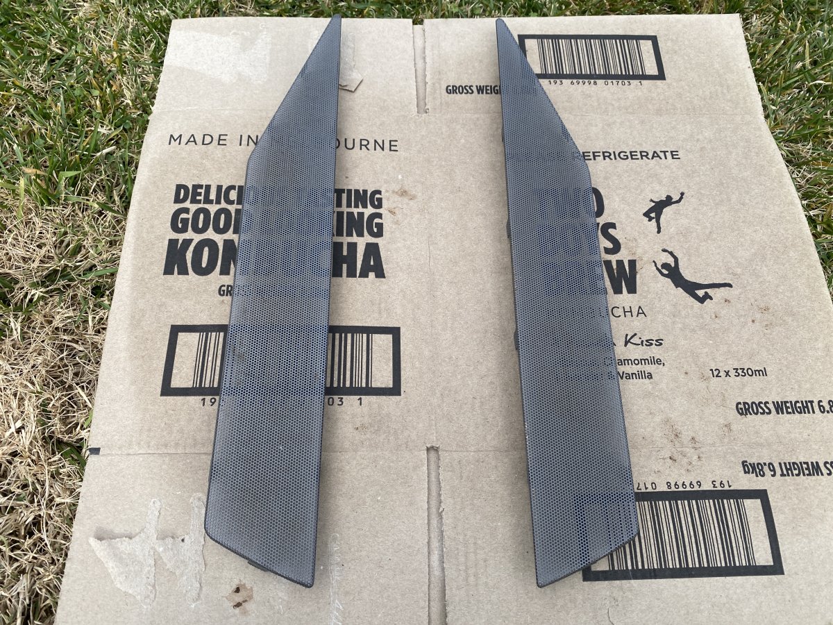

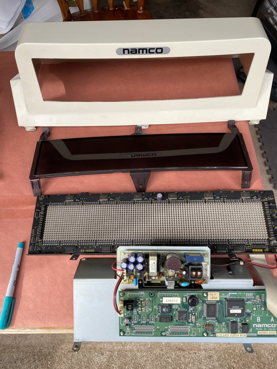

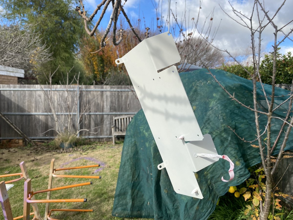

I pulled apart the LED display assembly and gave that a clean. I also decided to paint the metal part that holds the boards as it could do with a bit of moisture protection. I’ll likely give it another coat of grey or silver. I painted the speaker grilles as well. They were showing signs of very light rust. I was a bit heavy going on the paint and a few holes covered over which I “popped” with a pin. It looks decent but the original was a bit of a darker gray. I’ve gotta use up some of the rattle cans I’ve got lying around somehow. 😏

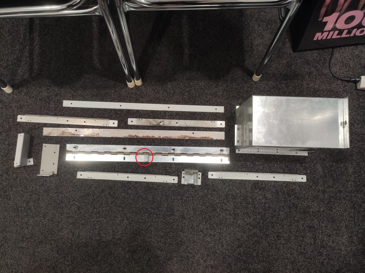

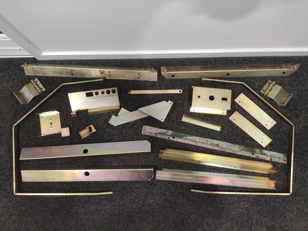

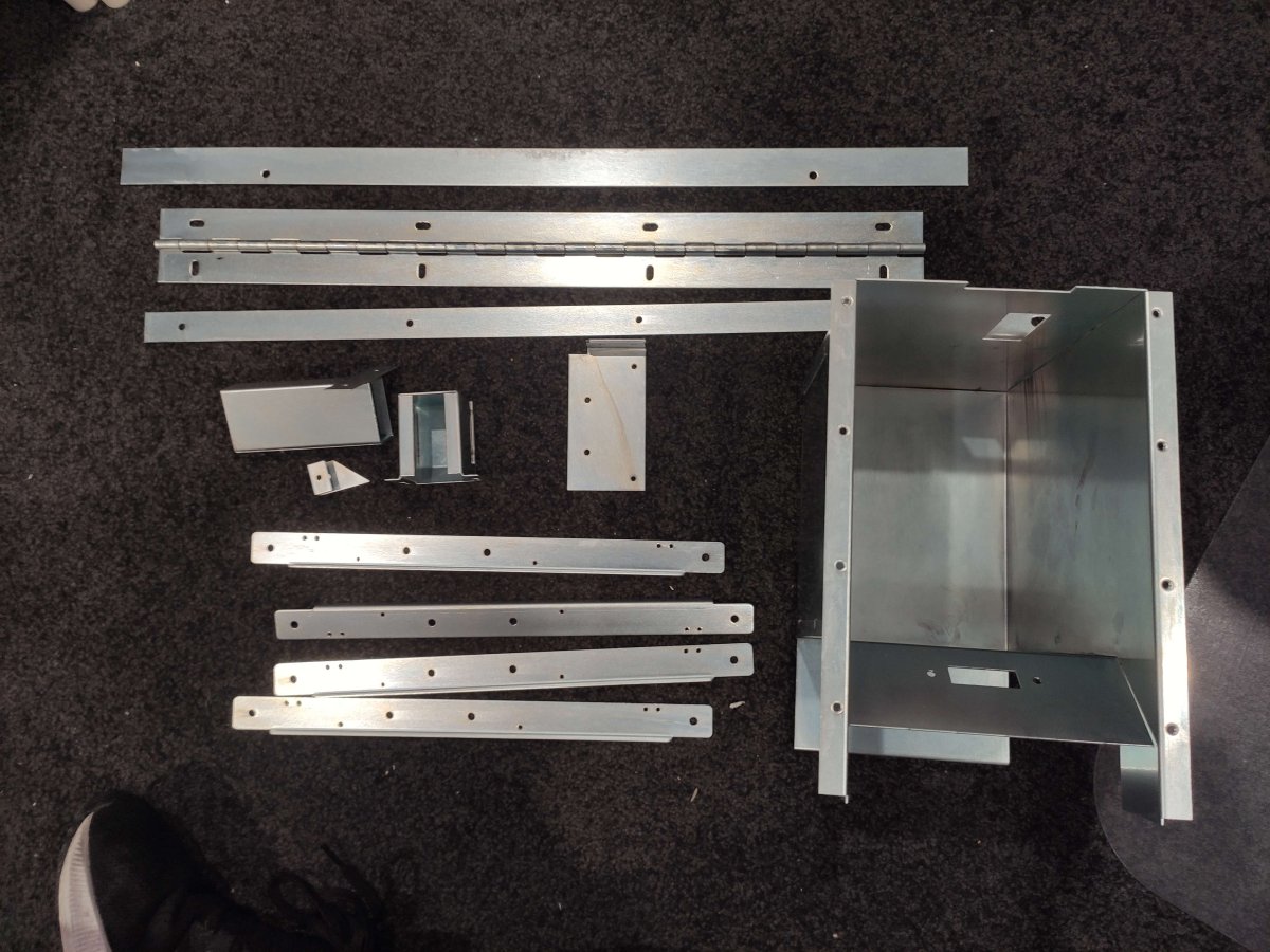

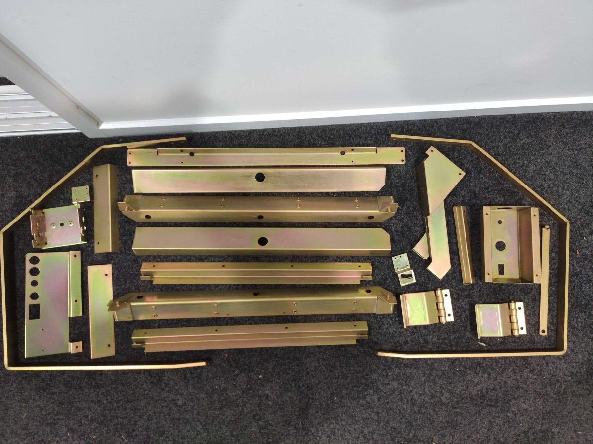

I noticed you powdercoated some of the electroplated parts, it's probably too late now but electroplating isn't expensive and keeps things original.
These are some parts I got done recently.

Very nice @vaughan14. I would have definitely gone down that path but there’s no electro plater in town. I would have had to find someone in Sydney so powder coating it was. What machine are you restoring there?
The amount of work your putting into the cabinet mate, it was a given to get the plastics done. I’m glad you decided to do them!! These are going to look really nice legend.
From the powdercoat, reproduced stickers and the overall thorough restoration of this thing , it’s going to look like it’s just rolled off the factory line.
In awe mate well done and have loved relating about it with you so far
On ya legend!!

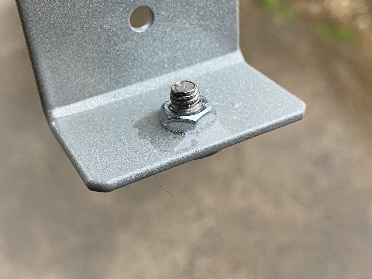

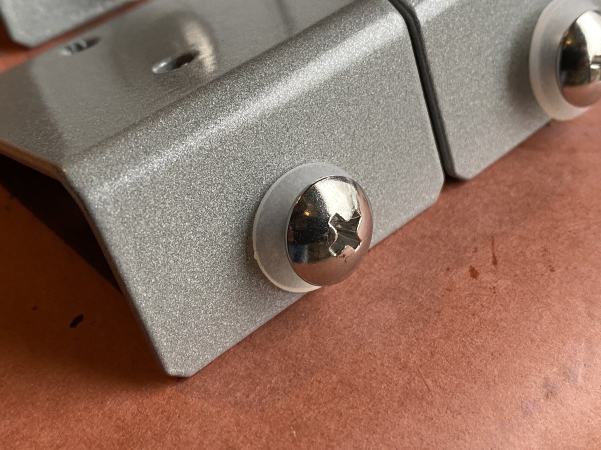

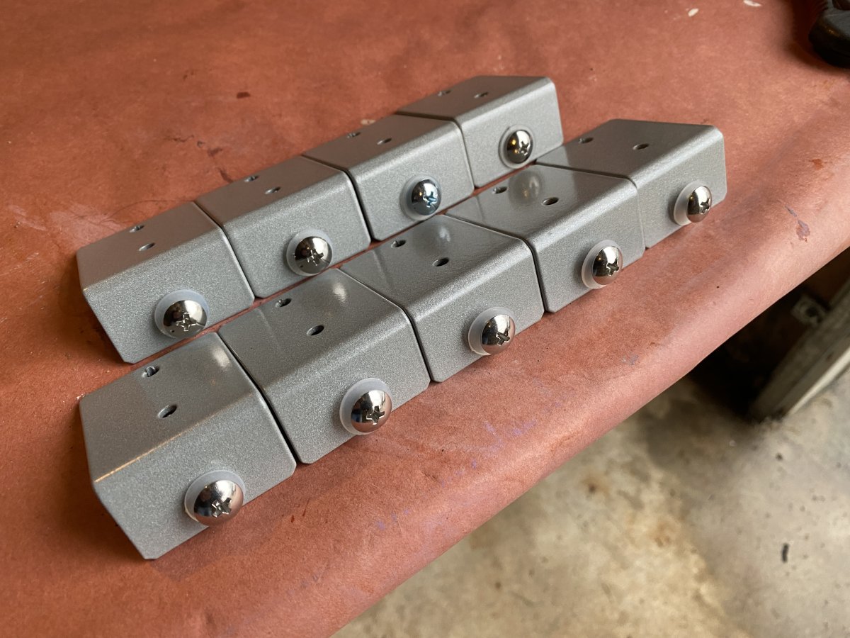

In the mean time I’ve matched up some new hardware and nylon washers with the brackets that hold on the back panel. One of them was stripped so I’ve tried using Araldite to hold a nut in place. Hopefully it’s strong enough that I can just nip up the screw. If I’d known earlier I would have had a nut tack-welded to the bracket and powdercoated over that. The other option is to cut an M6 thread in it (was M5) but that would mean drilling a bigger hole in the nicley coated back panel and using an odd-one-out screw.

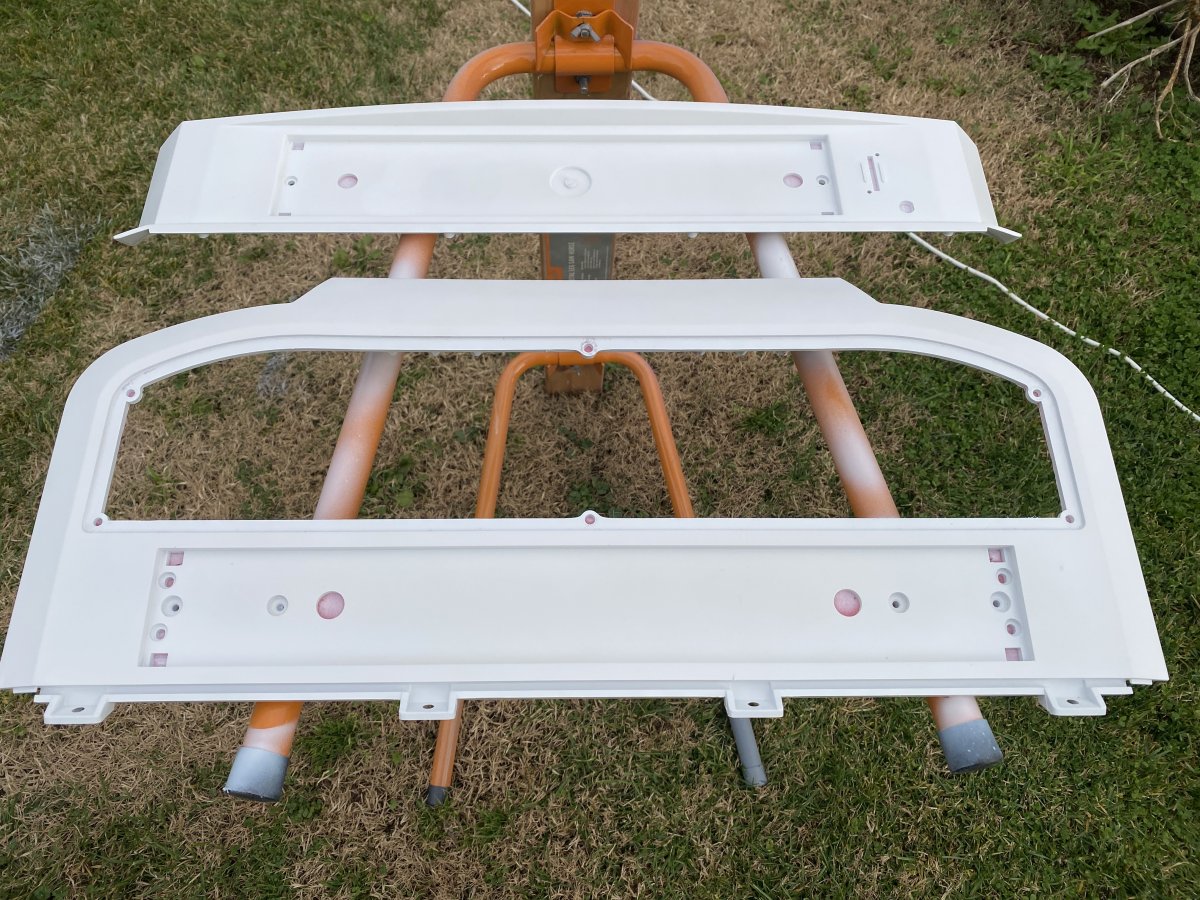

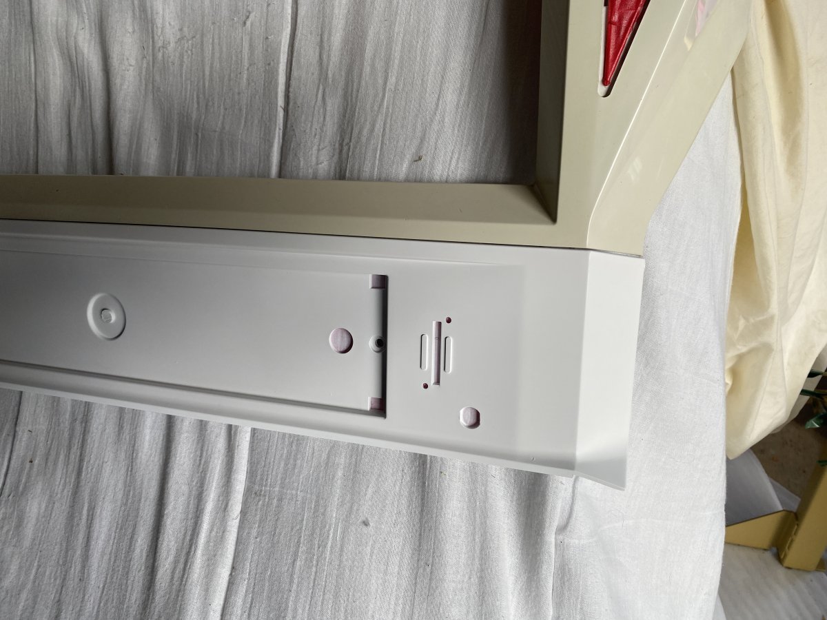

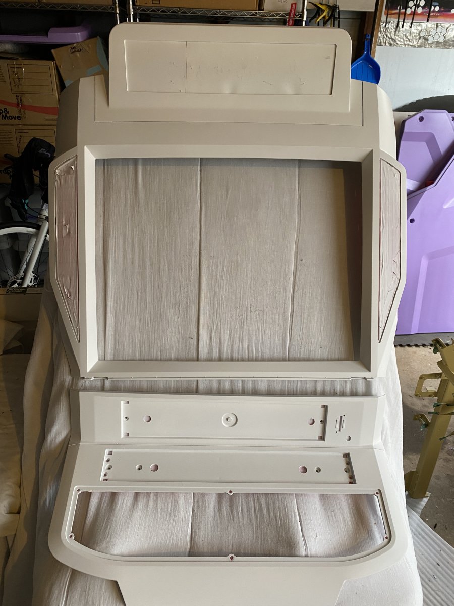

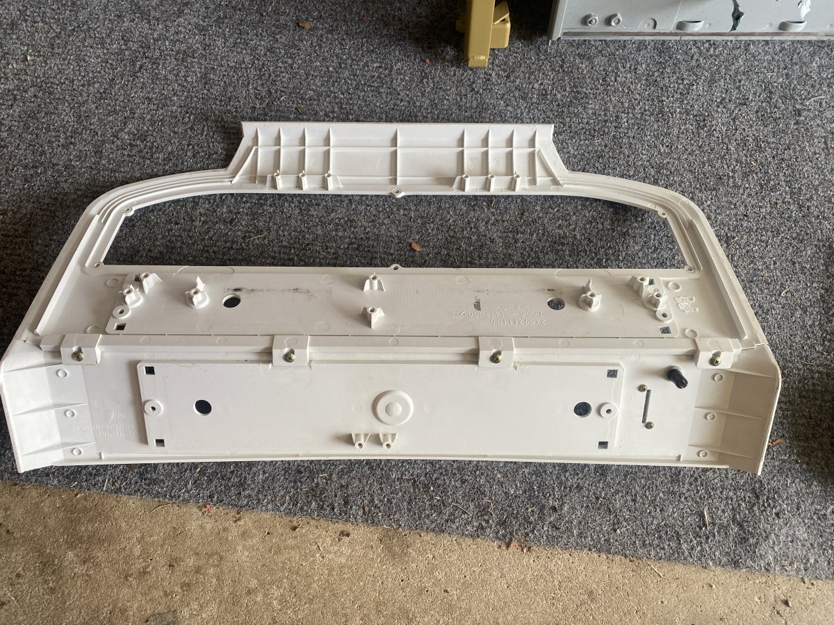

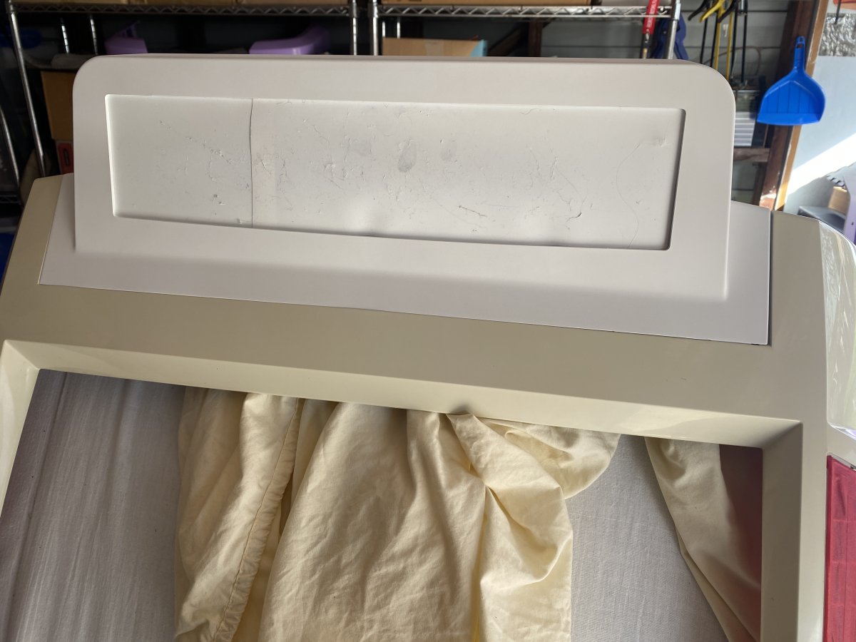

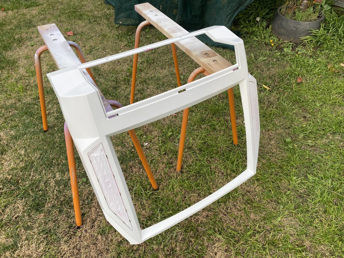

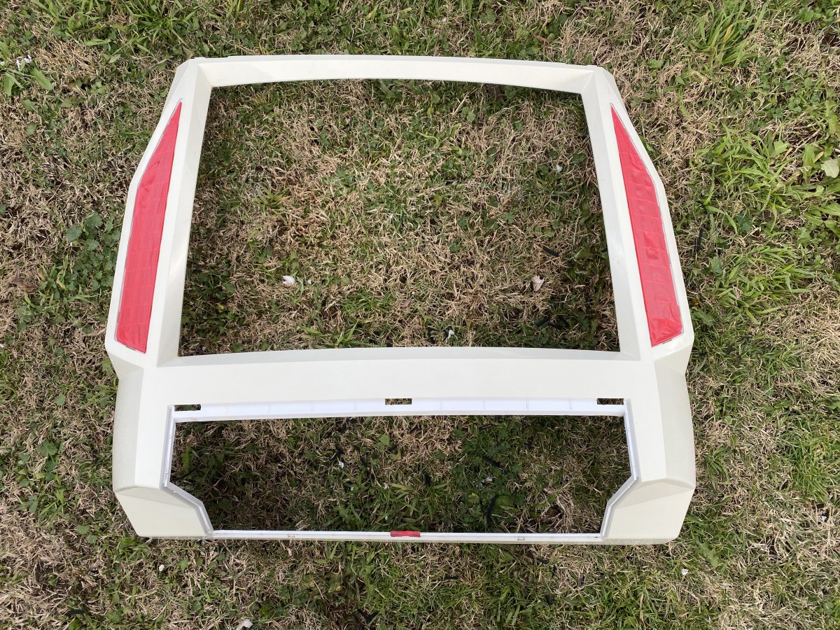

Well after some soul searching and research I’ve compromised and painted the white plastics with VHT Vinyl Dye. It’s 98% easy to work with but a few drips here and there have challenged me. Even a rookie error of bumping the bezel with the can as I was spraying it left a scrape that was hard to spray over. Ultimately though it looks very nice. Not glossy but a nice sheen that I’m content with. Thanks to @twistedsymphony who alerted me to this method.

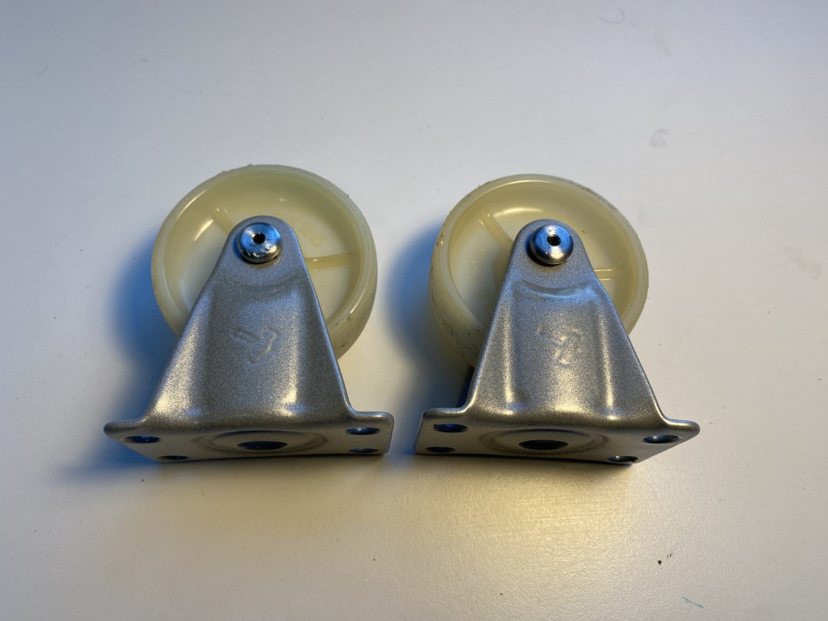

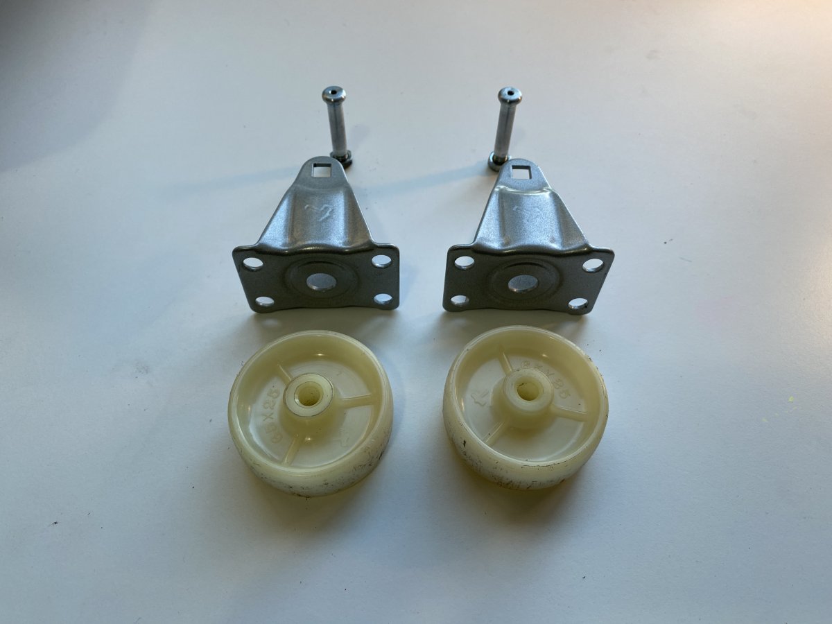

Here’re the wheels cleaned up and powder coated from the original raw metal. I wouldn’t mind some softer skateboard style wheels as these ones are really hard on hard floors, but they’ll have to do for now.

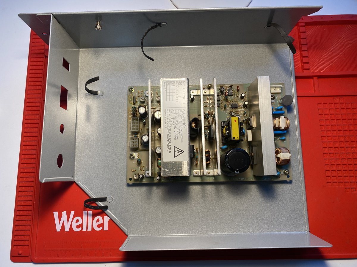

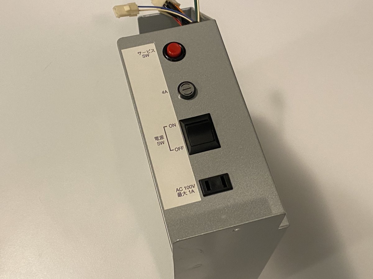

I’ve cleaned all the wires for the power supply and remounted the board in the enclosure. Also added a repro decal.

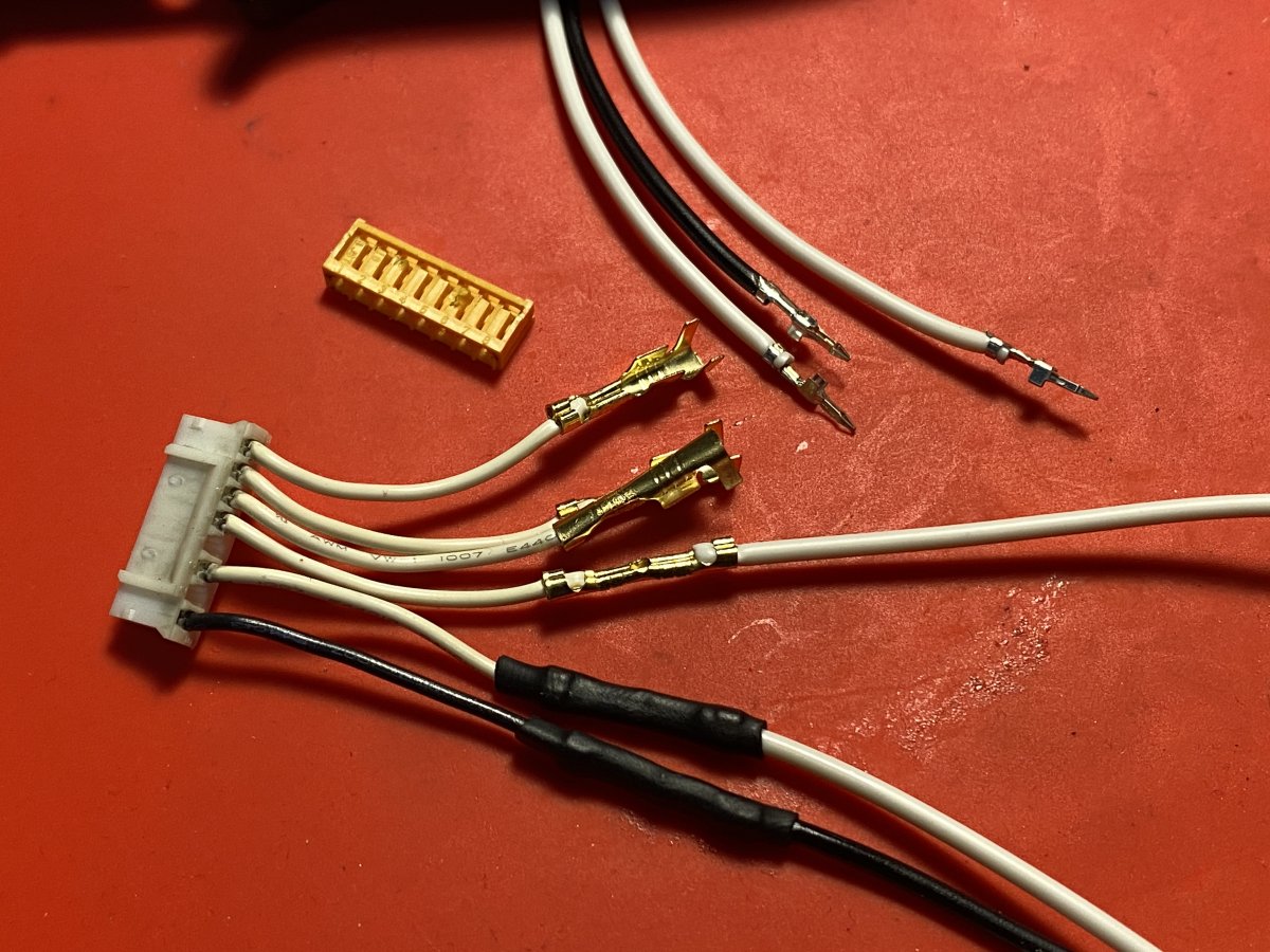

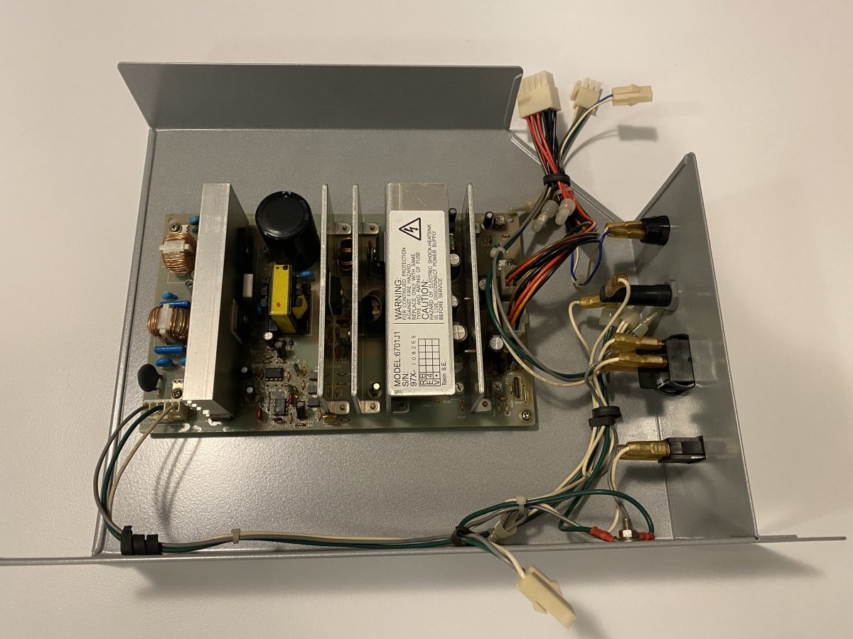

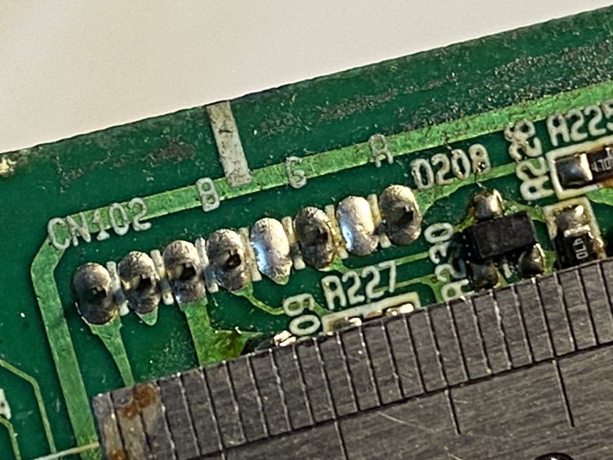

I’ve continued to work on repairing the chewed wires from the chassis, but realised the connector I got was the wrong type. I have now ordered the right type and matching pins. This was an expensive exercise but the bits I have may come in handy one day. This pic is of the old yellow connector that I could still use and the wrong pins I just crimped - although I can’t tell the difference when holding them next to the originals. I’m concerned though that when the time comes to solder them to the board that I’ll have trouble not bridging the connections. The board pic is of a spare parts donor MS9 I got from JoMac.
