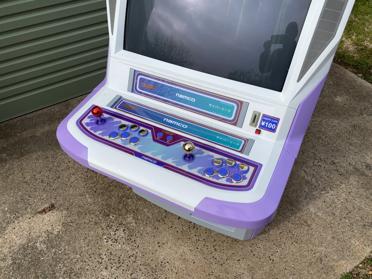

I’ve plugged in the VGA cable directly from the Mistercade to the chassis. I also did more monitor tweaking. I’m sure there’s more I could adjust but it’s good for now. Here are the final pics in daylight. The lighting for a lot of my pics hasn’t been great I know. Those drip marks on the monitor are clearly visible. I’ll see how I go for a few months before deciding to leave it or polish them out.
Ooof! And finally got it back inside again. The path from the garage to the house is rough and I’m praying the shaking doesn’t cause any issues. But we’re all good. The stereo sound on the CPS games is unreal. One speaker is still slightly louder than the other. All that’s left is for a slightly redesigned marquee to go in and to make a kick harness with parts that are on the way.
