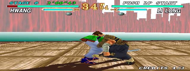

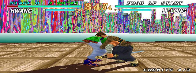

Not completed, need a fix for Li longs stage
edit 2:

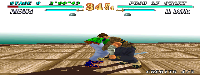

Color fixed but still no fog in stage.
For soul edge, i think the protection is Li Long's stage.

You are right, seems there is an interpolation color routing for Li longs stage, need investigations....

i dont know how to solve fog problem, if you can help file are updated.
Problem is how to find what control fog in stage.
I'm really bored of trying to solve a simple fog problem.
