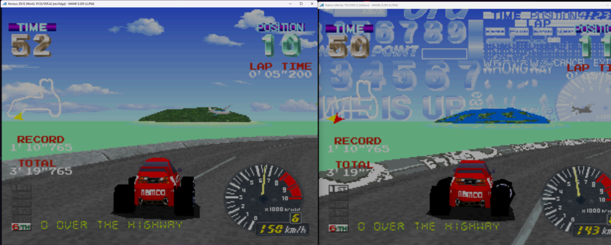

After a fast test on board i find out this pins:Excellent! i think the protection was used on screen transitions. Will be interesting to see how you did it!
