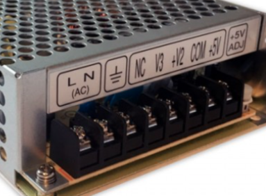

Thank you for the reply,
my PSU looks like this:
Do you mean connect a wire from GND to COM?
