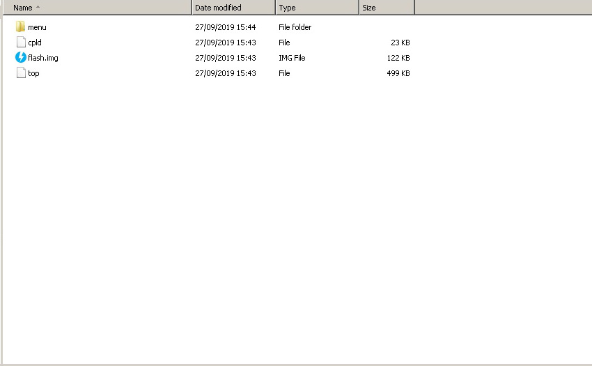

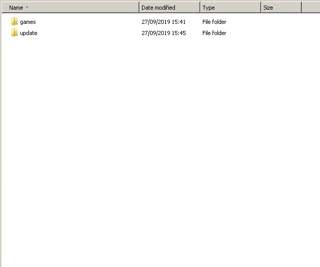

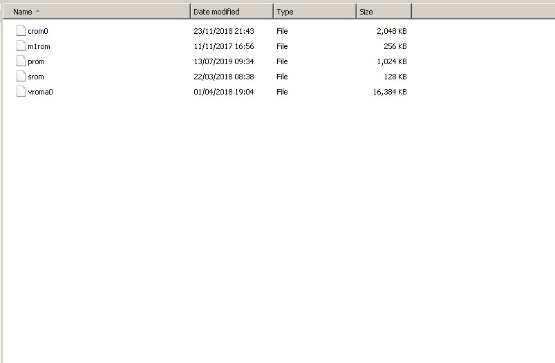

The root of your SD Card should look like this
The update folder should look like this
And the menu folder within the update folder should have these files
That should update your cart & menu, if that doesn't work then I don't know what else to suggest.

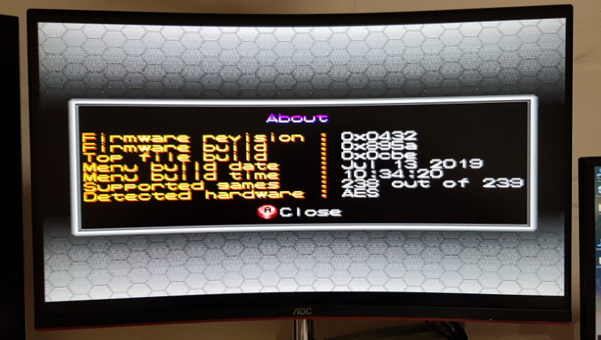

Hi Pharfetchd,
Thanks for the guidance.. I had the cart up and running.. still exploring though..
May I know Is the firmware and menu the latest version?
Glad you got it working, yes I believe that is the latest version of both the menu & firmware, it matches what I have on my cart anyway.
