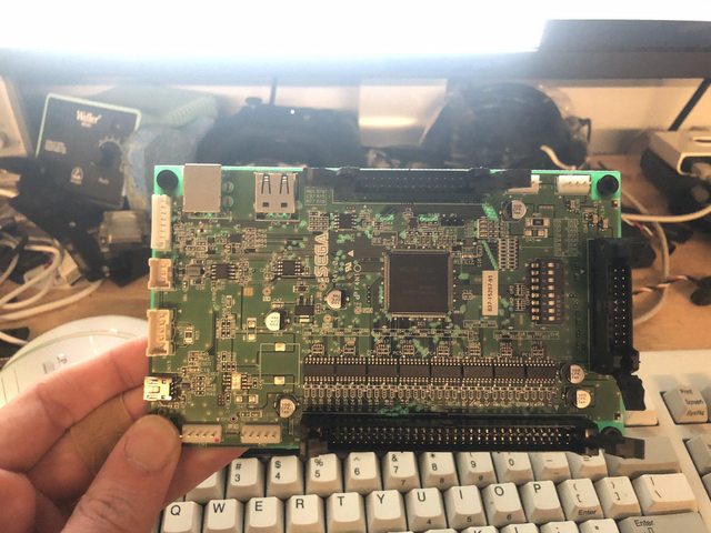

I actually have a new Sega IO that likely brings this issue back, I suppose I can test it :)

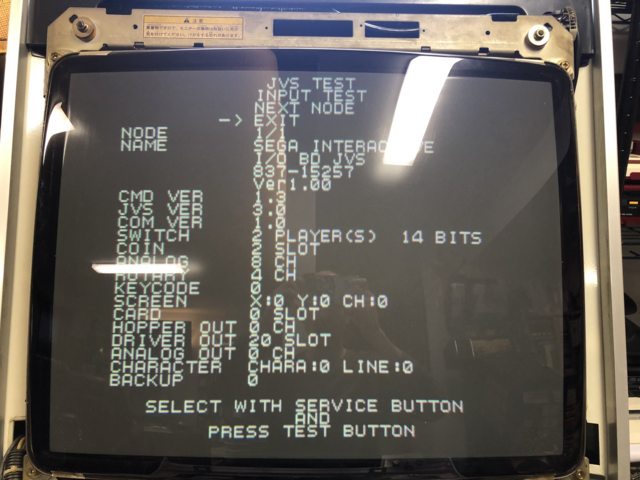

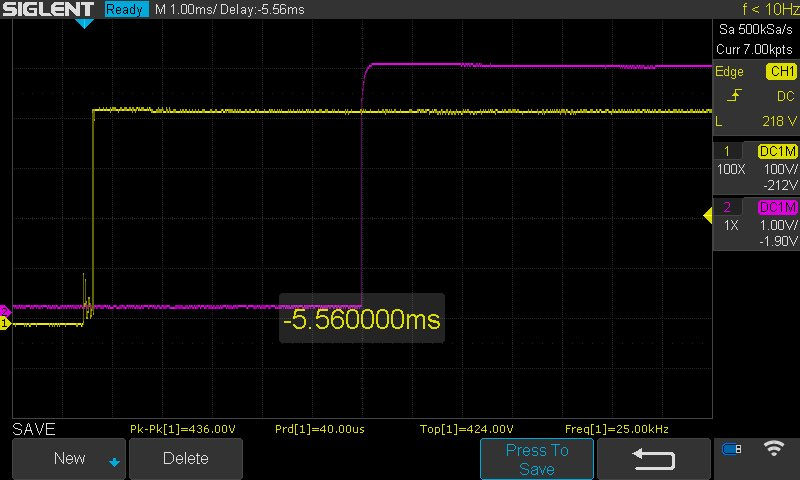

Sega 837-1527-91
It's around 4-7ms on average for latency
