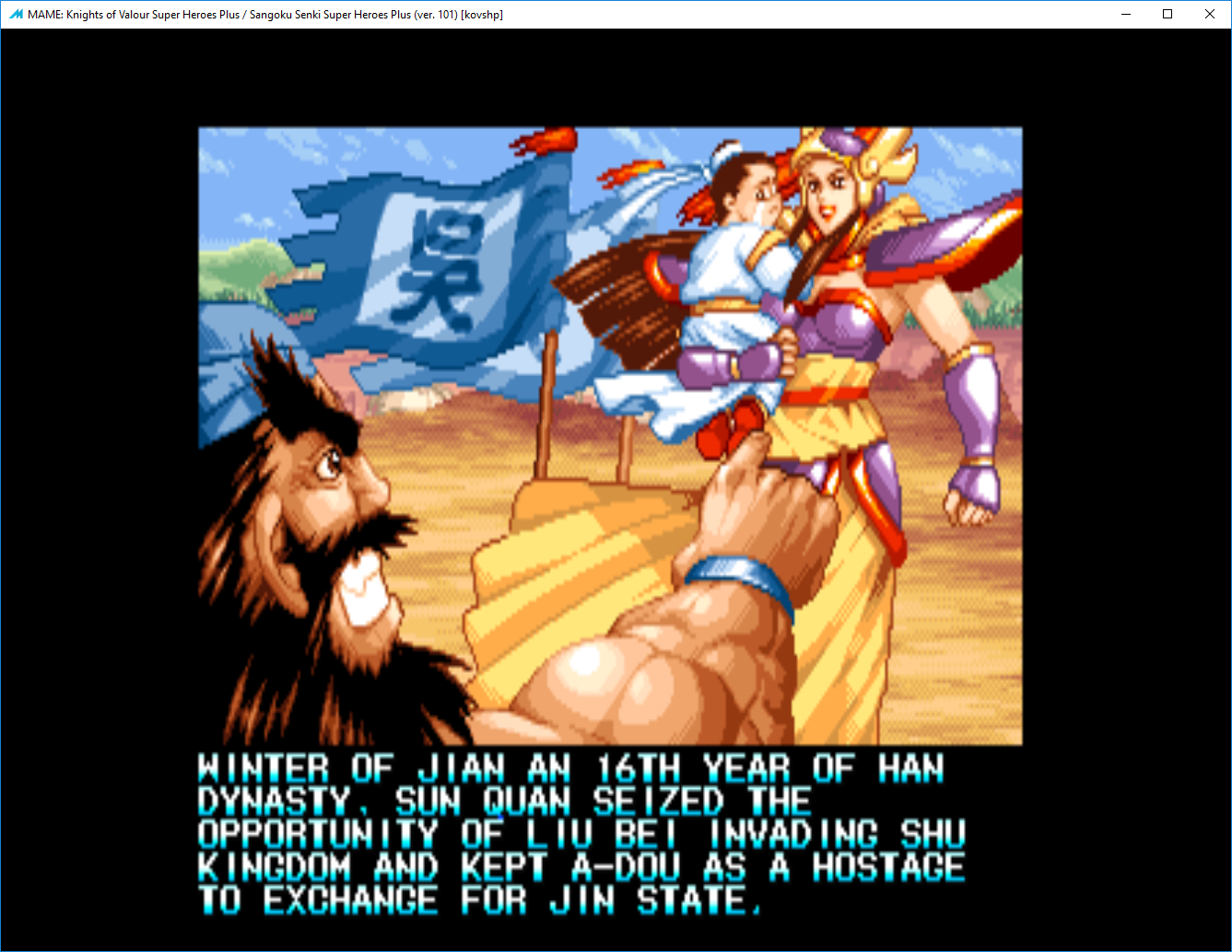

In MAME with the hack the in game story text is English, but there are still places in the menus with Chinese where there is no English translation available. Not much that can be done there unless someone wants to try and translate the Chinese only text. I assume this would act the same way with an "overseas" / World official cart, but I don't even know if any exist TBH.
Does the in game story show in English for you with the hack? Here's what I see in MAME (image attached).
Hah! I am mildly embarrassed to admit I had just thrown it into Option 2, assuming that Option 1 was some sort of abbreviated mode (like it is on at least 1 of the other versions)... Option 2 seems to be Boss Rush mode. When I loaded up Option 1, I saw the English story that you had attached there... plus "Vitality" and "Score" at the end of a Boss Rush round is in English.
