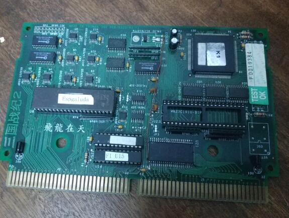

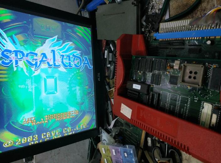

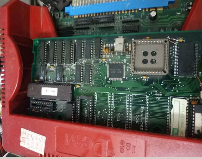

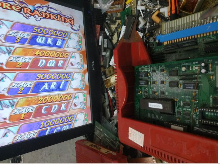

pcb -333 334

Hmm, he hasn't modified the PALs there either.
I'm glad I picked up the Killing Blade cart so I can do the Espgaluda conversion, but what witchcraft is this that @lydz has achieved
My Ketsui conversion on KoV2 doesn't even work :(
I have also not had any luck yet with the KoV2 cart. The KoV2 - Nine Dragons work fine. I tried to trace the PIC on the working and non working boards but I have not been able to find a pattern there.
