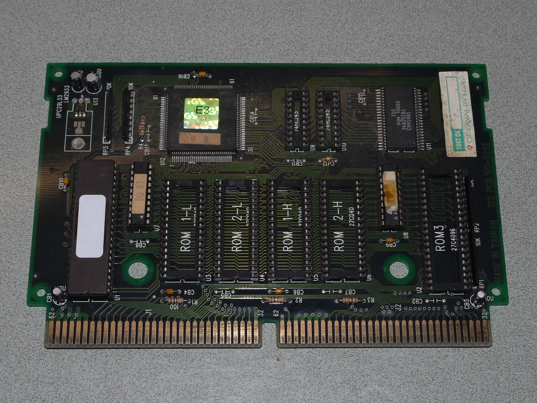

Can anyone here put up pictures of the compatible ROM boards for the Cave conversions? I have a regular Knights of Valour cart that looks like this:
Would like to see how the compatible boards differ.
On a side note, this cart can be upgraded to Knight of Valour Plus just by burning a new U1 rom.
Thanks for the tip! I've been looking for a plus version...
