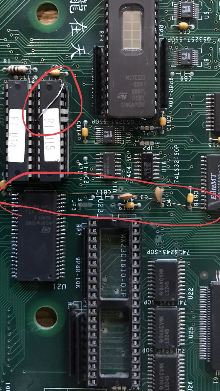

aside from the 3.3V wires the only modifications seem to be on one of the PALs
it looks to have 2 cut pins and 2 sets of jumped pins (one with a wire over the chip, one on the pins on the underside of the PCB)
there is also 2 pins jumped on the program ROM.
I think these are the exact modification listed by Apocalypse earlier in the thread.

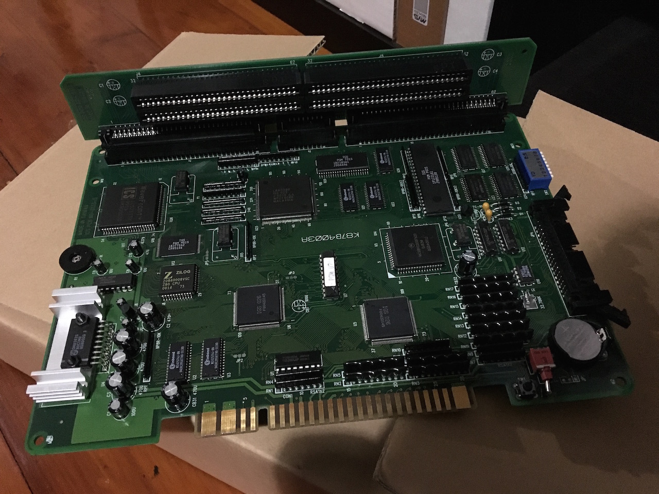

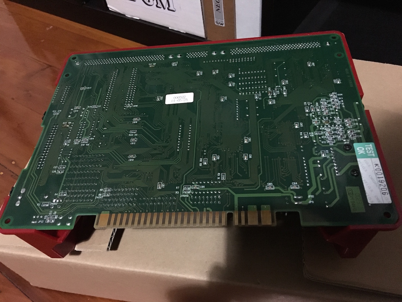

and also some pics of the v3 motherboard I got, but there seems to be some sloppy soldering done around the battery holder, so is it a original v3 or just a v1 or v2 with a coin cell?
Check Any PGM Conversion info out there?

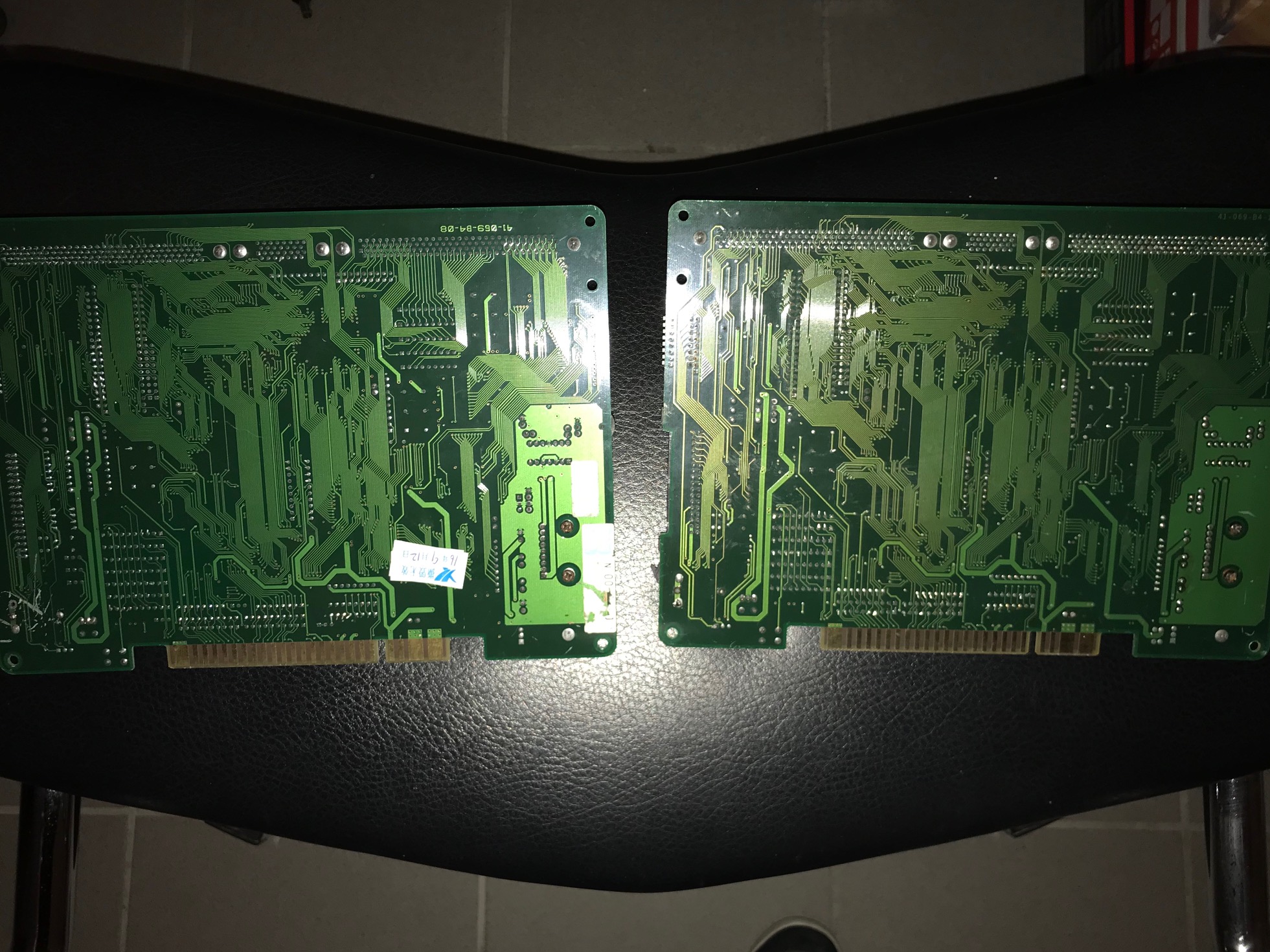

The underside of the board, that area that's either all blocked out or not (upper right on the picture), that's going to be your surest way to tell if it's v3 or not.

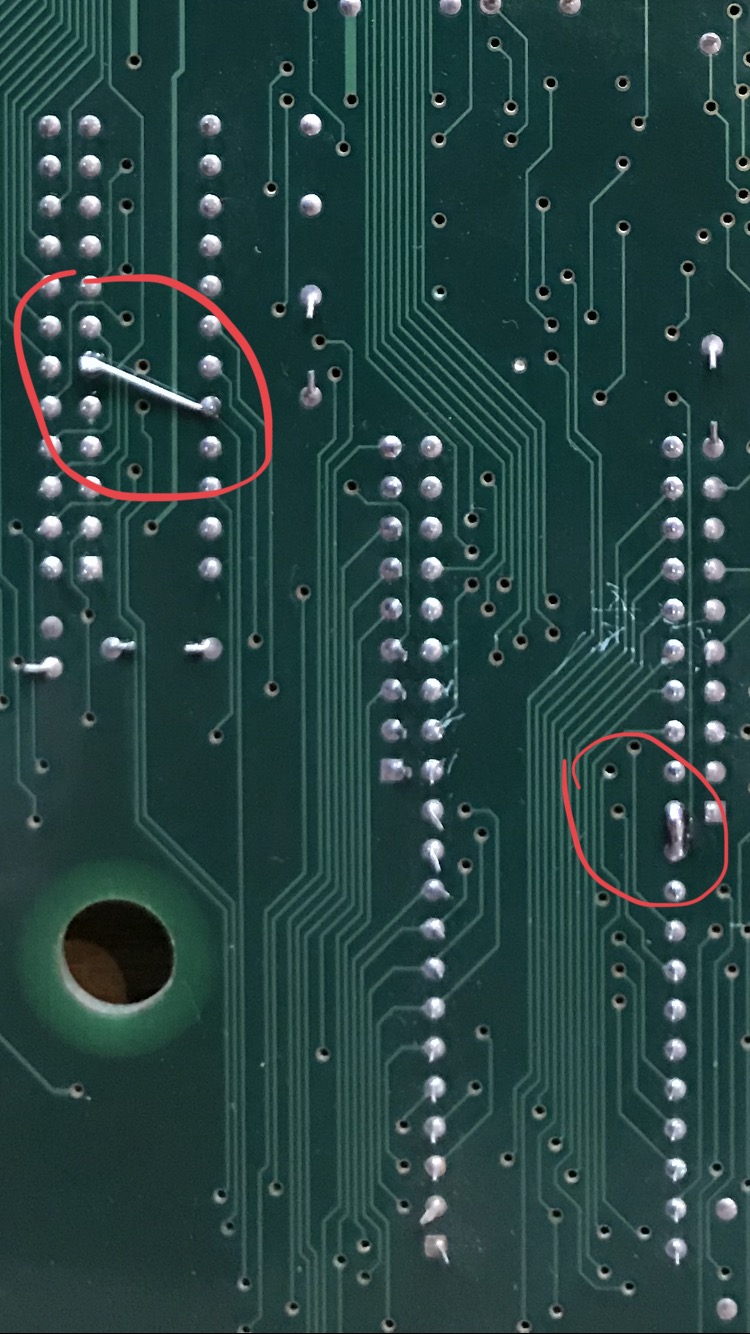

Here is a close up of the bridges and jumper wires I see on it.

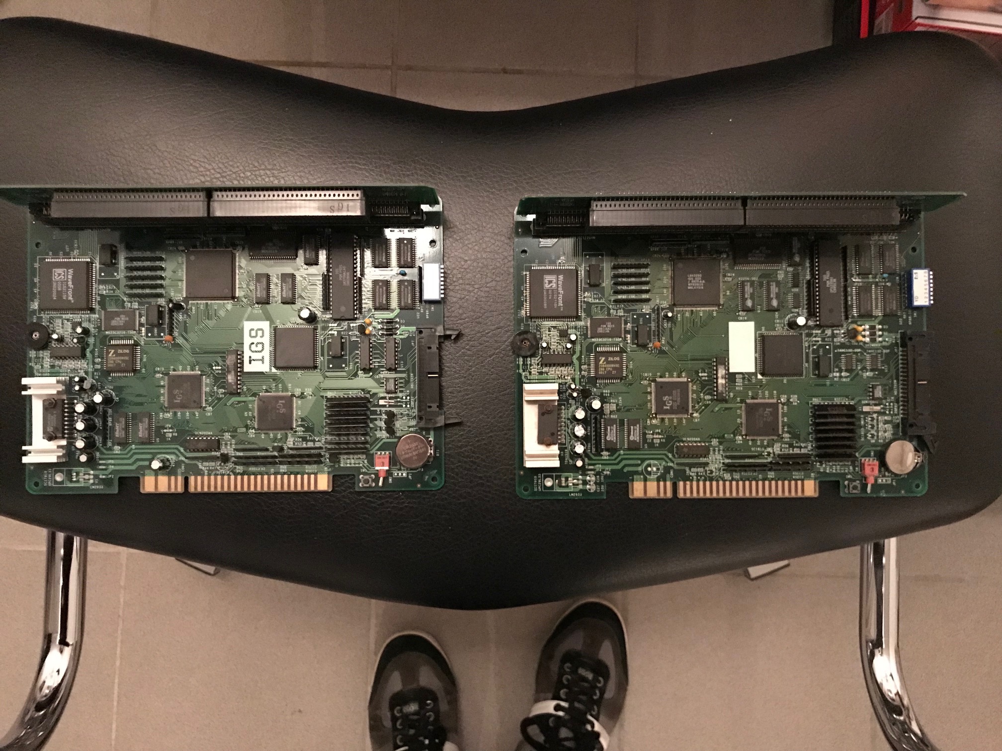

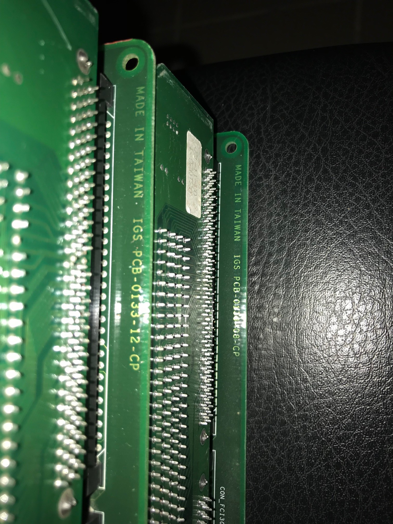

Can you identify these then?
The one on the left is one I modded myself with a coin cell holder, the one on the right is the v3 I got from sheep with the coin cell installed, both look identical to me, besided the one I got from sheep says -12 in the PCB silkscreen and my ‘old’ one -8

Ill snap a picture of mine when I get home tonight. I bought this board as non working and it sure as shit wouldn't boot when I got it. I put in a new coincell and it fired right up. I've heard conflicting stories about wether or not the board requires the battery to boot carts and tbh, I've never checked the theory personally. Maybe I'll give that a whirl tonight as well.
Checked my board last night and it had a battery carrier and no battery... never had any issues booting games. ¯\_(ツ)_/¯
The first board I got had no battery, no battery holder, no nothing and it works just fine. Now that I think of it, I haven't checked the second one I got...
I'm only talking V3 motherboards. I know for a fact the other two version work without batteries and Twisted confirmed it holds true on V3. I'm not sure what possibly changed in my V3 that made it start working, but it's been flawless since I put that battery in.
I don't know if mine is actually V3 or not. Everyone was saying that the battery holder was for V3 so I looked for that. then it became... some older ones were retrofitted so look for the circular silk-screen, so now I have to go back and recheck :P

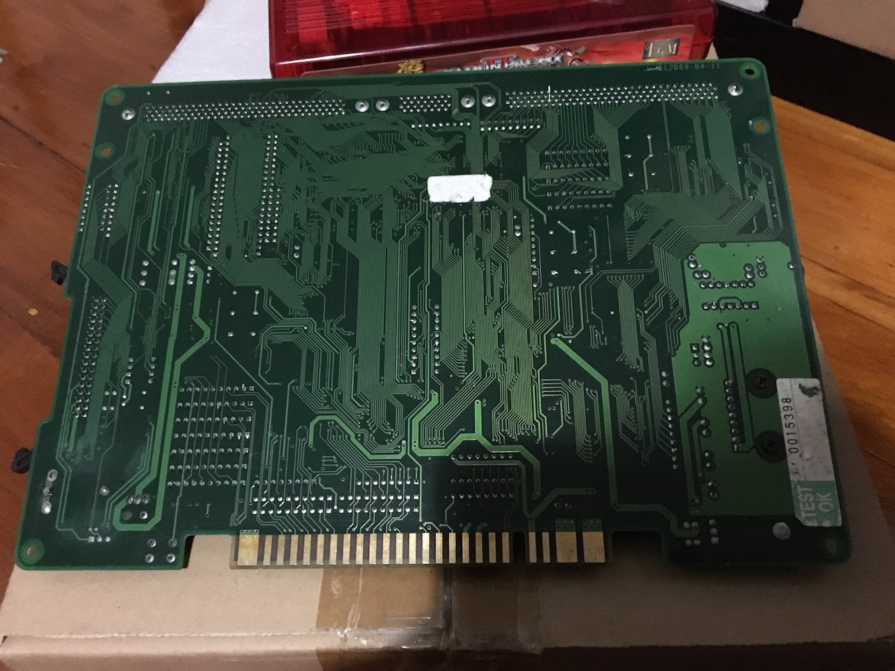

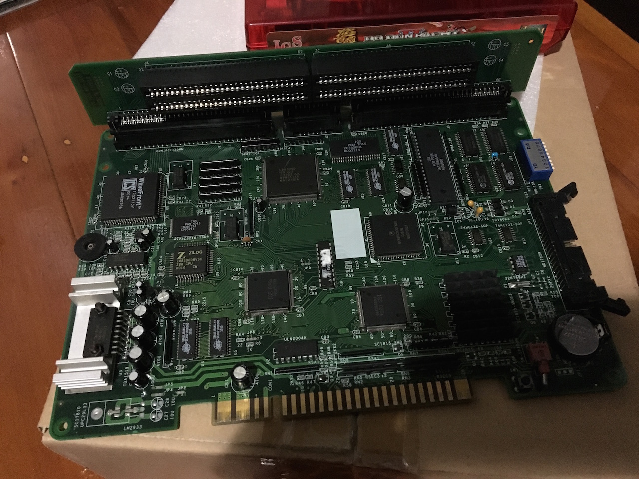

For reference sake, I dug out both of my DDP2: Beestorm kits because I knew I kept one of each motherboard in there in good condition.
Here's a NOS Revision 1 with a replaced battery from yaton:
And here's a Revision 3 motherboard from sheep_nova:
From memory, the Revision 1 motherboards that I tried froze on some games. I believe I sold my Revision 2 motherboard to @Derick2k if he has the time to check?
These pics are all from a KOV2 nine dragons. This is the same mod described earlier in the thread here, the only difference is they're tying pin 24 (5v) to pin 5 on U15. They bridged pin 31/32 on U8 since there's no switch for Arrange/Original.
