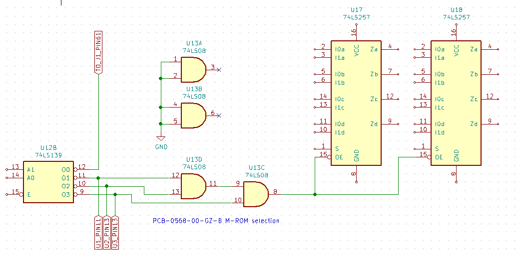

Ah, ok, looking closer that board uses two 74ls257 quad multiplexers to select the low and high byte, which is a better choice than wasting half the ROM space. :) Do you have any idea what the 74ls08 is doing?
By the way, I traced the M-ROM connections from the sound chip. No exciting revelations, except that (as expected) I need to add 1 to all address lines to match the chip outputs, and the highest two address bits go into the decoder.
Here's how it's routed:
1 - gnd
2 - gnd
3 - ?? (nothing?)
4 - gnd
5 - gnd
6 - ?? (nothing?)
7 - gnd
8 - U18 Pin 15
9 - Pin 11
10- U12 Pin 9
11- Pin 9
12- U12 Pin 10
13- U12 Pin 9
14- +5v
74ls08 is a quad AND gate, so 1-6 disables gates 1+2.
gate 3:
8: Does that go to U17 pin 15 as well? That enables the multiplexer.
9: I assume that is U1? That would be the /E line
10: is 2Y3 of the decoder
gate 4:
11: That is A1 of the ROM
12: That are 2Y2
13: and 2Y3 of the decoder
So the first gate is easy, it enables the output of the multiplexers when the ROM is enabled. The second maybe interleaves two banks? I'll have to check the mame driver tonight if there is any special handling for that board.

New version:
That makes more sense! So if O0 is selected O1-O3 will be high, which means the multiplexers will be disabled. Otherwise the output for the selected bank is low, which means one of the AND gates will output low and enable the multiplexers. As before, it is possible that O1 and O2 enable the two empty footprints and O3 is unused.
On a custom board that needs to support only one ROM you can leave out the AND gates. It is probably even possible to just use an 74ls04 inverter instead of one of the 74ls139, but that just saves 20p and you lose a bit of flexibility if you want to add a second or third M ROM bank.
this is as much as I could work out of U12
I couldn't trace 6 and 7 there are no visible traces to the pins, it's possible they don't go anywhere.
Yes, that is quite possible. That is the 2nd decoder in U12, and probably used for the two B ROMs.

pin 2 left solder side (pin 61 in my schematic, and I've got the connectors on top) is probably to select a ROM on the main board.
pin 14 and pin 15 left solder side (pin 49 and pin 48 in my schematic) are MA22 and MA23, the highest two address bits from the ics 2115 sound chip.
