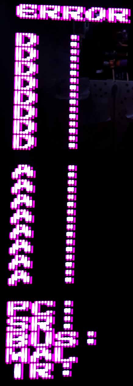

Can't manage to get white label to boot at all and instead I just get this error message. Black label boots and plays fine though.
EDIT: After rebooting the board a few times it seems to be working on my setup now. Unsure as to what was causing the errors, maybe some data stored in NVRAM?
From what I've played so far both versions seem to work 100% :) . Well done to all that contributed to getting this working!
I get the same error on my sheepnova cart using the KoVSH donor. Resetting it a few times did nothing for me. If I let it time out sometime it will pick the black version.
I also played with the dip switches a bit, try flipping dips 2-8 on and see if that effects anything. Otherwise I have no idea why mine suddenly started working.

I took the battery out and did a system rest. The white version only load sometime and when it does it's missing text. The high score table and in game. Black version seem to play fine. I will have to do some more testing when I get home from work tonight.
PS how do you clear the nvram?
To clear the NVRAM you need to press the brown toggle switch to the right of the JAMMA edge while the board is running.
From experience, at least with the Cave PCBs this wasn't necessarily the case. Most of the time it would leave spurious characters in the NVRAM.
I found the best way for Ketsui was to factory reset from the test menu and for DaiOuJou was to enter coins and press start during the country warning screen. I never experienced any issues with ESPGaluda.
On my setup if I boot the Black version 1st the do a reboot I can load the white version. Else I have to coin up at warning screen to load the game and get pass the error. The free play dipswitch does nothing. It register in the dipswitch test but not in game. for now I will have to tell people to coin up right away
You either have obvious nvram damages
Or the game settings were never saver there in the first place.
Do you have a battery on the board?
