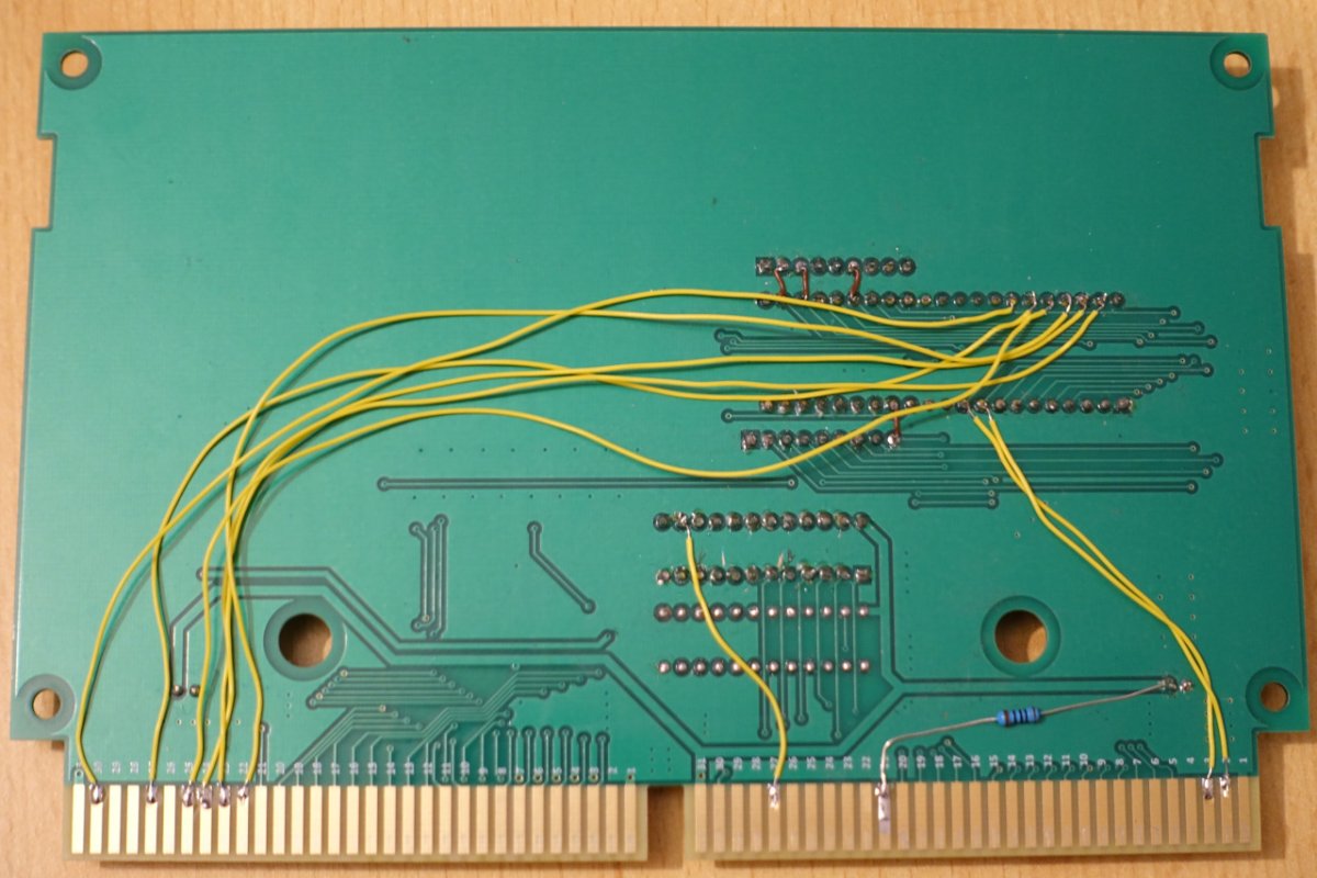

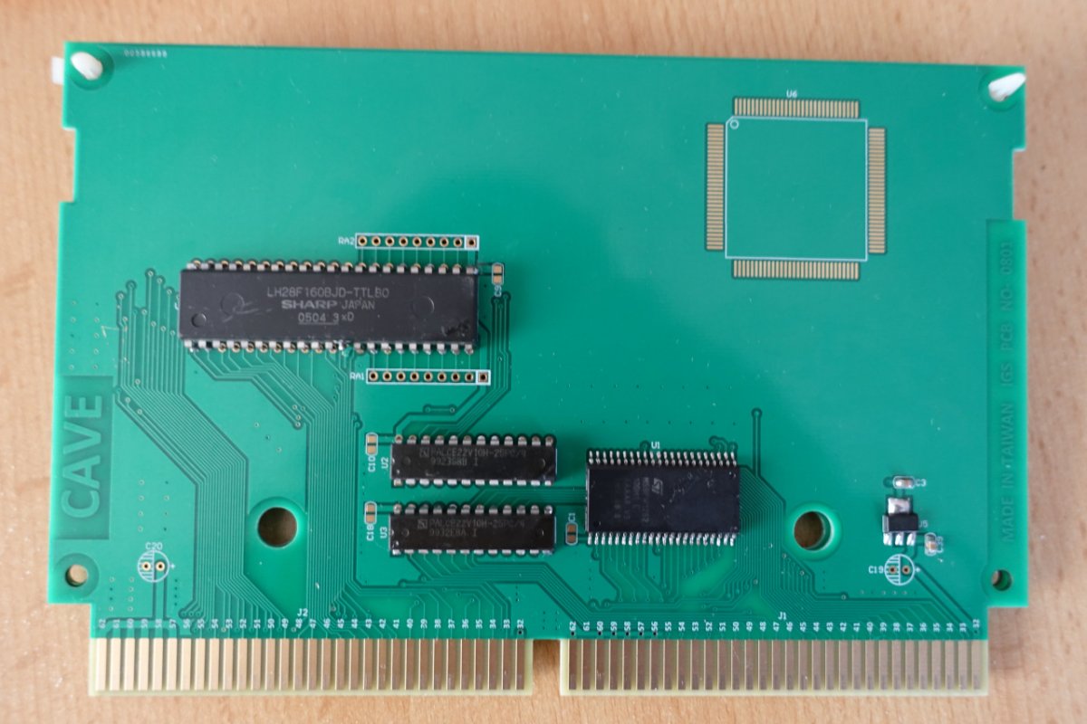

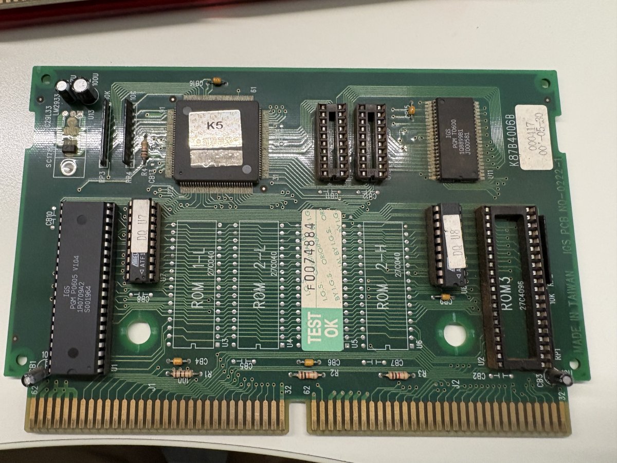

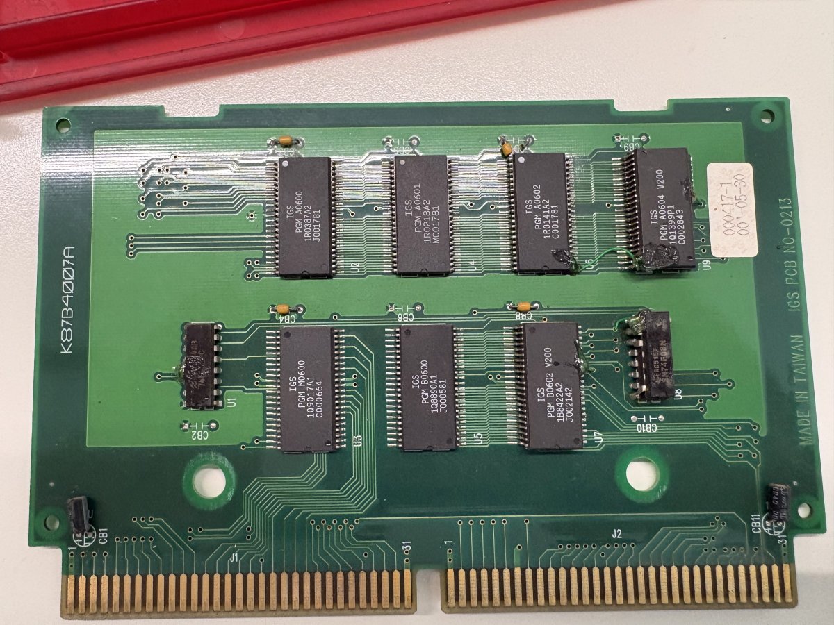

I found these posts interesting, because I seem to have the same problem - got a Ketsui bootleg that looks similar to this one, and it just boots into green garbage:
I bought it like a year ago at this point, but I chalked it up to my shady aliexpress PGM motherboard since I didn't have other games to test it with, but I since tested it on an original PGM cartridge (Knights of Valour Plus) and it seems to work just fine, so I'm starting to suspect the cart. Here's the pictures of the boards I have:
There is one major difference though, mine seems to have a flash chip instead of an 27C322 EPROM (it has a wire from the middle pin on the bottom row to the top right pin, it's hidden under the chip), and corresponding resistor arrays are not populated. Also, I don't have any electrolytic caps on my boards either.
... so basically, I'm strongly tempted to try and attempt a similar repair myself, I have a T48 programmer now (which should handle the GALs if I'm reading it right, and it should handle 27C322 with an adapter I also have if that ROM is bad), but maybe someone else has another suggestion? Or is there something else that seems iffy on my boards? Not gonna lie, it would be kind of replicating Softdrink's repair blindly (unless I do some serious reading up), but I'm curious if you guys think it's worth trying.
.. and before you ask, yes I tried contact cleaner on the cartridge slots, isopropyl alcohol on the contacts, wiggling and resetting, nothing really makes that cart boot (and kov plus boots every time no problems).
When the cart is not booting, the issue should be on your top board. So either the PLDs or the big eprom i guess.
Right, but as far I understand the previous discussion, I think no one actually has the GAL dump that is correct for this particular bootleg, so I would have to bodge in some wires to use the GAL that Softdrink used for the repair? Or has that changed since then?

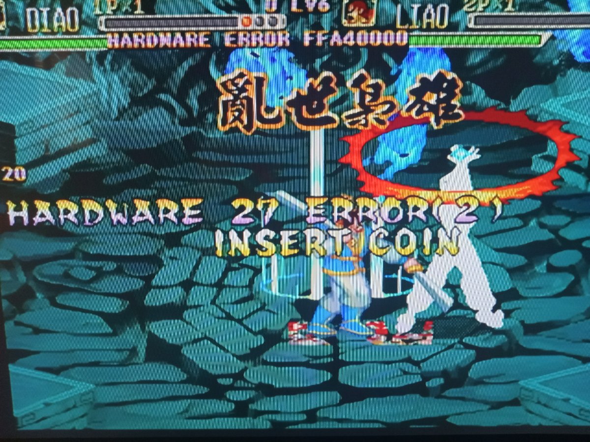

hardware 27 error 2
Comes up world version and story, names, and highscore input is in english. After about a minute into demo or in game play I get this error. I've burned it several times with same result on two different eeproms. I've run the X delta against the mame rom same result everytime.
Original Chinese v100 works fine. So no English text.
Unfortunately by the time people need a replacement GAL the original is fried...
Well, that makes sense. I attempted a repair today, starting with easy stuff (missing capacitors, pullup resistor, then swapping the EPROM and populating the resistor arrays) and none of this made any difference, the only thing I didn't do is the new GAL (don't have the new chip for it yet).
I did actually manage to desolder the one on the cart (PALCE22V10H) and attempted to dump it with my T48 programmer but I was unable to - when selected the "GAL22V10" mode it just returned an "overcurrent protection" error, and when selecting "ATF22V10" device it just returns all "1"s, but I've never done this before so I'm not entirely sure I know what I'm doing :P One more thing pointing to a fried GAL is that out of curiosity I tried the cart after I desoldered it, and the pattern of garbage on the screen looks the same to me.
PAL/GAL have a "protection fuse" that is usually written at the end of programming. While it is set all reads return "1", except for a few signature bytes at the end of the fuse map on some devices that can be used to identify the program.
If the PAL/GAL is completely combinatorial (i.e. doesn't use the latch) you can dump it by treating it like an EPROM. Connect the address lines to the inputs, the data lines to the outputs, then read it. You'll get the truth table for the GAL, that you can then resolve back into equations.
So good news: programming the GAL and repeating Softdrink's repair actually made the cart boot!

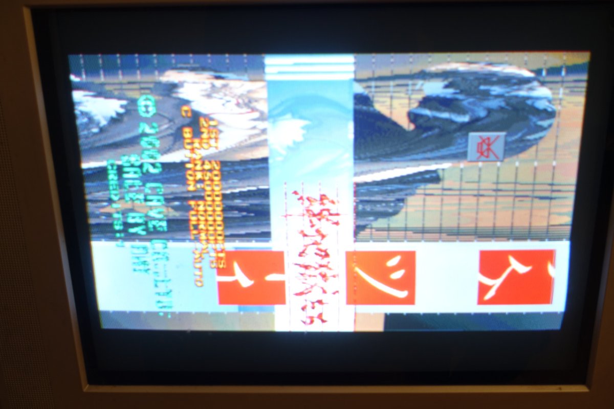

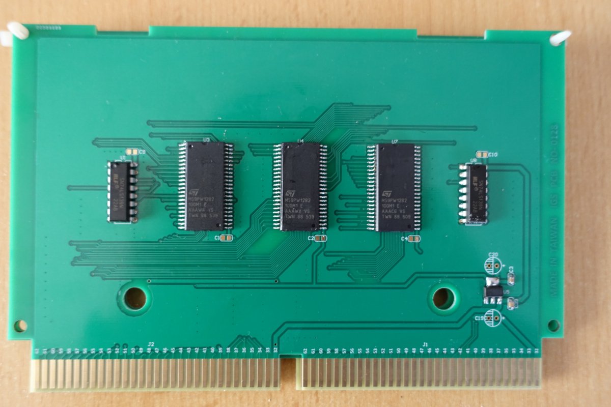

Bad news: I think I managed to snatch defeat from the jaws of victory anyway :P On my first try after I put the cart back together there was no picture at all and supergun dropped to 4.7V which made me immediately suspicious and I turned the power off, quickly disassembled the cart and noticed the bottom board was really warm :P So I'm not sure what happened, I either shorted something or maybe put it in backwards and didn't notice, but after inspecting it visually, checking for shorts and finding nothing wrong I risked booting it again and it actually did, but graphics and sound are garbled:
So I'm guessing I damaged the bottom board, adding capacitors across the regulators didn't change anything.
Well I think that was fun and I guess technically I improved the cart since it's actually playable (just an assault on the eyes and ears), but that may be the point where I give up and consider this a nice donor shell for a proper reproduction (anyone have Fluffy boards for sale? :P) Unless someone has other suggestions to try.
For the sake of being thorough, I'll mention that I gave this cart another go today - I thought that maybe there is a chance it's just those 74LS139N's on the char board that went bad so I soldered in new ones today. Sound was improved (it was recognizable now, just a bit scratchy), but sprites remained basically the same, in particular that distortion of the guy's face on the title screen looked identical so I concluded it's unlikely this is anything other than damaged flash chips at this point - this cart is officially dead :P Maybe I'll use it as a playground for testing my new hot air station I just bought...
That sounds suspiciously like bad memory, either a dirty slot connector, bad soldering, bad power, or failing chips. Specifically I'd look at the "B" roms, which store the sprite mask. IIRC that screen is a huge sprite.
