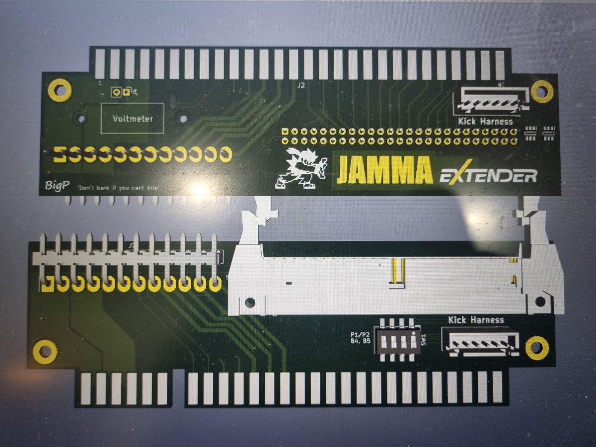

@Frank_fjs extender cable did me well for many years but recently I have been working on an update. There were a few things I wanted. As I typically use these in a multi multi situation I wanted the ability to carry a kick harness, the kicks condensed on cable and voltmeter mounts. With enough pins to look at also carrying a DS multi selector at some point in the future.
The initial plan was to just update Frank's extended but I could only find gerbers so that plan went out the window. Nevertheless it is heavily influenced by franks design. Still playing around with it but this is how it looks atm. Final version I'll make in black soldermask with an ENIG finish.

Frank (or someone else) actually did update his extender for kicks. I have the gerbers somewhere because I ordered the blanks and made a few for myself that I still use.
Not trying to discourage you because a lot of people will be happy to have your solution available.
