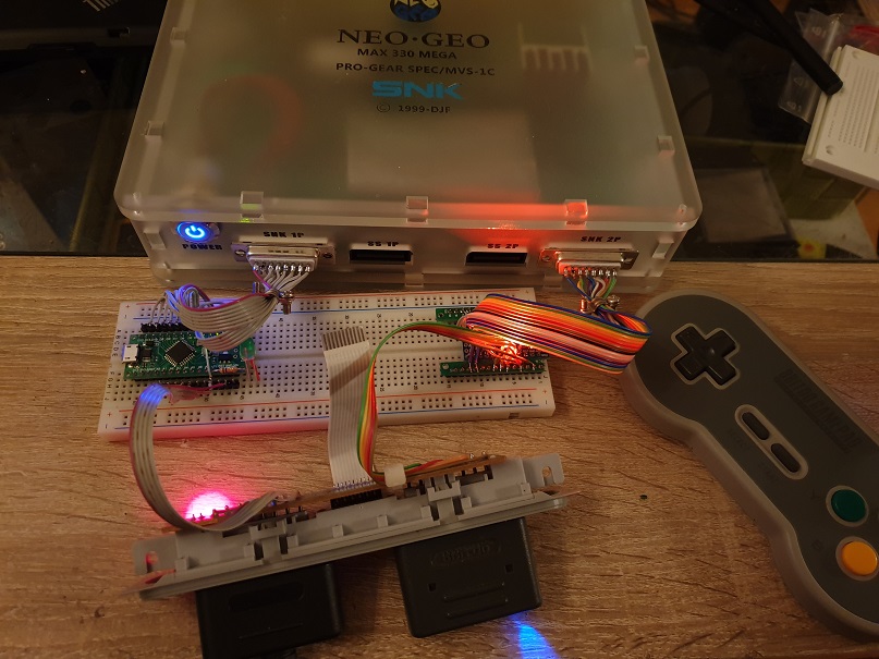

Hi @Arthrimus.
I flashed your sketch for the SNES adapter on an Arduino Nano. Only temporarily soldered together to test it. My setup is a consolized NeoGeo with original cable SNES controller and wireless controller with receiver from 8bitdo. I have already ordered a couple of @Frank_fjs boards.
At first it was not easy for me to find out which Arduino pin goes to which pin of the DSUB socket. Unfortunately, this is not clearly written in your github. So I made a table. I think this also applies to the other adapters. Maybe you can take over the information on Github.
