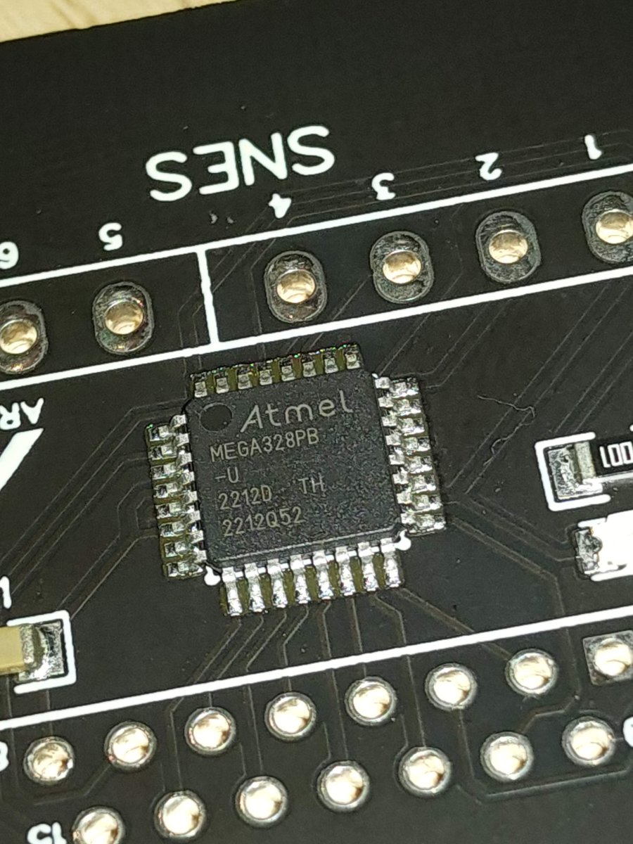

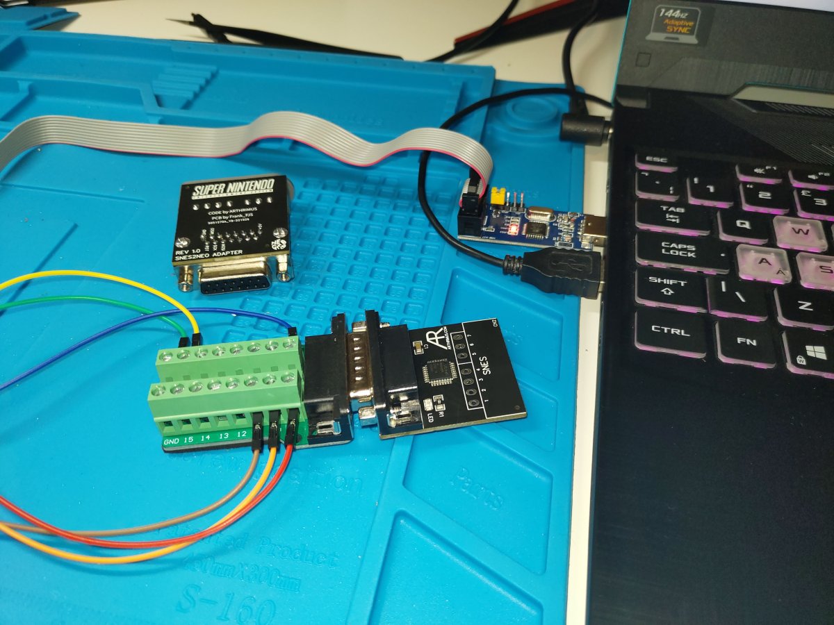

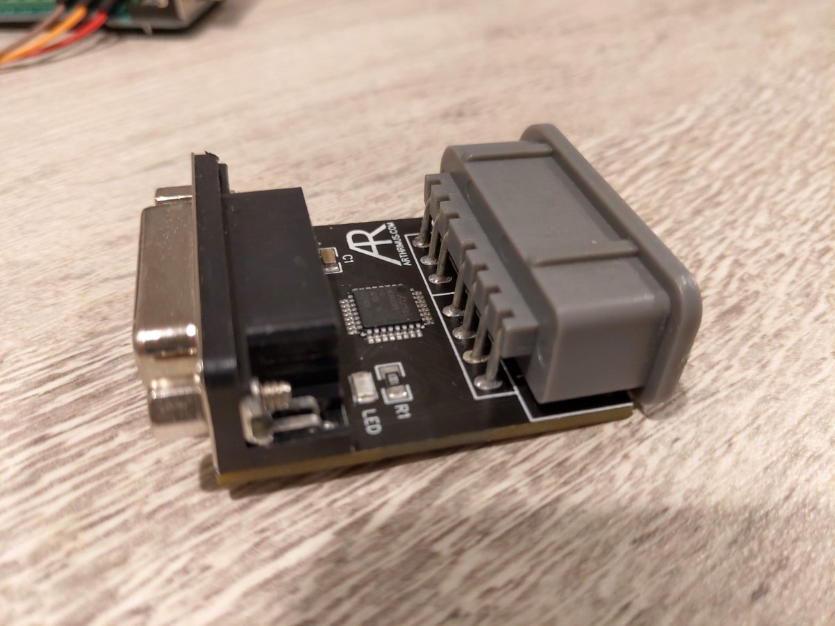

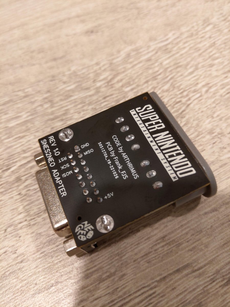

Finally got my snes to neo adapters programmed using the Arduino IDE and the MiniCore package. I'm using the ATmega328PB variant as there was no stock of the 'P' version at the time of my order. Many thanks @Arthrimus and @Frank_fjs for the code & PCB design!
EDIT: Put it all together today, all good. Thanks for all your help, although I've not contributed to the forum much I have gained a lot from your expertise. Cheers!

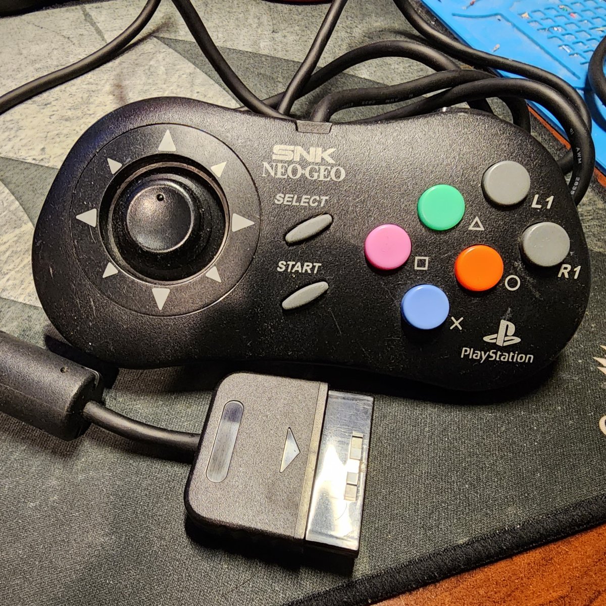

Any chance of the Playstation ones getting restocked?
Also, do you know if they work with the Neo Geo Pad 2?
Yes, I've designed a new 3D printed shell for the Playstation adapters and I am planning to post them as soon as I get all of the product photos finished.
As for the Neo Geo pad, I do not know if that particular controller works because I don't have one and have no way to test it. Most 3rd party controllers seem to work fine but I have encountered a couple that don't behave properly and won't work with my adapter so there's no guarantee.
That's great news!
When you post them...or before ::wink wink:: I'll definitely buy one and report back if they're compatible.
Snatched one up earlier today. That gray shell with the black logo is just fantastic! I'll be sure to report back if that NG pad2 works.
