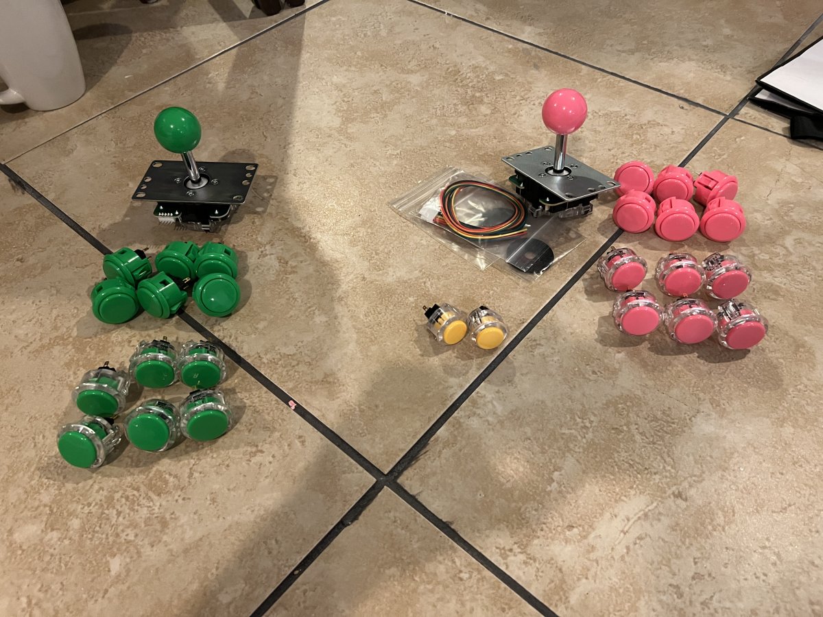

- Replace all the buttons and joysticks (already purchased and waiting)

Sanwa OBS 30mm Grn
Sanwa OBS 30mm Pink
Sanwa JLF-TP-8YT (2)
Sanwa OBSC 24mm Ylw
Sanwa OBSC 30mm Pnk
Sanwa OBSC 30mm Grn
$111https://arcadeshock.com
