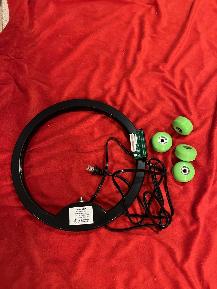

Got some stuff today:
- Degaussing coil: I figured I’ll need this at some point. Probably not often, but it doesn’t hurt to have one laying around. Mine took a hit during shipping, it sounds like. There’s definitely something plastic rolling around as I handle it; but, it worked on a CRT we have here! ¯\_(ツ)_/¯
- Skateboard wheels. I’m glad I got two Astros. Now I have a use for all four 😀

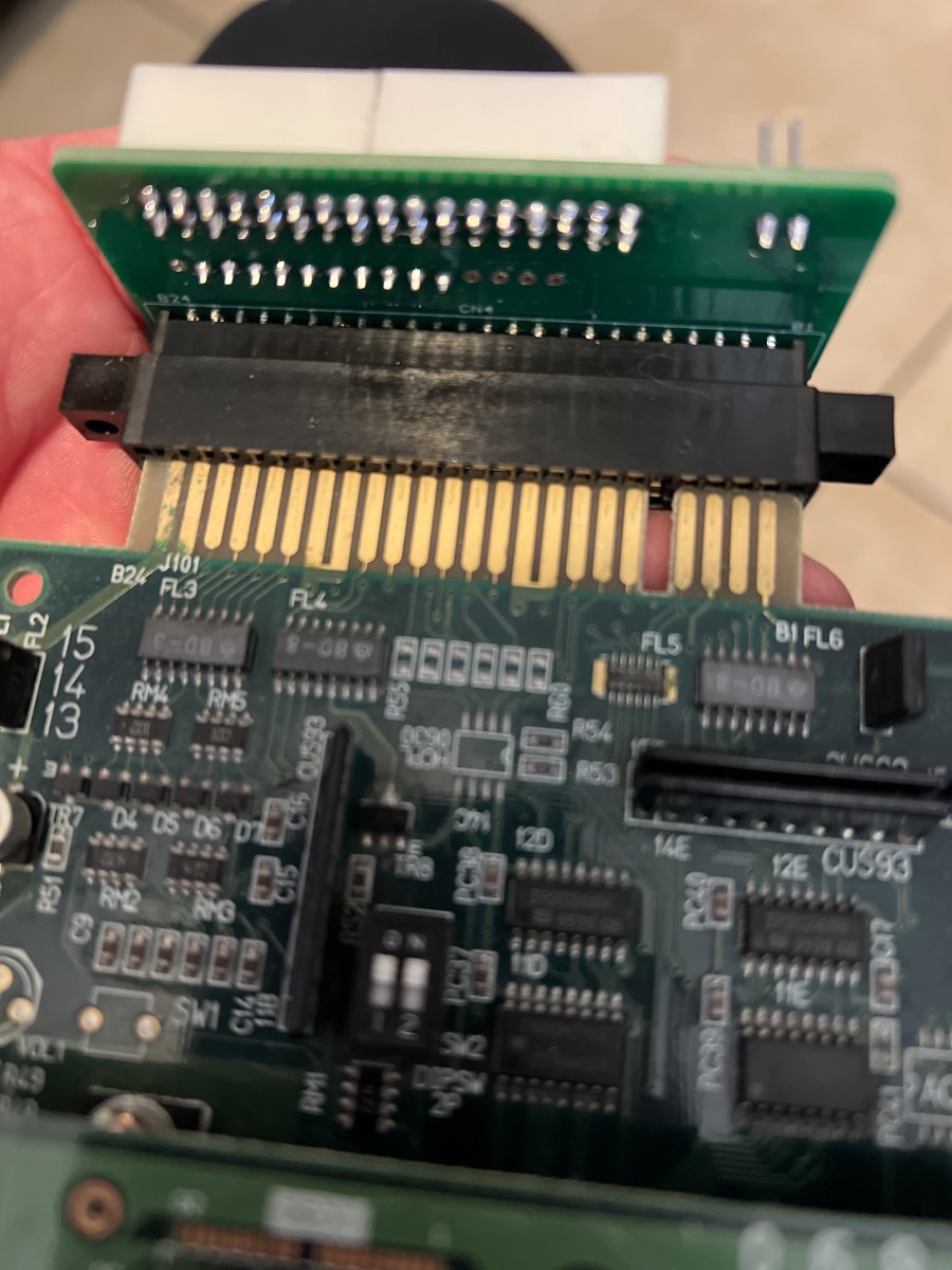

- JNX CPS1-2/3 to Namco 11 kick-harness adapter. It unfortunately doesn’t fit on my Namco 11 board, but I think maybe shaving a bit off of the PCB will work. I’ll see.
Edit: shaving the board a bit worked just fine. I finally have all buttons for Tekken 2, ha.

Just wondering, why the degauss coil? Does the one integrated into your monitor not work? I’d just fix the PTC on the chassis instead of do it externally. No arcade monitor is designed to require an external coil.

Just to have one in the tool set. I’m sure the internal will work just fine; but I figured if I’m buying arcades, I’ll be buying / working with other CRTs and cabs down the road.

Ok, that makes sense. Just wanted to make sure another person wasn't buying one because "the cab requires it!" - something I've heard a lot of times, when I think it's really just that the monitor was broken!

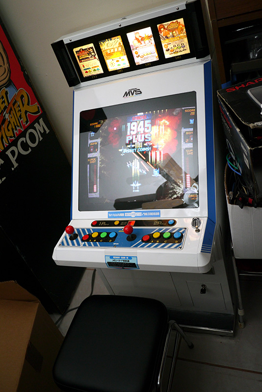

Great post! I bought a U4-25 from Yaton a couple years ago and it's been mostly fine, though not a fan of how he repaints things and puts crappy repro decals on, not sure if this is how your Astro will be. Also the original Fluorescent bulb may be replaced by some LED rig that looks... not great. I may be one of those chargebacks he's complaining about, though not for the cab. I bought what was claimed and photographed as a genuine U4-25 control panel (cab came with one of his dark blue repros) and received another repro, this one with just a badly printed textured sticker of the panel art. I asked to return it because it wasn't the claimed/photo'd original panel and he blocked me with no response. I had to then explain the situation to ebay to get refunded. Sad because we had a good rapport during the cab purchase and I had no complaints. EDIT: Just found Yaton's welcome thread, and apparently "arcadefunny66" is not him, so don't want to misplace blame for the panel situation.
When he says "no burn" he means it, which is good. The cab may be set up for Chinese 220V, with the applicable stepdown hacked in so be sure to remove that. Check the monitor connections carefully, and check for bad soldering on the chassis. I had some monitor issues that were cleared up by a simple reflow and re-seating connections. Levers may be horrible zippys and buttons will be "whatever". The faston connectors in my panel were like, crimped onto the tab contacts with pliers or something, I had to pretty much build an entire new control harness.
Here it is after finally finding a genuine panel, the correct Omron buttons and LS-32s, some marquees I had around, and some repro decals:
EDIT: Also want to mention how painless the shipping was, right to my door, tracked containership. This was 2019 so it was also pretty cheap, though it may not be now.
