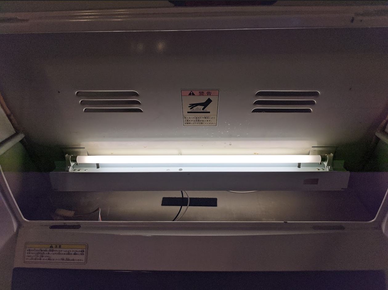

I've mostly been waiting for parts to arrive, but over the weekend I did get the fluorescent fixture mounted and working again. Who knows how long it has been since this thing has lighted up. I'm guessing it still had the original tube.
Using the FG-1E starter and a new bulb I was able to get light! I did some searching and saw most people recommended an Philips tube. I ended up getting a Philips 24" F15T8 tube from Home Depot. Comparing the diameter with the original bulb, it isn't quite as thick, but my local Home Depot was all out of the 24" F15T12 tubes. That would be the one to get if you wanted an almost exact match though. I'm okay with the diameter being slightly smaller. I was really stoked to be able to get the original fixture working though as I really wanted to keep as much original as possible. I might buy a few extra FG-1E starters at some point in case I ever need to replace it again.

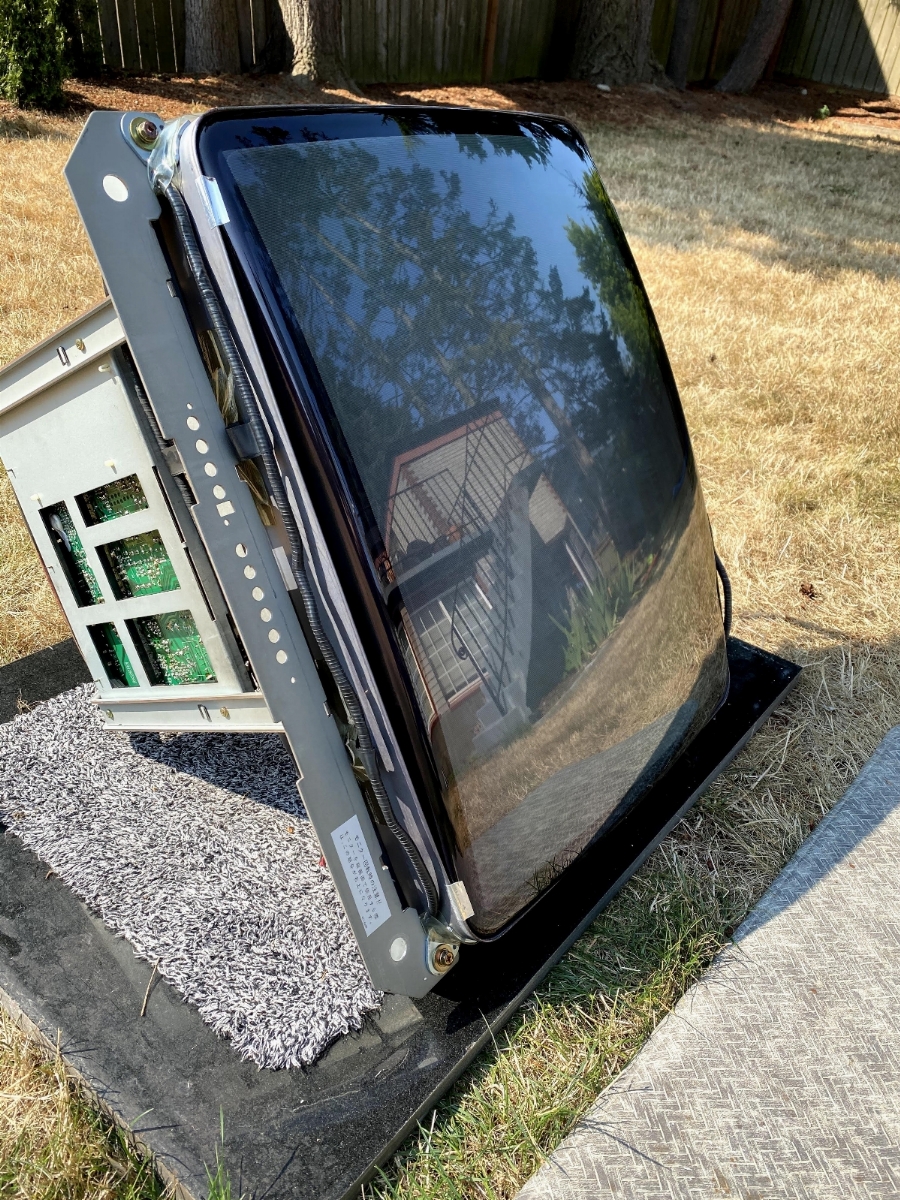

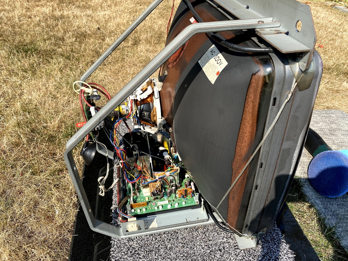

Yesterday got up to close to 80F in Seattle which was perfect temperature for drying a monitor. I decided to pull an old spare piece of countertop into the yard and put the monitor on top for cleaning.
I only realized after cleaning it that I didn't get but a single picture while it was dirty. It definitely wasn't as filthy as some other peoples monitors I've seen posted before, but none the less it cleaned up very nicely.
As is pretty standard practice when cleaning these monitors, I sprayed it down with Simple Green making sure to get it in all the nooks and crannies. Leaving the Simple Green on too long before rinsing can start to break down the Aquadog coating so I rinsed it off after only about a minute. Still, the cleaning affects were pretty drastic. It blasted through 25 years of dirt and grime like nothing. I'm pretty sure my neighbor thought I was just destroying old electronics.
The monitor now looks sparkling and beautiful. I didn't take any photos of the next step, but I pulled out an air compressor and blew out as much moisture from the PCB as I could without being overly aggressive. Since it was a hot end-of-summer day, the monitor was drying really well in the sun. Every so often I would rotate the monitor on one of the sides in order to get any remaining water out of the little pockets.
Next, I polished the monitor screen. There were loads of scratches but most of them were pretty shallow. I used the same 3m Rubbing Compound I used before mixing 50/50 with an abrasive hand cleaner which turned out to be really effective. I saw in an automotive thread somewhere that combining the two was really good at getting scratches out of windshields so decided to give it a try.

I wanted to thank you for posting the information you have gathered regarding the fluorescent light. I've had a Blast that didn't come with a light fixture in it and have been trying to think of a solution for years.
I was even desperate enough to try ordering a parts back end with fixture from china but it got lost in shipping or something so I gave up.
Reading this thread gave me the info I needed and now I have a working light!!!
Thank you!!
