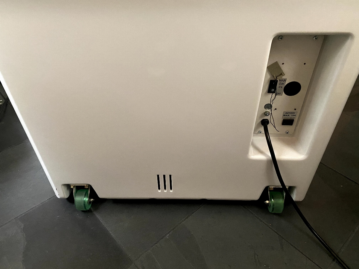

Thought I would throw in a quick update here. I managed to get the correct cable strain for the power supply panel and install that although the lighting wasn't good to capture any photos of this so far. Here is a link to an old Amazon page where it is no longer available for purchase, but will give an idea of what to look for if anyone else needs to replace this thing. In all honesty, I think a better approach would have been to just replace the strain relief with on of those 3 prong plugs similar to what the Blast City has so I could plug/unplug in any cable I wanted. But, what I have now will work fine.
The dimensions for the Astro City cable strain/relief (for the US located people) are as follows: 35/64" x 5/8" hole, 11/32" cord diameter

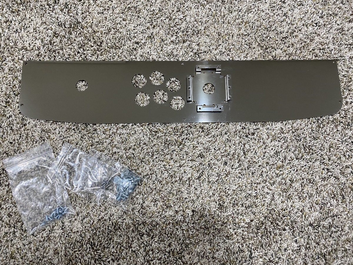

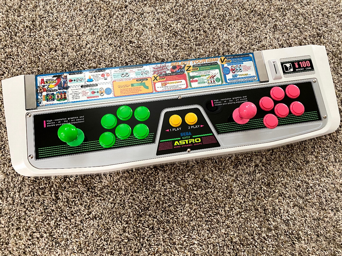

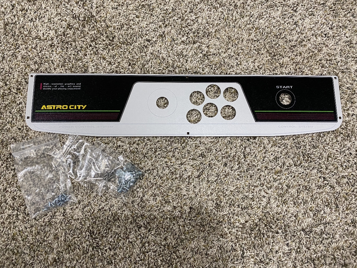

Secondly, I had some issues with the panel I bought (see this discussion) and ended up getting two panels from @alberto1225. He had previously sent me with no charge some control panel bolts & nuts that I had not yet been able to find which was very kind. I got two panels because I ultimately want this to be a two player setup but considering I'm the one that will be playing 99% of the time by myself I also wanted a 1 player panel so I could take full advantage of being centered. Well, the panels arrived within only about 4 days from Taiwan and they look amazing. Alberto was also really nice and helped me by sending some control panel screws that I had lost somehow during the restoration process.
The quality of these panels is unrivaled. Given the issues I had with the other panel, I decided to just get traditional colored screw in buttons to go in these panels. In other news, the Sega locks I bought from China (5 Sega 5380 locks) arrived looking great but without a key. This was an oversight of mine, but unfortunate since I can't really use them without a key. I've now obtained quite the collection of locks but I want 5 of the same type for the Astro City and 4 of the same type for the Blast City. At some point I will have to sell off some of these locks, but for right now, I decided to just go ahead and buy a set of 5 Sega 5575 locks that actually had a set of keys included. This means when I eventually get around to restoring the blast city I'll have the same locks used on both arcades. I currently had 4 Sega 5575 locks sitting around, I lubricated and installed them in the Astro City just leaving one of the control panel lock slots empty for now. Lubricating with this Teflon lock lubricant worked wonders.

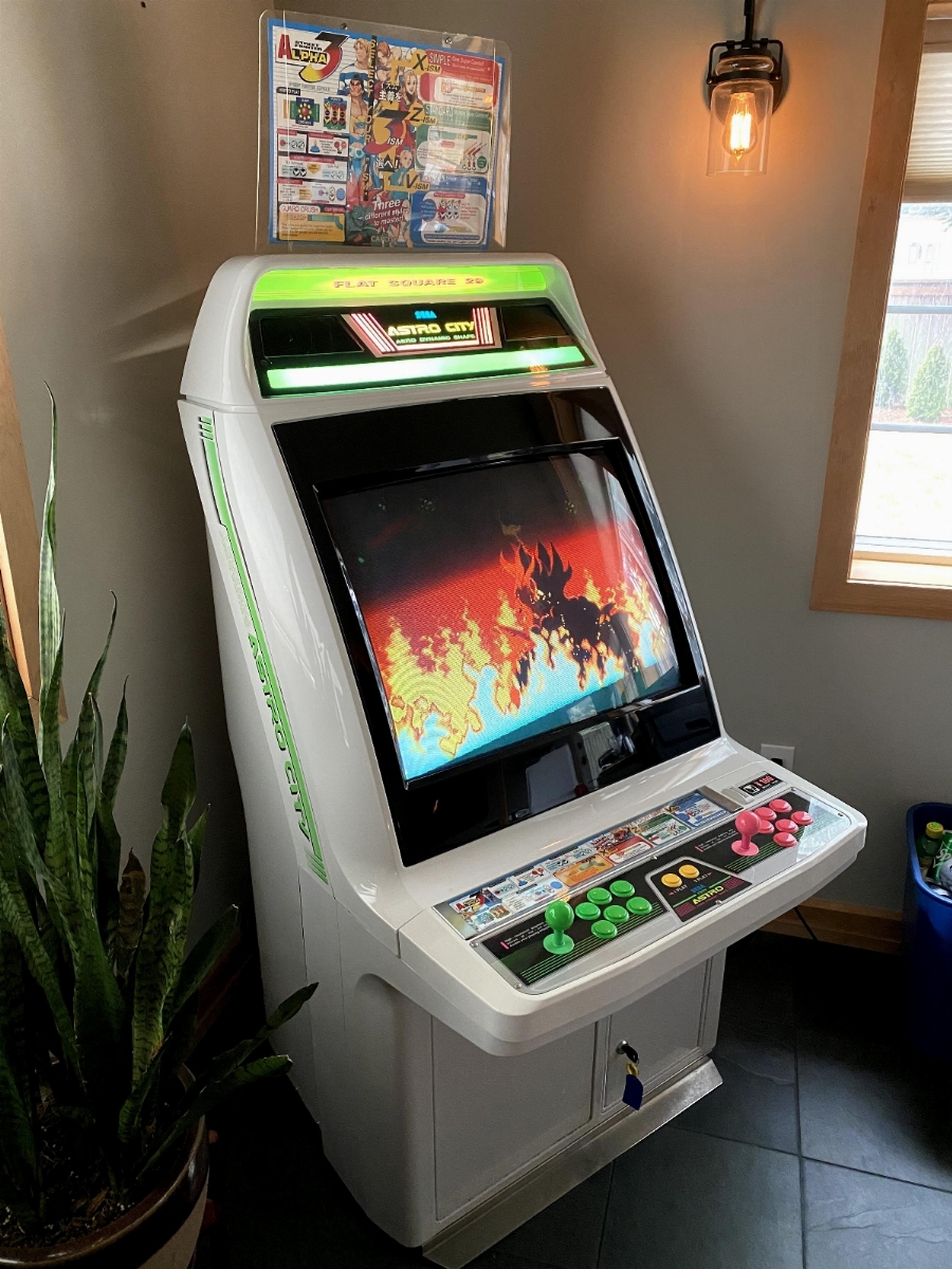

Superb work! The arcade looks brand new now...which is hard to achieve without a repaint.
Love the outcome!
Thank you! It's now actually sold. I sold it not long ago in August to a community member on the forum who now uses it along with another Astro City to run weekly 3rd Strike tournaments. Couldn't make me happier. :)
