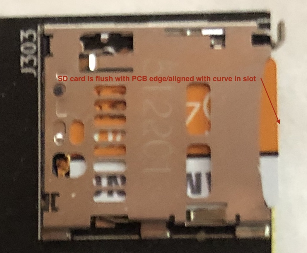

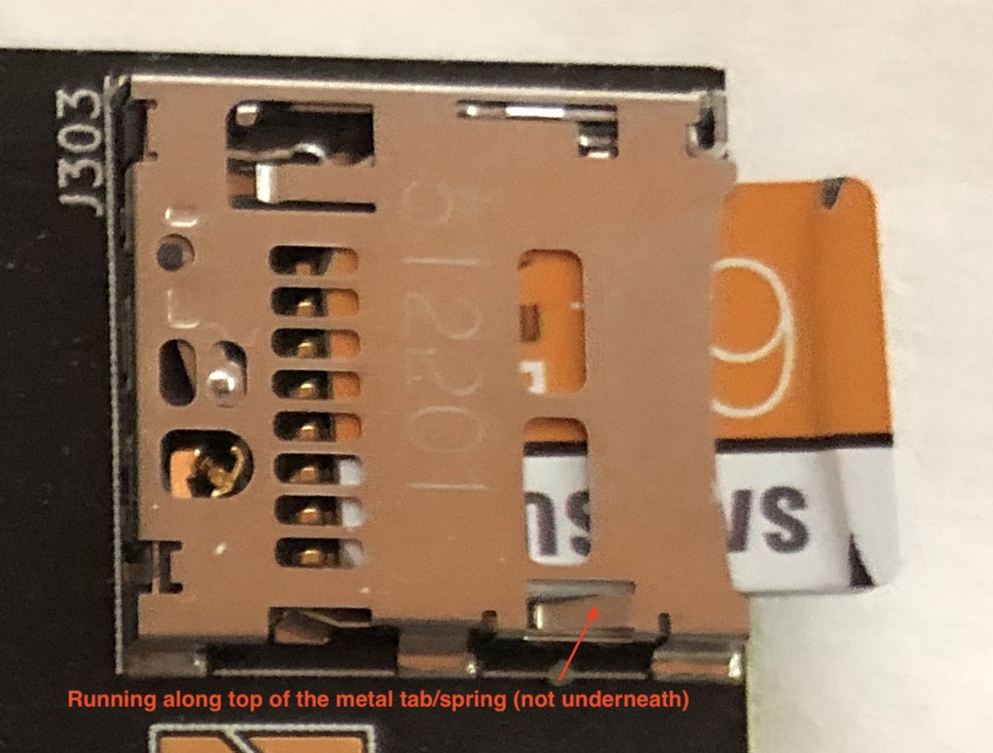

I'm hopeful everyone will be able to use the SD slot fine, but it does take a little bit of jiggling the card around. Here's what I do that works 90% of the time:
1) hold the board vertical, so gravity will help pull the SD card down
2) as you insert it, ensure it's running along the metal tab (not underneath it):
3) once it's in position, confirm it's still flush with the metal tab, but also the SD slot/PCB:
If it's not touching the metal tab while you insert it, or it doesn't seem totally flush with the PCB/SD slot curve, it seems to arrive in a position where it doesn't make good contact and the board can't access it. I generally follow the above guide and it usually works, though it's a bit of a pain that you need to be so precise.

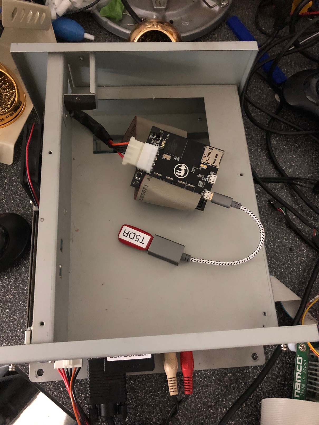

Got the usb OTG adapters in - works like an effin charm!
Again - I can't describe how happy I am about this... I have a dynamo cabinet at work in our breakroom that i drop different fighting games in every month or so. I have had Soul Calibur2 and 3 and Tekken4 for quite a while, but burned out a dvd-drive by not having it level. I juryrigged something awful in there to keep the dvd-rom straight, but this solution is so elegant - and I don't have to worry about finding a drive that will work with Tekken4 now (even though I have 4 of them now) :)
Thanks @electric_monk - this is amazing!
Matt
It's not elegant at all right now - I just have it sitting on the IDE cable - since it's a metal case - I don't want anything shorting out. I also didn't want to use doublesided tape or something for fear of picking a chip that needs some heat dissiplation.
I am hoping at some point someone will release some plans for a 3d printed case for it and I can just print one... but for now - it works.
The good news - there is *plenty* of space... :) I could even see maybe someone @hursit!! building a new case for the Namco 256/246 using this card - the enclosure could be a lot smaller than it is w/o space for the dvd....
