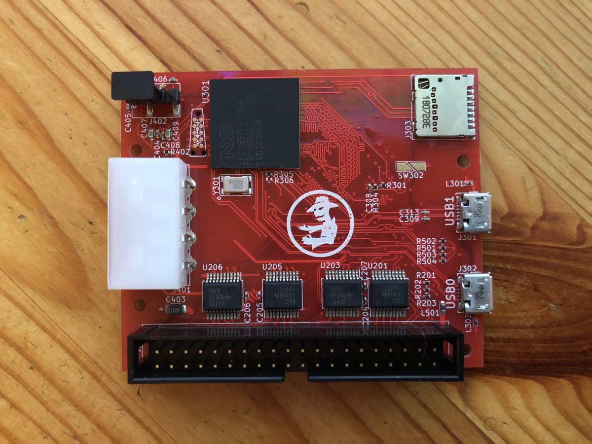

Actually, sounds cool. But will it be possible to connect LCD to the current revision of emulator? I mean, is it currently hardware compatible with such LCDs and it's only firmware what needs to be updated?
Yes, the hardware itself should be able to drive any USB2.0 device in host mode, though some will need external power (the Crystalfontz LCD I'm using to test is one such device, it's pretty power hungry. Thankfully, they seem to be aware of this and provide a separate power cable option).

I'm working on restocking early 2021, but the new board will need a new firmware due to a couple of circuit tweaks so I'm polishing that as well (also featuring screwholes and a better, non-fiddly card slot).
With regards to multiple ISOs, it'll currently just use the first one it finds. You can use the command line interface available on the simulated serial port over USB to select different ones, though I've been woking on adding support for plugging in a Crystalfontz LCD/buttons module to add a menu system, and also to be able to change disk images via the IDE interface (which I've also been working on a DOS app for).
The Crystalfontz I'm working with is model CFA633, though I will say I haven't finished the painful bit yet - instead of a standard USB serial interface, it has an FTDI chip which requires special non-standard drivers that aren't provided with the microcontroller's USB stack like the standard ones are, meaning I need to make my own! Once I've finished off with that it should be pretty simple to actually implement the menu, though. Any of the colours should be fine so long as it's the USB model with some buttons. I should probably also make it work on the larger 20x4 displays, but that'll be later.
