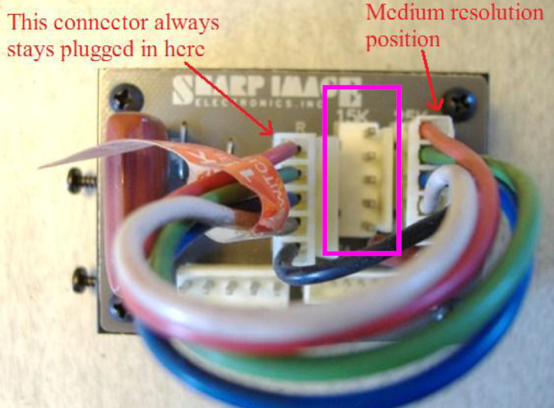

So I was finally able to open the back of the cabinet and I'm seeing the CRT listed as an RCA A68AEG25X01 monitor. I'm not seeing anything online for this monitor anywhere. I've tried connecting a PC to it but so far the best I've been able to get is a almost stable picture using a ultimarc board combine with the 4350 card.

So I looked up some more information on this chasis model and I'm seeing there an option to switch it to 25khz. Is there any benefit for this? I'm looking to setup an emulated version of Marvel Vs Capcom 2 for now on it. Eventually planning to get the Naomi hardware.

I decided to open the back up (had to break the lock) because after trying Windows 10 with crt_emudriver I just could not get a stable picture. Figured it was better to go find the monitor/chasis info first.

All I can see is, Sharp Image SI-72R DS
You are in luck. The masamune of US domestic monitors, Ken Layton, wrote that manual for that monitor. It is a dual resolution monitor. 15khz is displayed if the jumper is set in the 15khz potion as shown below, so make sure it is setup correctly. Also, you bought the 4350 series Radeon. Those cards require split second cable switching once you enable EDID in CRT Emu. Better to just get a Radeon HD5000 series or higher. So to get a stable MAME image:
  1. Make sure you have the 15khz jumper set correctly, then
  2. Follow the CRT Emu guide perfectly for your series card
    • Though I would recommend getting the HD5000 card to make life easier
    • You end up looking at lots of black screens with HD4000 and lower cards
      • (That is a pro-tip for ya; trust me on that one)
So would you recommend the 15k setting instead of the 25k setting? Happy to know I may have a pretty good monitor as I was starting to feel I got had a crappy one :(
