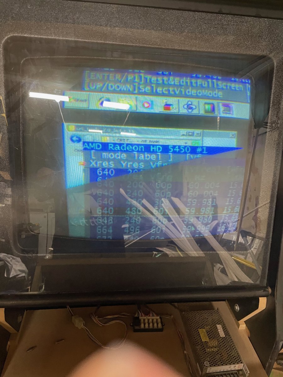

Ok so I made some progress! I got the image to stablize finally but the screen is off center like the entire side of the screen on the left is black and the right side is cut off if that makes sense?
Are you saying it's so far over to the right that you can't center it using the H pos and / or H hold pots?
What happens if you try and center it? (I.e. how much of a gap is left if you max out the available adjustment on the H pos pot?).
It's not unusual for the image to be shifted a little to one side with some sources. I always had that issue when using my Neo Geo via rgb on a CRT TV. It's unusual for it to be shifted so far that it can't be centered though.
Have you confirmed that you've definitely achieved a 15khz output from the PC?
So I tried the Windows 7 GroovyMame setup and I'm getting the exact same symptoms as I was on the Windows 10 setup I was attempting. Here's an actual photo this time:
These adjustment knobs are so darn sensitive too. I suppose I should read up on each one does instead of just randomly turning them until I get what I think is the right adjustment.
So your image is just scrolling through vertically?
Do you have a VHOLD pot you can turn to stabilise the image? Once the image is stabilised, you'll probably need to adjust your width and position of the screen too.
Yeah scrolling vertically and I can't seem to get the width and position to move much. I'll work on stabilizing first.
