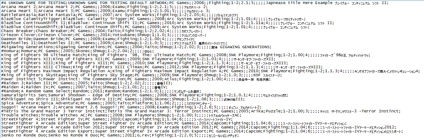

you can edit the romlist and add them / uncomment them out by going to
nesicaxlive/am/romlist/pcgames.txt
#Raiden 3;Raiden III;PC Games;;2005;Taito;Shmup;1-2;2.02;2;;;;;雷電III;
#Raiden 4;Raiden IV;PC Games;;2007;Taito;Shmup;1-2;1.01;2;;;;;雷電IV;
Remove the # and Save

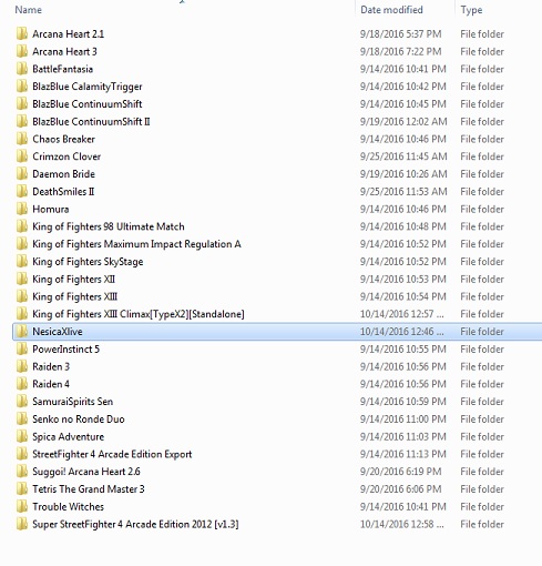

I added the updates, but Im worried that the new SSFIV and KOF13 names are off. Do I need to change anything in the rom list naming?

The folder name should be the games name. ie remove the {1.3} {TypeX} {Standalone}
Ok thanks. I had did that after looking more at it and changed 2.1 and 2.6 in Arcana to just 2 and 2. Ill try it out soon. Thanks.
i wouldn't recommend chaning the romlist, because i do not own nor know how coery as set this up to load on a real ttx. as long as the game folder matchs the one to the left it should load however
